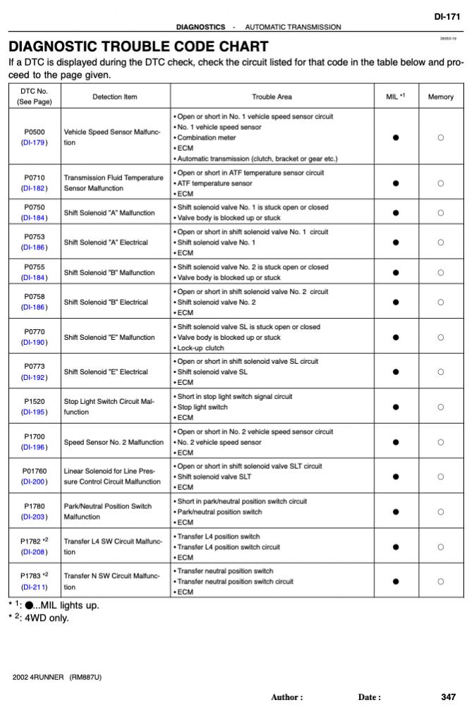

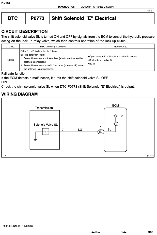

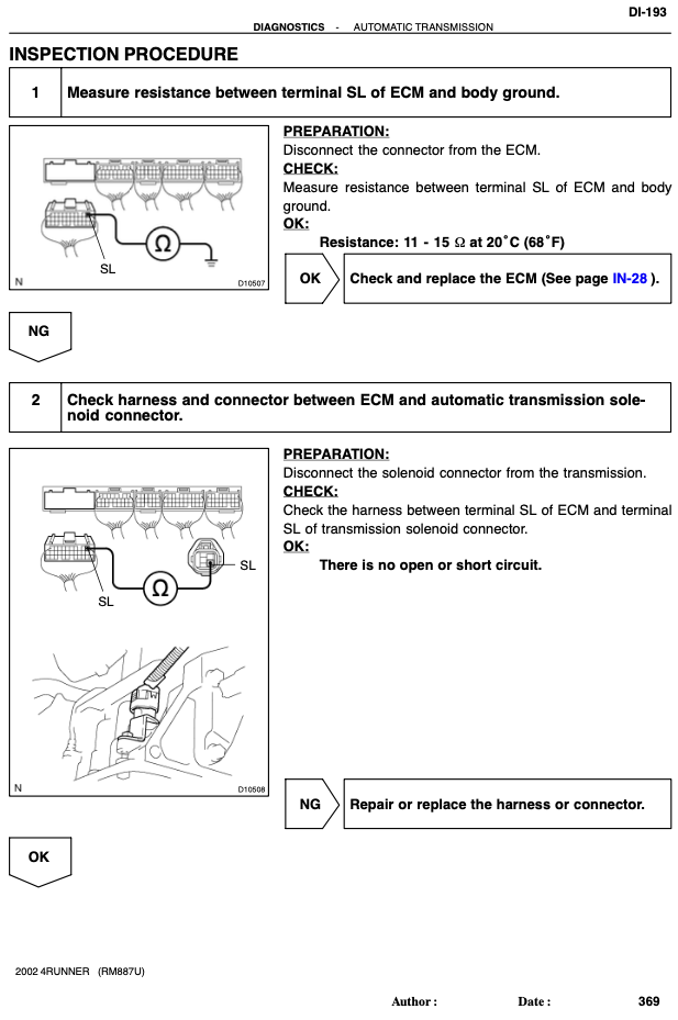

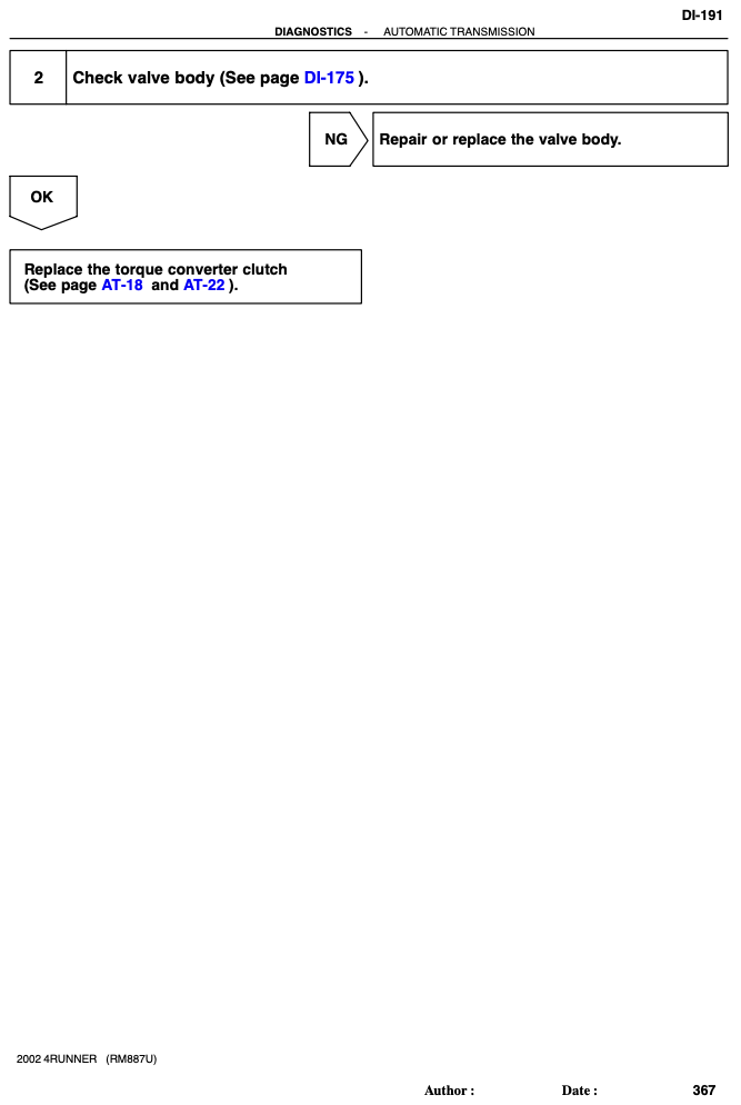

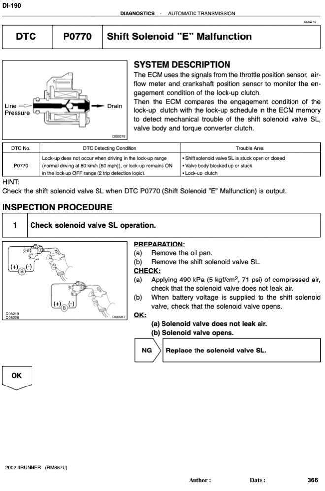

According to service manual:
P0770 - Malfunction (mechanical)
-Shift solenoid valve SL is stuck open or closed
-Valve body is blocked up or stuck
-Lock-up clutch
The code is mechanical, but I would still try to simplest thing first. Start by cleaning the solenoid connection (male and female) on the transmission located at the rear driver side. If no luck, ensure continuity between the two connections on the solenoid harness. If still no luck, test the applicable resistance on the ECM (I doubt the ECM is the issue based on the smooth-shifting). The next step--which honestly should be the first step, but who wants to drop the pan on a brand new transmission--would be to remove and test solenoid SL, located by itself towards the front. Hopefully, all you have to do is replace the solenoid.
-Lock-up clutch
