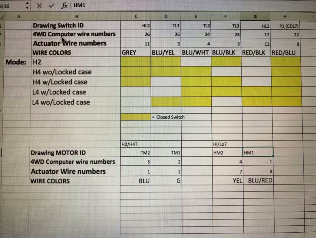

There are 6 switches in the actuator. I can send you information about which switches should be closed or opened in any given mode. Let me know.
I think you should start with unplugging the 12 wire connector, clean the contacts good, reconnect, and then visually inspect for other wiring damage. Inspect the a actuator itself for physical damage. Interesting that the problem showed up after you were on some rough terrain.
It would be useful info for many here if you just posted the information on the forum.
I will try to upload an image of my spreadsheet...
The actuator and wiring didn't have any damage, as that was one thing I did check as i slammed down on some rocks. The RCI skids did a good job there. I didn't unplug the 12 wire connector, but I will give that a try, and thank you for the suggestion and for the diagram!
