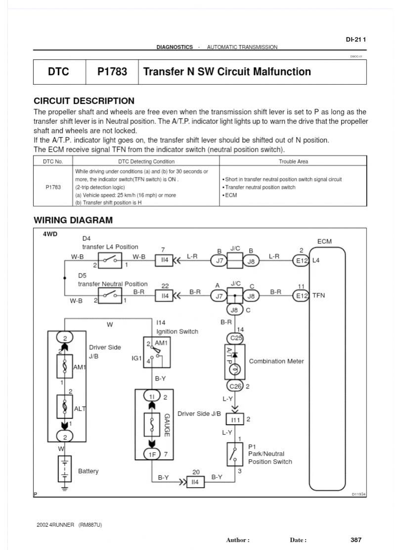

Fsm pages indicate transfer neutral switch malfunction. attached pages might help.
