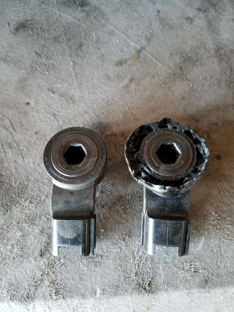

Some dipshit previous owner put stop leak in it. Then I believe it clogged the radiator. However, when it backed up it didn't blow one of the large radiator hoses causing enormous amounts of steam to come out. No, it blew the small hose going to the overflow tank and when driving at highway speed I never even knew that coolant was coming out. The temp sensor never budged as many techs have told me that the steam alone can keep it within temp. Odd, but OK. But with no coolant, we all know what happens. Well, bank 2 got so hot it melted my knock sensor and the intake manifold. Lesson learned, pull over AS SOON as CEL light comes on and don't assume it's just some minor hose or sensor going bonkers. The CEL was for low coolant, but figured it was something else since the engine temp never budged (see steam reasoning above). These motors are bulletproof so don't let my misfortune sway you. I haven't taken the blown engine apart yet to see how bad it really is but when I do I'll be taking lots of pics to share. Pics are the melted sensor and some of the coolant that came out of the radiator. Bigger chunks came out when I flushed it. Good news is...now have a 112k motor with all new timing belt, water pump, AC Comp (was going out), headers, 02's, seals, spark plugs, radiator, hoses, bigger trans cooler, etc. She's ready to go for at least 300k. Need to flush the tranny tho just in case said "dipshit" above didn't use some crap fluid.

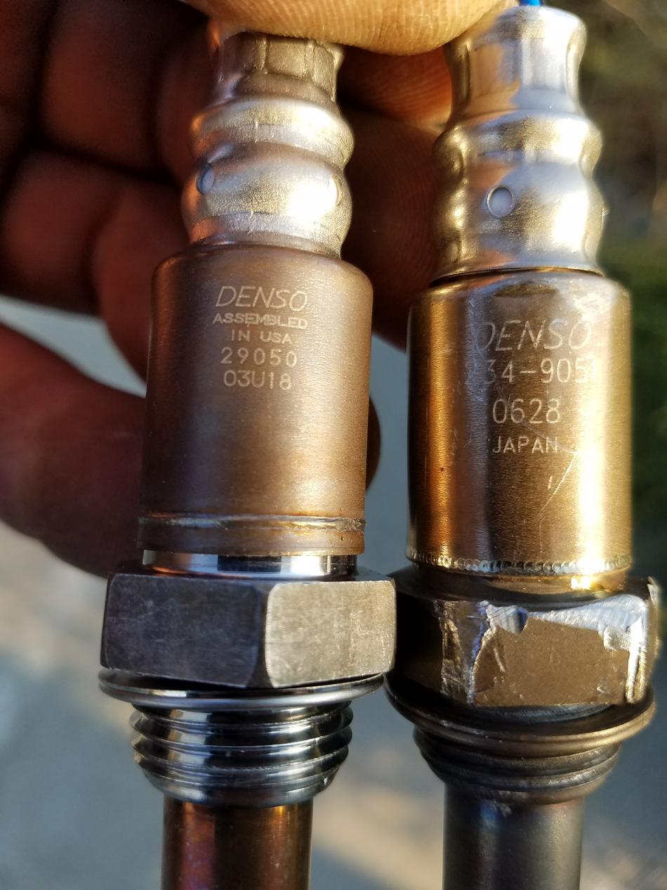

Well...update! Swapped out the Bank 2 Sensor 1 with a Denso 02 Sensor off Amazon and sure enough code went away!!!! Yay! So I was going back and forth on replacing the driver one as well since it is also a Fleabay 02 Sensor. This morning I'm driving and my car smells really rich. So I say F it and buy Torque Pro to run even more diagnostics. Pull the codes and what do I see? P0171 - Powertrain System too Lean (Bank 1) and P2195 - Powertrain 02 Sensor Signal Stuck Lean Bank 1 Sensor 1. F**kin A! Soooo, ordering another Amazon and requesting a refund on these. I will update on Sat once I get the other one in. In the meantime I'm going to attach some pictures and info so others that search won't get fooled.
Ebay Denso Sensor for 4th Gen 4Runner 234-9051 (do not use!)
As you can see, smaller box is Made in the USA (Amazon) and the other is Made in Thailand? But the box says Made in Japan! Which is it?!?! Also ON the sensor it is etched in "Assembled in USA" and the other just says "Japan". Plugs look somewhat identical except fort the blue tape. Also, USA box is smaller and opens at the end. The USA sensor also comes with a very small packet of copper color anti-seize. I hope my trying to save a couple of bucks helps other people in the future.
