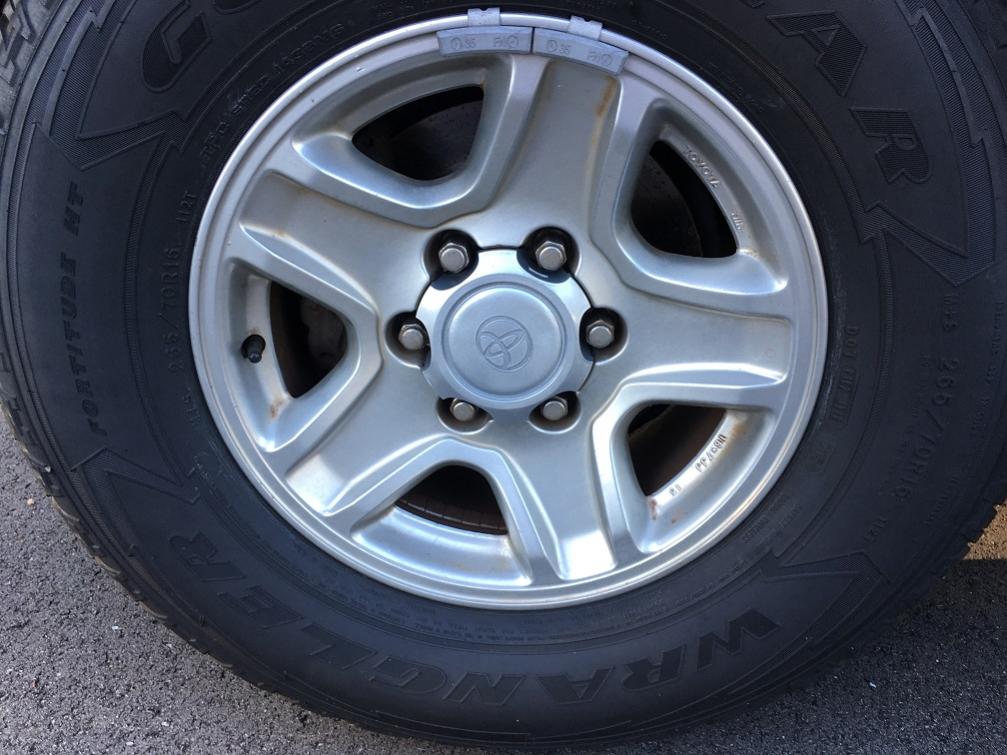

Just painted my centercaps and it did match pretty close. Probably even closer if I clean my wheels:

yep that looks good....but looks like you got some new meat on those wheels...or as others say....new shoes
think I need to figure out a way/tool to do the outlines etc in black..you know the indented lines and yota logo..paint the caps and hand to my grand daughter and say...make some black lines

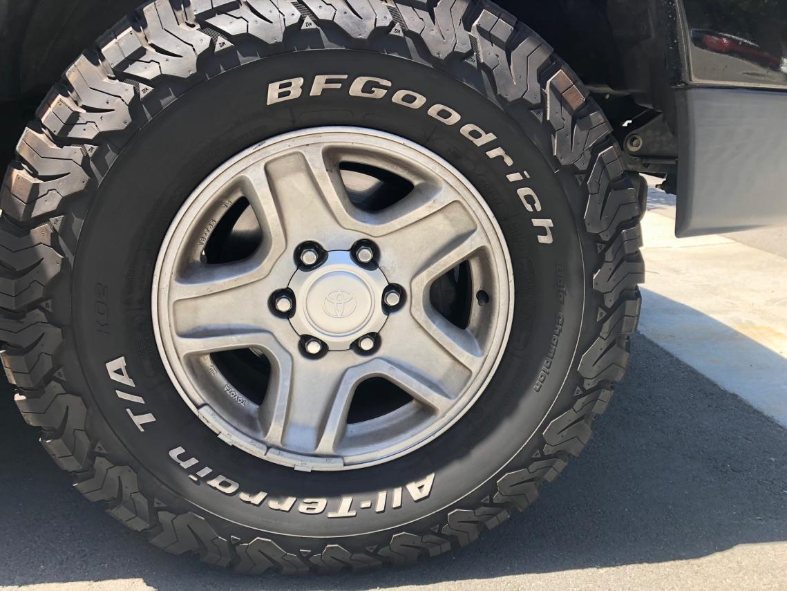

Yours matched better than mine or they modified the paint formula a little. I used the Duplicolor listed and grabbed a test cap from junkyard. Washed it with acetone, plastic primer and one coat of Duplicolor. Results - not quite as good a match as above
