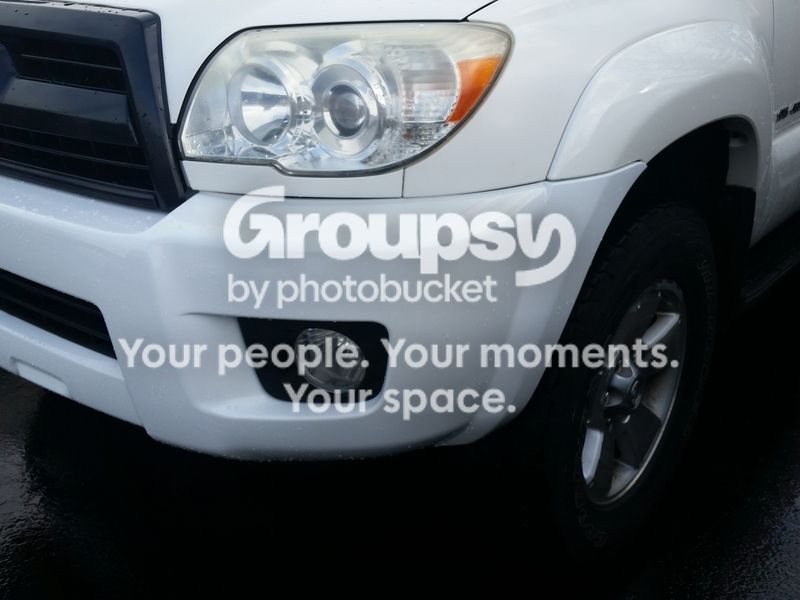

So I bought a new paint to order bumper off of eBay and what I got was significantly whiter than the rest of the body. Is this. A: A mistake on the paint shop. B. In need of a clear coat. C. In need if 9 years of uv damage. D. A coat of wax. Or E: something else?

Well, this was an ebay order from a place in Michigan so that would have been difficult. But I do think you are right. Here is a pic I took this morning. The bumper is noticeably whiter than the rest of the vehicle however, if you look at the trim piece under the headlight, it is the same color as the rest of the car. This is important to note because I just rattle canned it last night with a can of 056. the color code for this car and the color code I sent them.
ok so after sending that pic and an explanation to the seller they agreed that they didn't even come close on the mix. so they offered for me to get a quote to have it resprayed locally and they will pick up the bill. So far seems to be a fair company I am dealing with.
