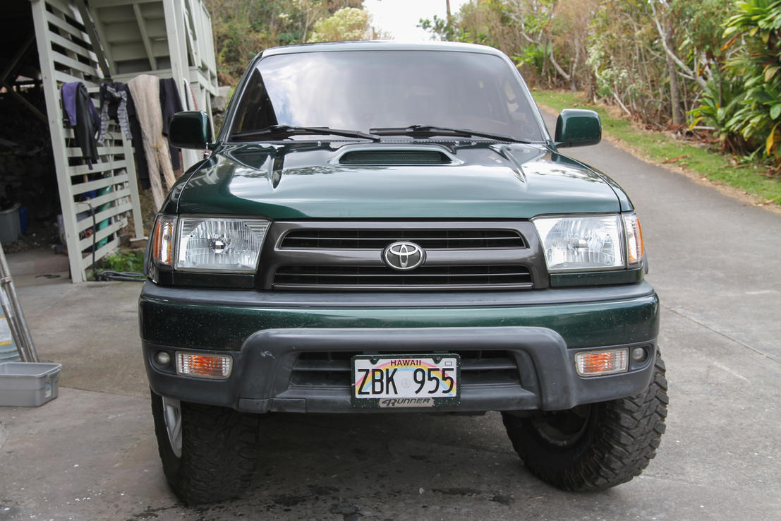

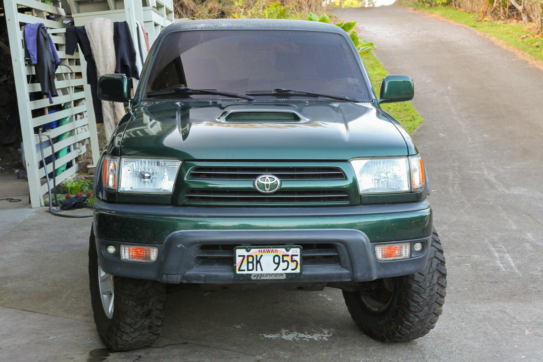

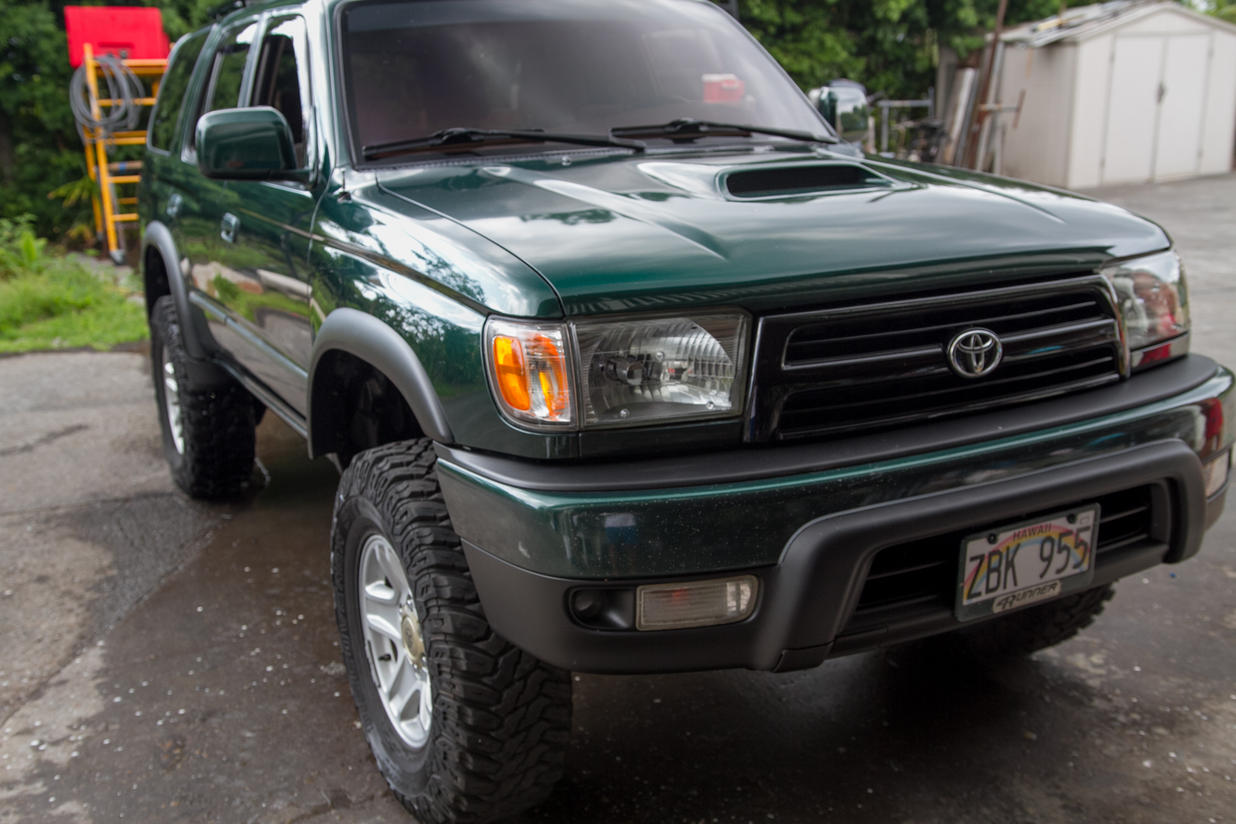

I have a 99 4runner Highlander edition - all of it is Imperial Jade Mica Green including the grill, which I love, but decided to switch things up a little.
I have seen so many flat black parts lately I kinda missed the gloss so thats what i went for - I just wanted anything near a black and I found some "Metallic black" so thats what i used
Heres what it originally looked like

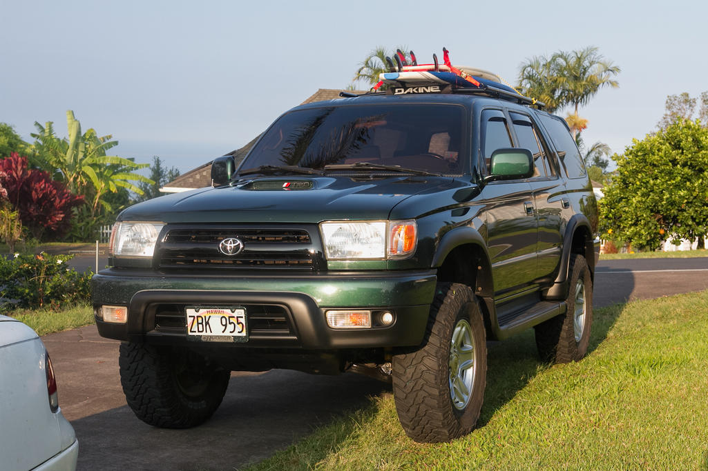

Heres the end result

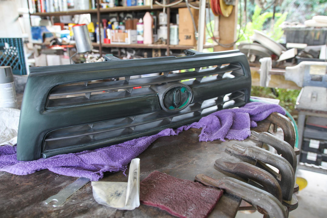

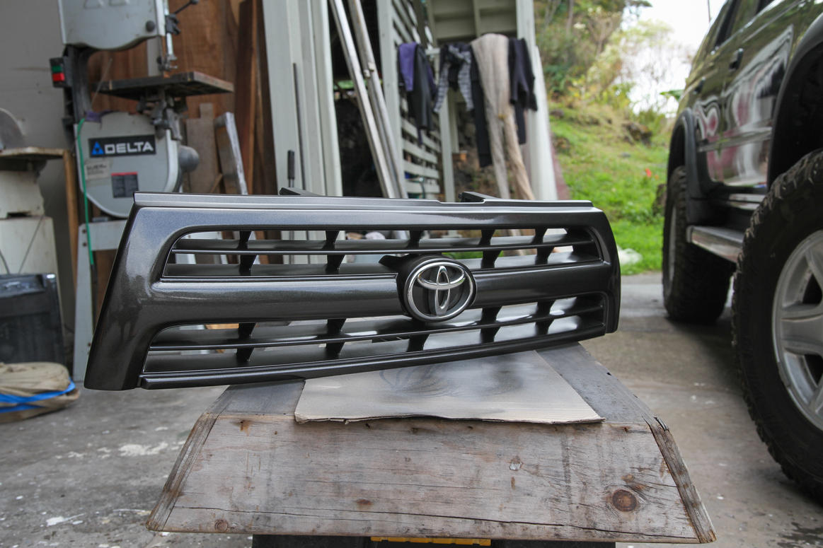

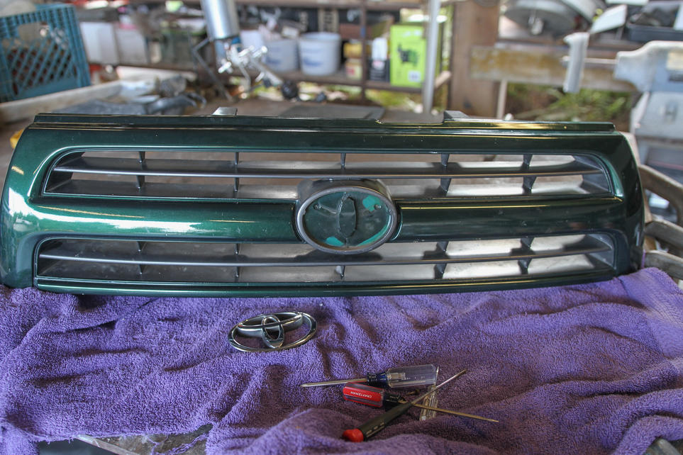

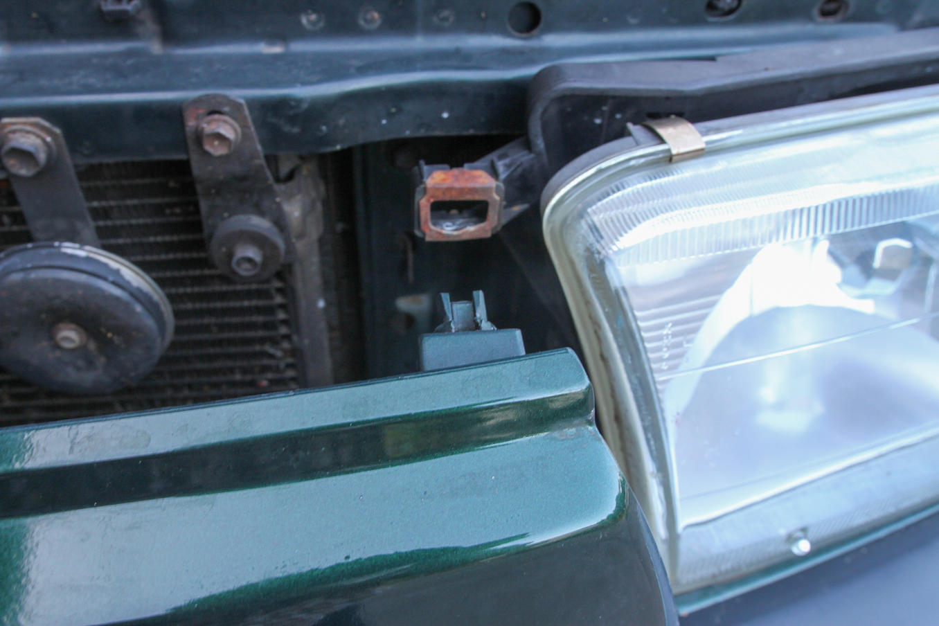

Started by braking a couple of the clips in the grill, but oh well zip ties actually worked better anyway
Emblem comes off with a couple screws in the back. Sanded it with 220 grit, then with a scouring pad for fine surface

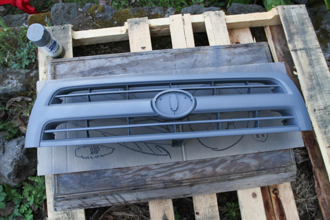

then added a couple layers of primer
Then a couple layers of the "black" and a coat of clear and there it is

Mind telling us what paint you used for the "Metallic Black" and clear? Spray Can? Love the look of the color!
Rustoleum "black night metallic" spray can. literally just found a full can in my garage. i used a krylon gloss clear also found in my garage but emptied the can and tossed it. Thanks man love it too!

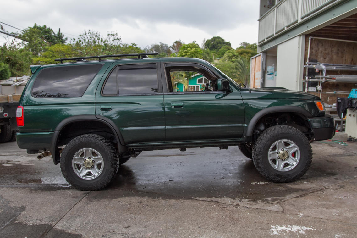

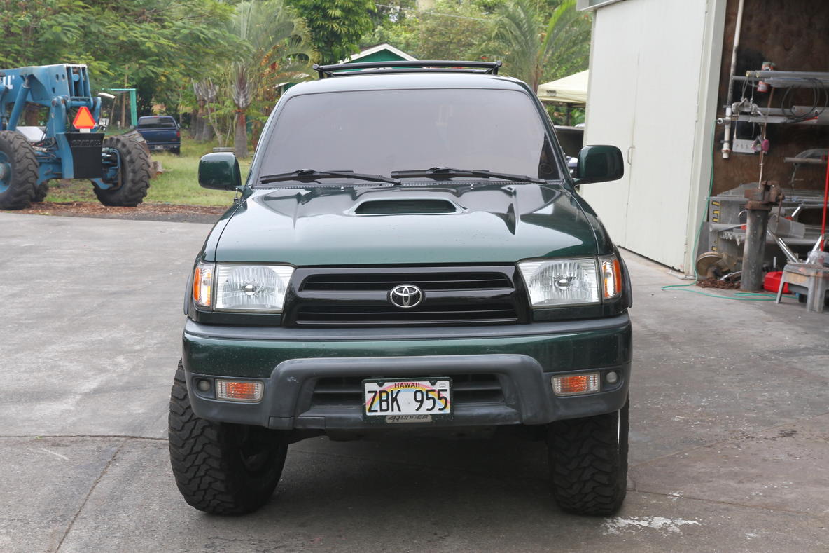

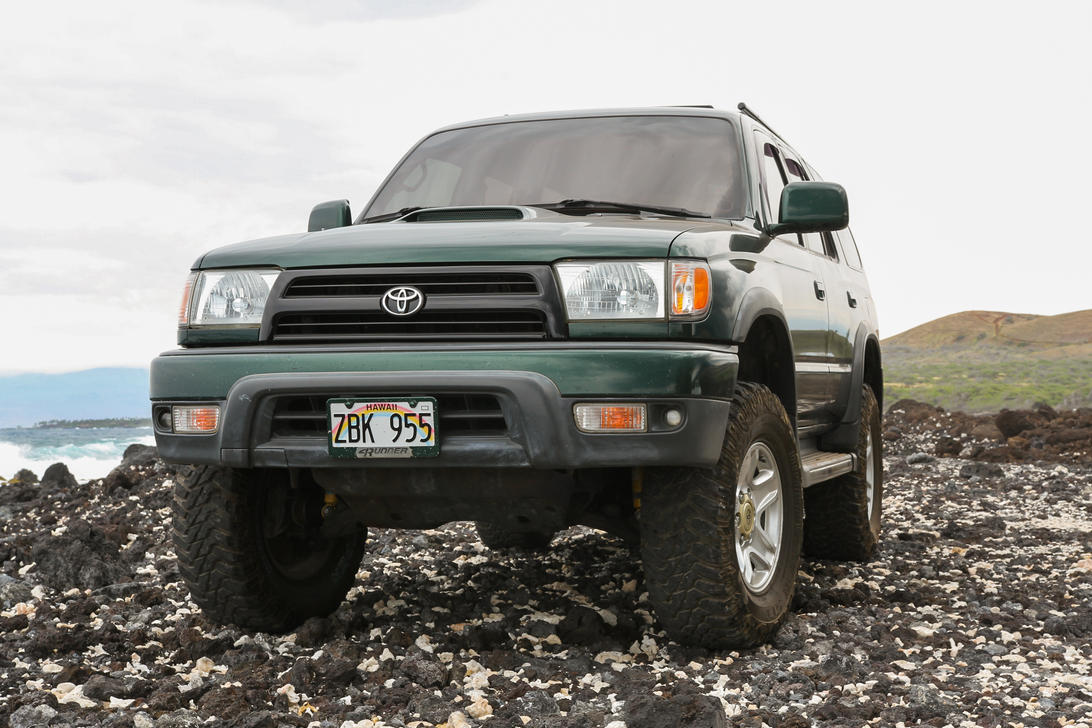

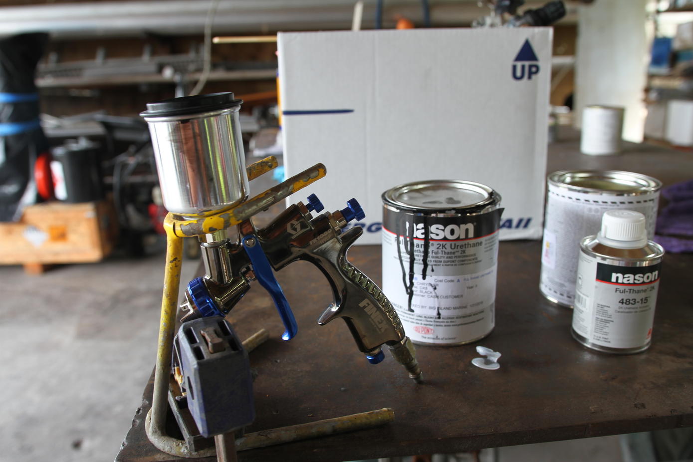

Update on the Black
After running that color a little bit it kinda seemed off to me, great color, but not much contrast
with the green, it seemed a little gunmetal grey-ish instead of a solid black. So i redid it with Nason Black
The black offers the contrast with the green that I was looking for so I am much more pleased
Original:
1st attempt (Metallic "Black"):
End Result:
