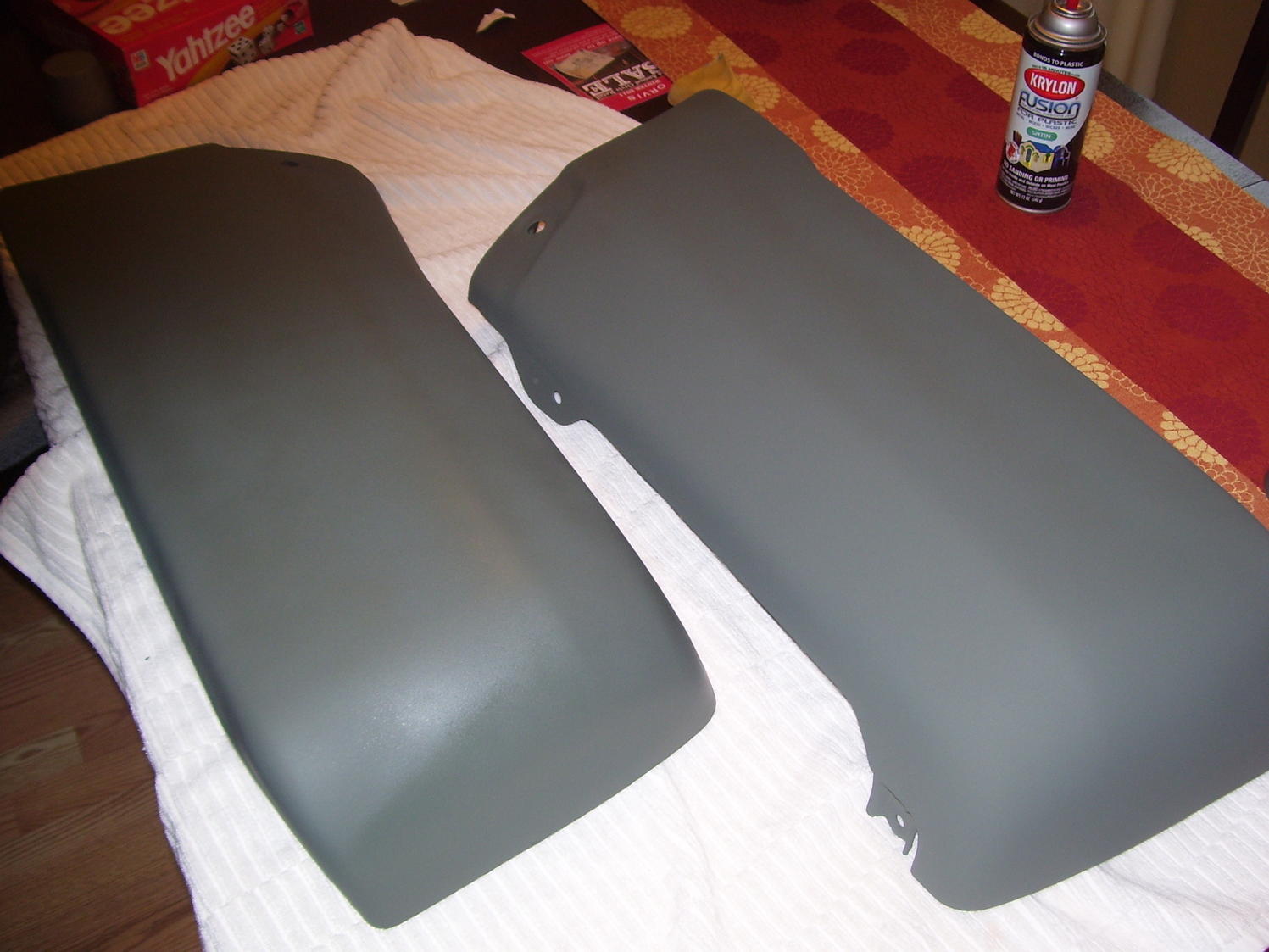

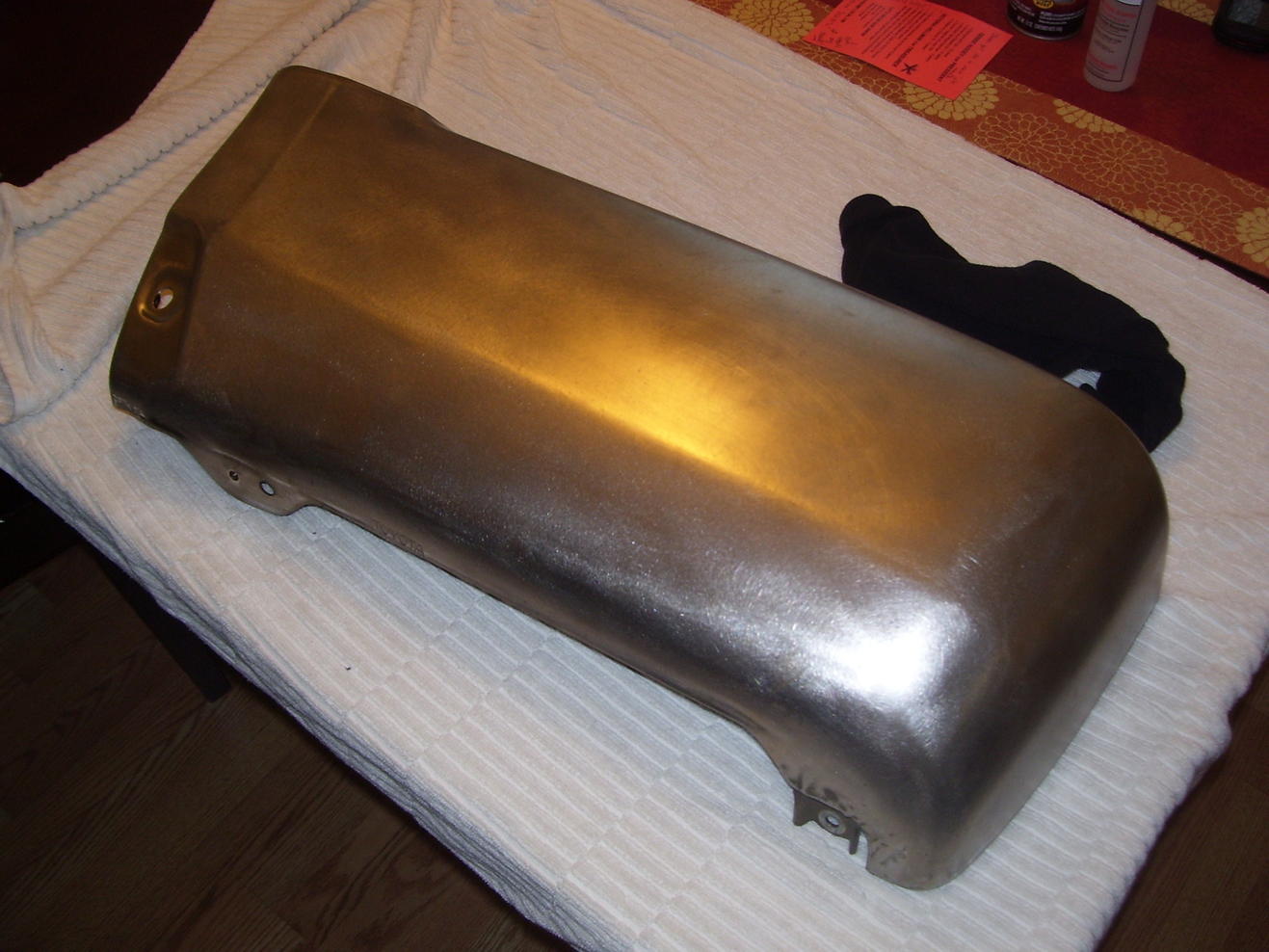

However mine was pretty involved. Removed rear bumper and used my DA to sand up the chrome.
- Started with 40 grit, than 80, than 120
- Wiped down with acetone (note, I didnt need the huge can in the automotive section, so off to the health and beauty area where I spend the majority of my time at the store :naughty: and picked up a $.99 bottle of acetone (used for removing fingernail polish). Just a little money saving tidbit.
- Sprayed adhesion promoter (3 coats)
- Sprayed self etching primer (5 coats)
- Wetsanded
- Sprayed Krylon satin black (5 coats) and let dry in the house for 3 days (wife was a little pissed)

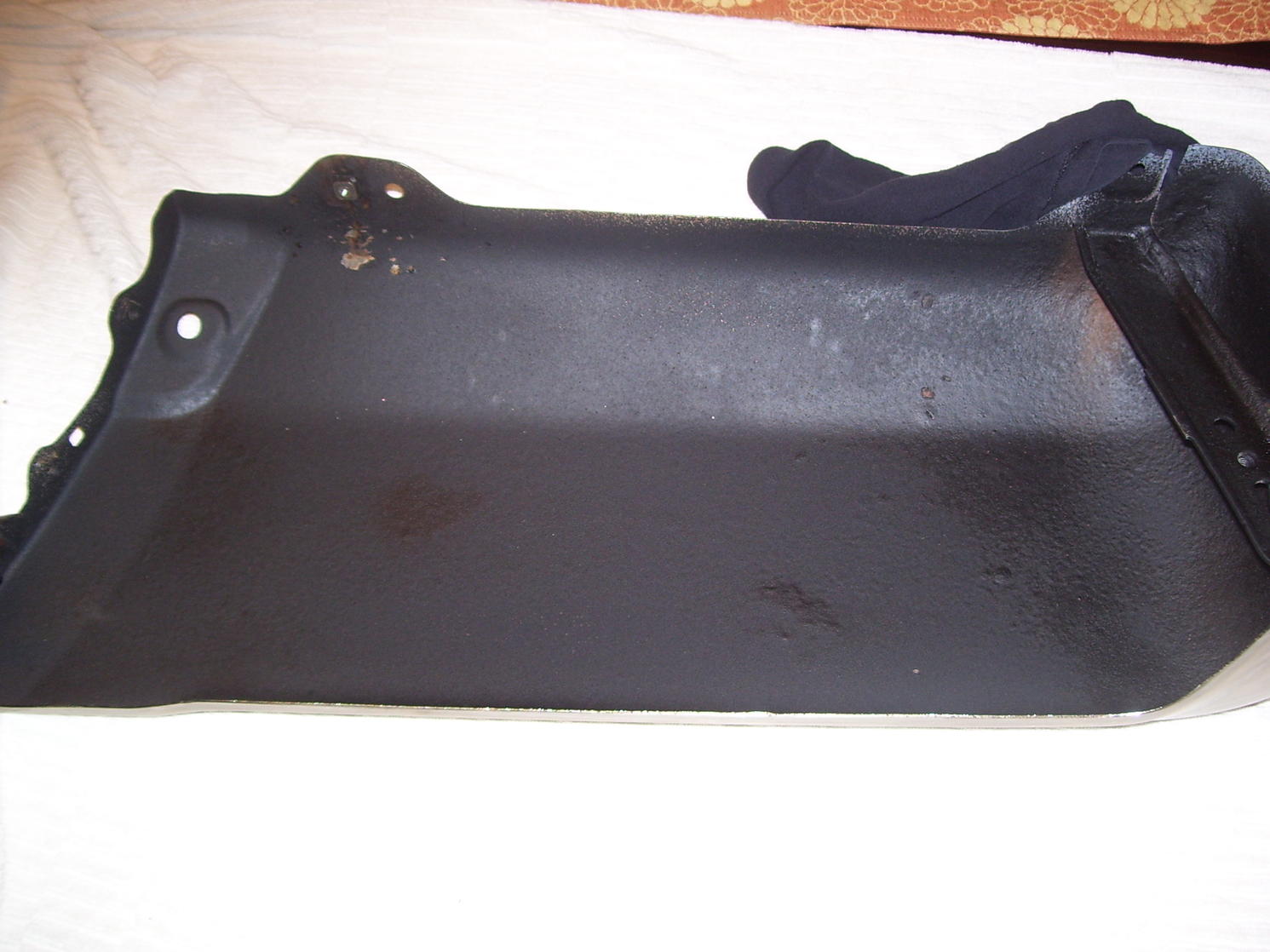

Also, for some reason my bumpers were rusty on the inside probably due to the crappy metal, so I sprayed some primer and undercoating that I had lying around.
For the grill I masked off the gray area, sanded with 80 grit and then 120. Wiped down and sprayed with Krylon Fusion. Let dry for 5 days.

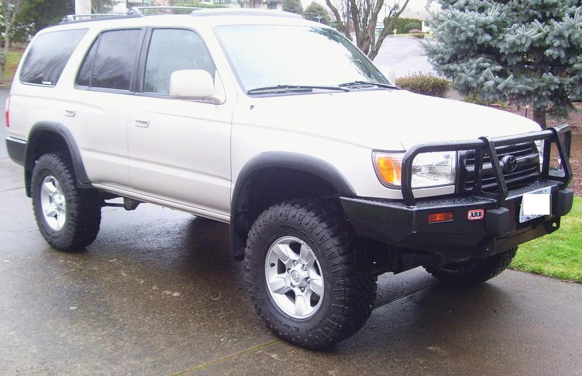

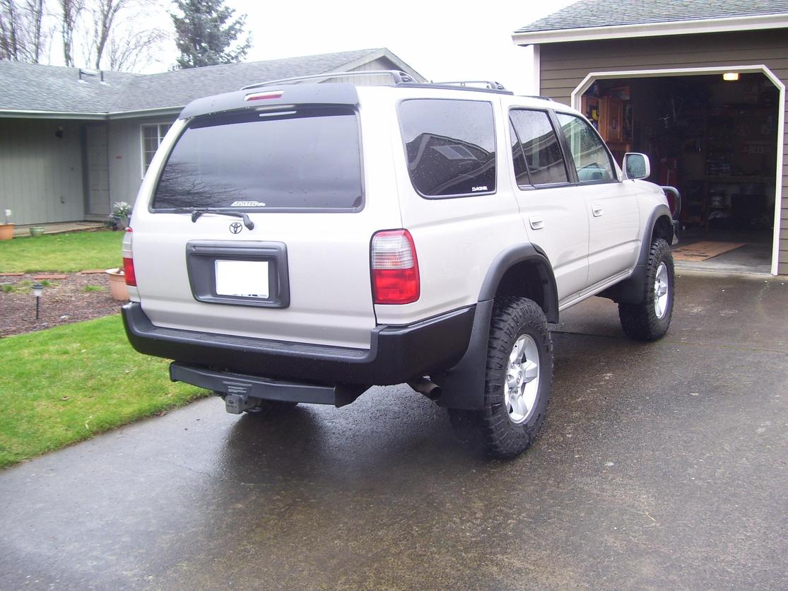

oh runrunner...great great job on the bumpers, idk if I could wait 3 days like you, but I guess patience is the key to achieving great results.
Look into painting the rear window deflector in white just like Ron Helmuth did his..gave it a nice subtle appearance, makes the top portion of your truck all white..just me.
That looks really nice man. Like the contrast.
Looks like you enjoyed some family fun in a rousing game of yahtzee while you were waiting for them to dry.
looks nice, good tip on the acetone.
Keep us updated on the rear bumper holds up over time.
Id like to paint mine but im affraid of the paint chipping off it easily .
