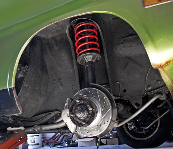

I'm just going to sand off the clear coat & use factory primer & paint. Unfortunately there are some rock chips down to the metal that are rusting. That's the whole reason for me me doing this in the first place before it spreads. Did you see that Eastwood makes a rubberized rust encapsulator undercoating? It's cool, I'll probably end up doing my wheel wells with it too.

I don’t know how I feel about rubberized undercoat. When I bought the truck I sprayed 3M rubberized undercoat in the back wheel wells. I don’t recall having a rust prior to spraying. But maybe I did. I just don’t REMEMBER. Fast forward x amount time. I have a really big rust hole where the rear passanger seat belt attaches to the fender. Pics are in my build thread. This could have been under factory paint maybe from inside. Again I don’t know. But if it wasn’t, I blame the rubberized cost for trapping water. Because after years, it has small cracks. But it’s impossible to tell what is going on below it. The rust issue was on driver side. So I have kept a close look at the passenger side. And it’s clean on that side. So I don’t know !!
What I am saying my friend. Is please possibly seek a another route. You say you have chips and some rust. That’s one of the reason why I’m monstalining roof. Because there are small chips from rocks and shit falling of trees. That have caused tiny spots of little rust here and there. Even though I will have to sand these spots to bare metal. They will be small. And should not be a issue for monstaliner to bond. Picking up what I am laying down ?
I hear you but that's why I'd use the Eastwood, it a rust encapsulator, not just an undercoating.
It’s still a undercoat. 3M is a well known company. Well respected to. I’m pretry sure it says on their can that it protects against rust or something. Eastwood might have chosen a better terminology/vocabulary. But again, it’s your truck so do you. Just be cautious.
