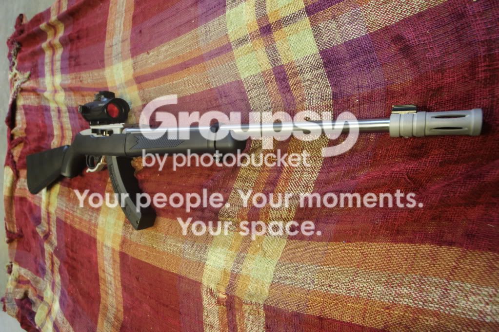

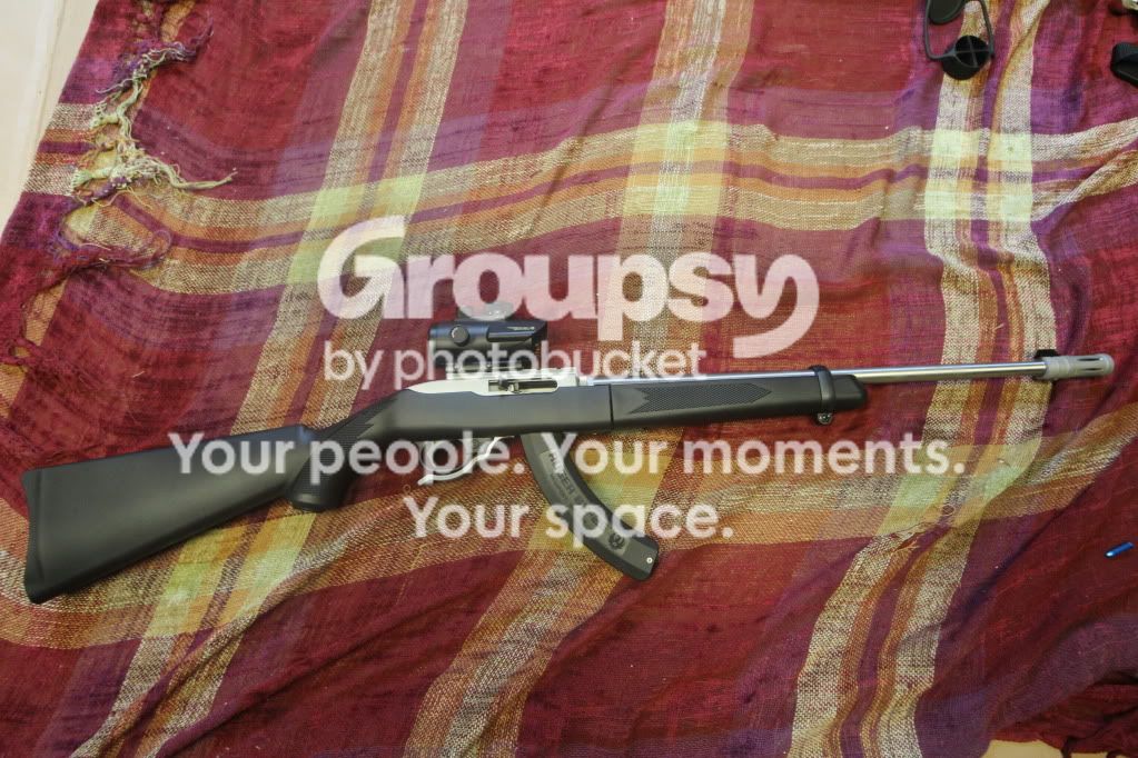

nice! btw, that little 10/22 td is my most favorite gun i own, i like it way more than anything else when i go shooting, it's pretty darn accurate, fits nicely into my hiking backpack, ammo's cheap... i really can't say enough good things about that little ruger, i'm waiting for some more stocks to come out as i'm not really cool with going out buying a new stock and hacking it up, not that confident in my smiting skills quite yet. though i have done a few trigger and receiver upgrades to mine.
you got the write up you used with that one? i like the color choice as well, dark earth is too light for my uses, OD green, is well drab, and everyone has a black gun, i'm probably not going into combat anytime soon, so black guns aren't really my deal, i've been dying to get this Cerakote thing a try!! makes them look awesome!

i really like what you did with yours as well! i'd like your post a second time if i could!
I painted the scope rail as well but I'm not really sure I want to scope it. Its more of a survivalist gun. As for colors, I'm not a fan of OD but love Combat Green. Cerakote does not have air dry in Combat green so I chose Magpul OD which is very close from what I can tell. Maybe a smidge darker.
