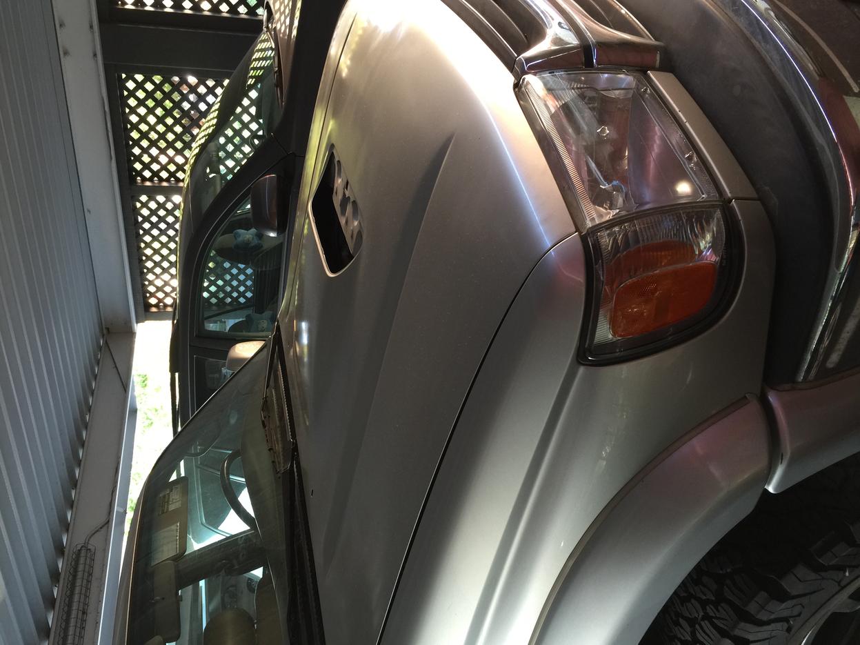

I actually went that same route and painted my sport hood silver with clearcoat; all duplicolor oem paint. The reason i went this route was because all the quotes i got were around 300 and i bought the hood for only 75! It didnt turn out too bad but i have plenty of experience with rattle cans. I used about 3-4 cans of primer, 6-8 cans of the base coat, and 8 cans of clearcoat. If you feel confident about your skills go for it!
