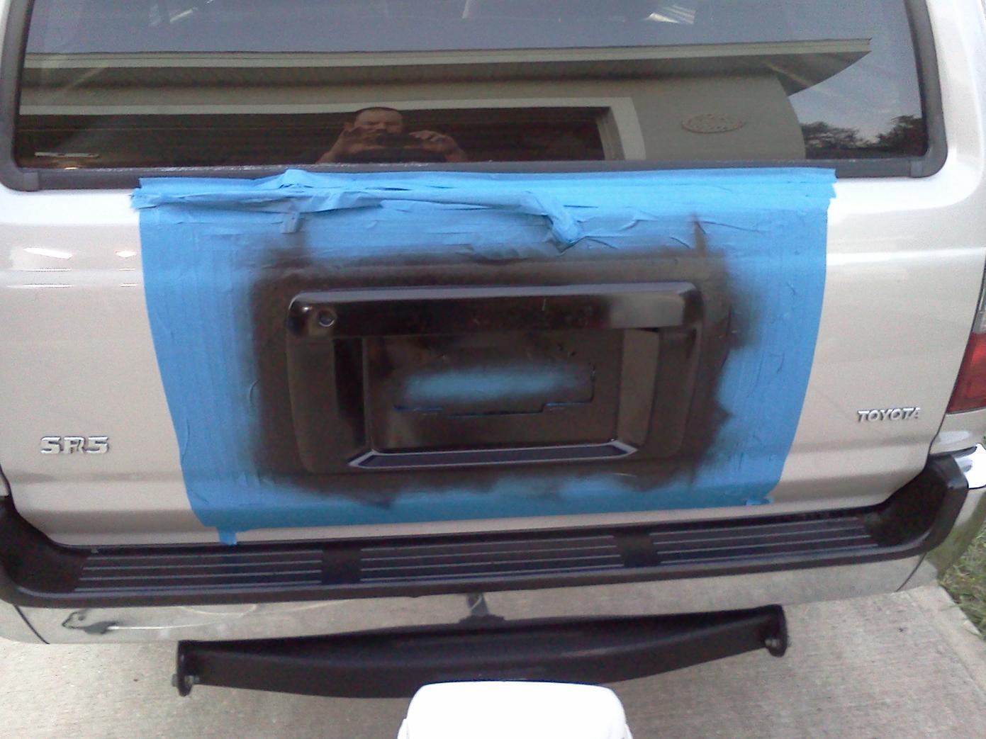

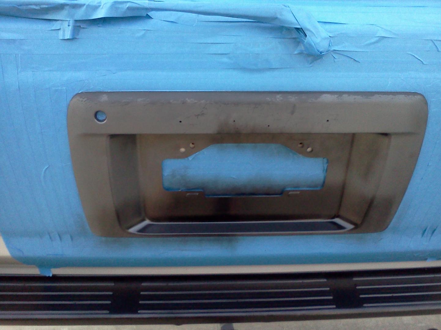

I used SEM color matched black to paint mine. It came out fine, though considering the price of SEM spray paints it didnt come out as nicely as I thought it would. I know I beat this like a dead horse, but nothing out there compares with Rust Oleum's consistancy, finish, and durability when it comes to paint in a spray can. I wish they made color matching stuff like SEM and Duplicolor do

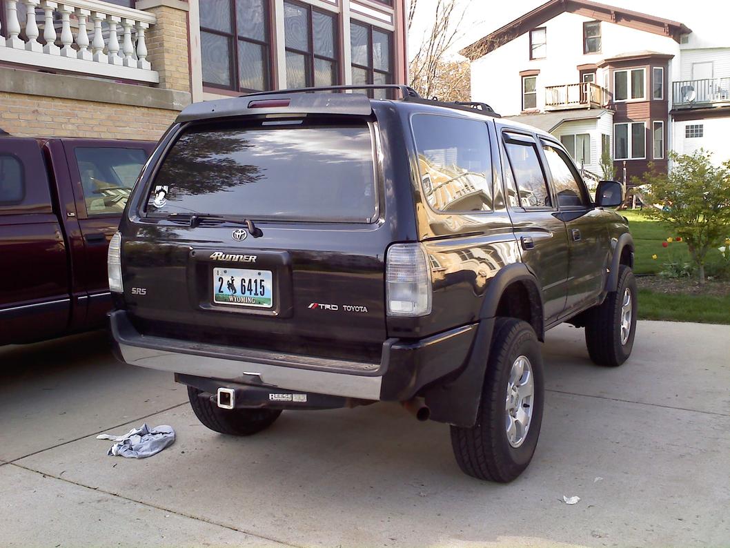

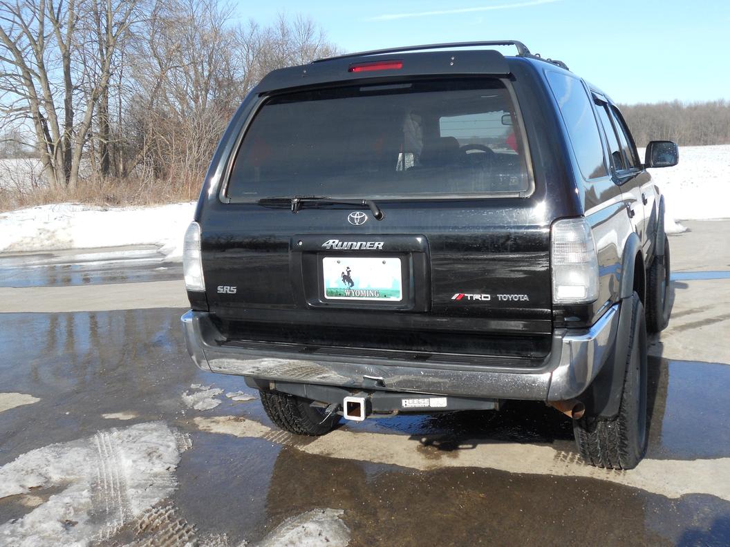

I used rust oleum black gloss "paint for plastic." Masked my gate off, removed my emblem, lightly sanded with a sponge style 300 grit sanding block, then 2 coats of paint. 8 months and still looks great. Also did my bumper top as you can see, same paint.

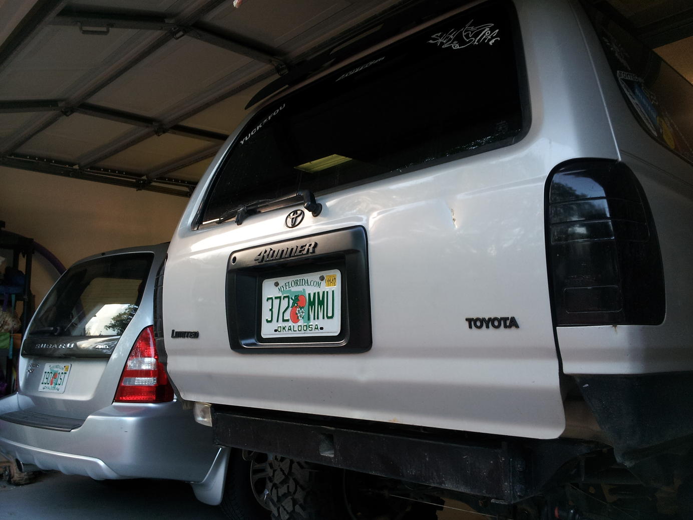

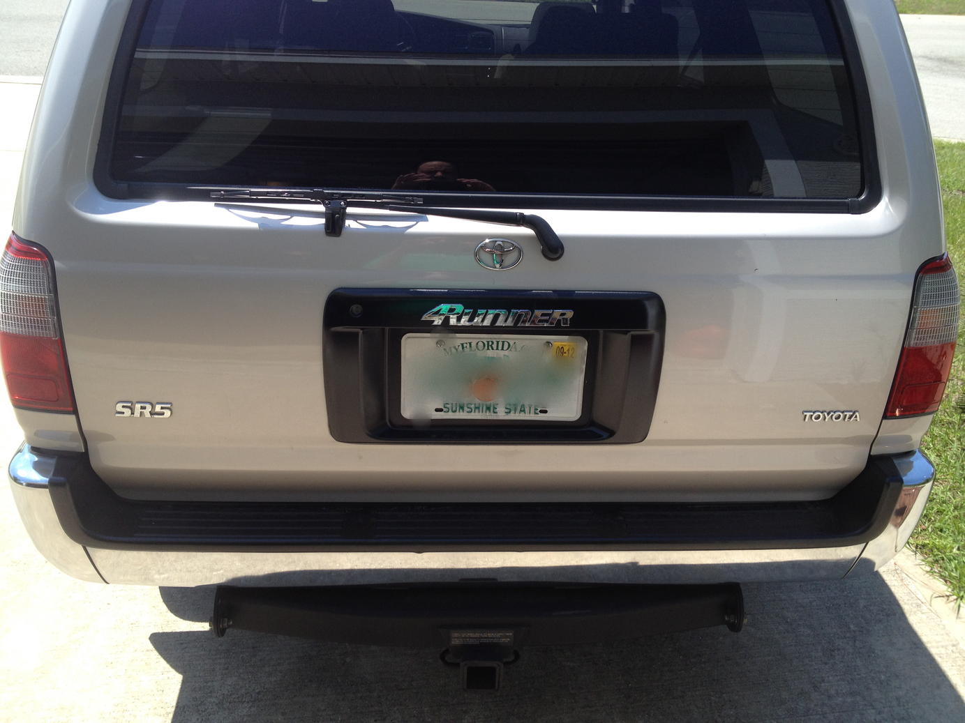

I painted mine with the duplicolor perfect match stuff at autozone. I think the color I went with was something like "phantom grey metallic" or something. It was a very close match to the color it originally was.
Only pic I can find right now that shows it
