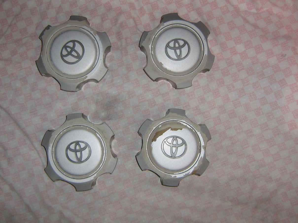

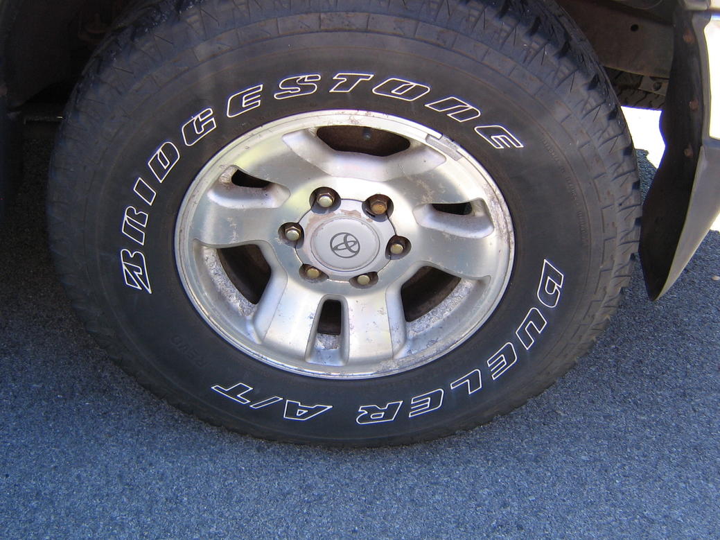

Pics of my ugly center caps in crap condition? :D
Just for you, Scramble
Nice! They're uglier than mine were! But my lugs were rusted to shit & my clear coat was pealing off.:dance:

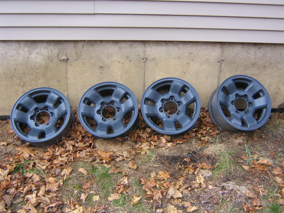

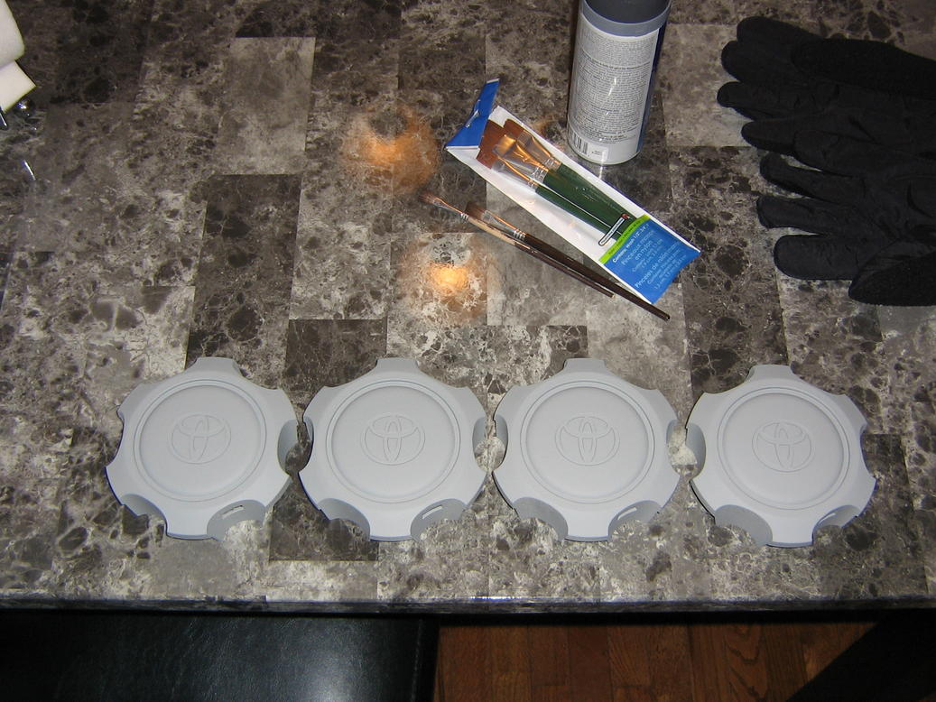

I painted my split 3's dark grey but never finished my center caps because I went to a 17" 4th Gen Sport Edition wheel. But here's what I did. I roughed them up with a scotch brite pad, got the loose paint off & roughed up the surface for primer. Then clean them in the dishwasher. It gets all of the dirt & grease out of the hard to clean inside. Before priming with Plastic paint primer put some tape over the metal clips. I did three thin layers of plastic primer. Then paint the color of your choice. I was going use the same dark grey of the wheel & hand paint the logos silver & then clear coat for protection. I really should finish the caps & sell the wheels. Another unfinished project sitting in my basement. :gossip:

Thank You, I'm not installing them. I moved up to 17" wheels for the TBU. I had them professionally media blasted & then primed, painted & clear coated by me two years ago. The paint is really cured by now.:blabla: I'll do the caps this weekend & sell you the set if you want them.
