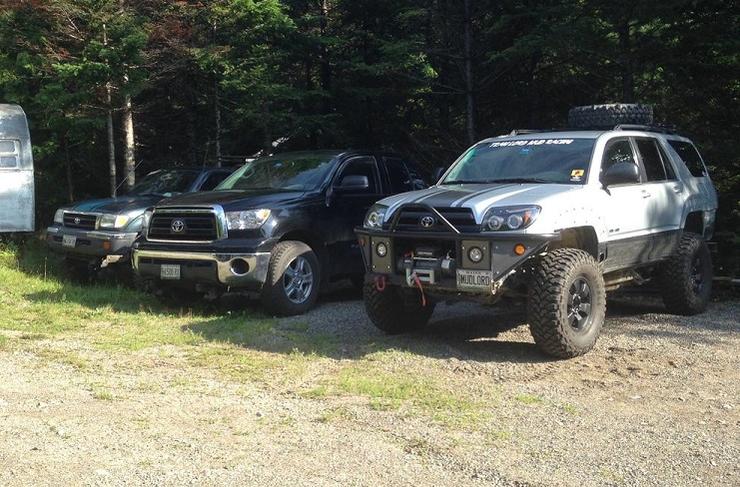

We'll be painting our stock 2003 T4R aluminum wheels black. Because this truck will be off road, I want the opinions of other users as to which black paint will withstand the most in regards to this. Is paint even the answer? Should we use Stone Guard or Plasti Dip? I don't want the paint peeling 5 minutes into the trails. Any help is much appreciated! :painkiller:

We ended up sampling a few spray options to see what adhered the best. We prepped the hell out of the wheels- sanding, cleaning etc. Sprayed Evercoat Rubberized Coating on them and let it harden. It adhered better than we could have ever expected. It won't even mark with a rock or finger nail. I am very impressed. This is mostly temporary until we get 17" black TRD wheels, but I'm pretty sure it will last for quite a while. :dancin:
