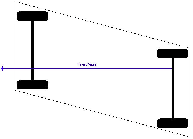

I was thinking and I think once you got it as much as you can, you can ask the alignment shop to dial in
thanks, that's actually exactly the route I decided to take, I've got it close with some rough measurements and I will have it dialed in when I take it to True Line tomorrow to get an alignment. I appreciate the help guys.
i think it's called the thrust angle. Tell them you can adjust the panhard bar or go to someone who's familiar w/ 4x4 trucks.
