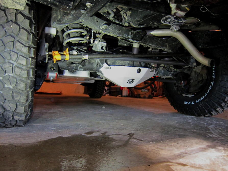

Installed Bilstein 5100s and FJ coils tonight, but during the reassembly, the panhard bolt started crossthreaded. I stopped turning before much damage was done, but now I need a tap and die to clean up the threads in the axle and try to save the panhard bolt. Anyone have the specs on the bolt handy?

Its a pretty hard bolt (11) so what you may actually be dealing with is that the panhard rod bushing sleeve is not lined up with the front hole leading into the nut that's welded to the front side. You want to be sure that the hole is completely lined up all the way through before attempting to pass that bolt. If it is, you should be able to start the bolt by hand.
If its not.... then you will need to coax the axle to L or R to make the holes line up. (I use a pipe clamp to adjust as needed but a ratchet strap can work as well) May need to remove the driver rear wheel to get better access.
In this case, pipe clamp set up to move axle to the right
That bolt gets torqued to 100 ft-lbs and recheck it after about 500 miles.
