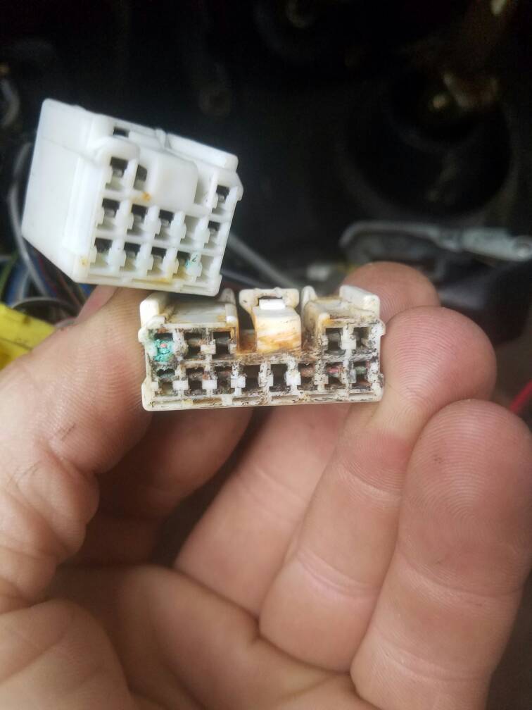

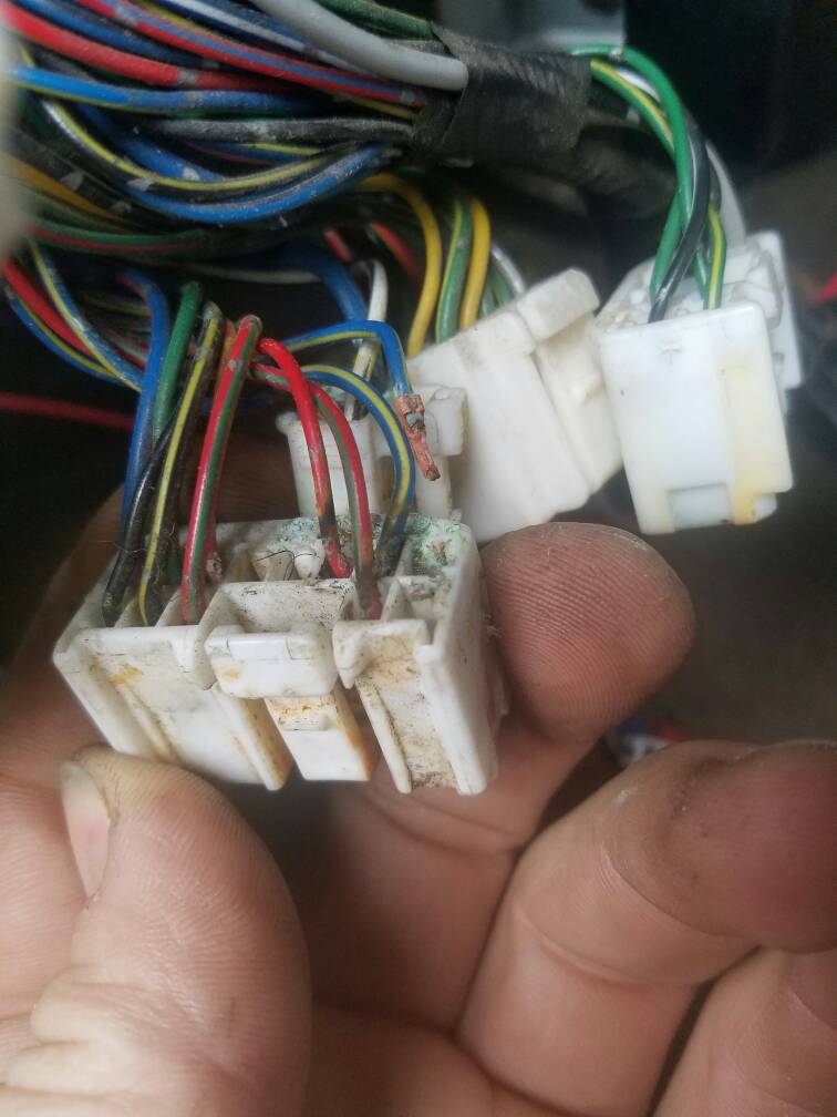

So battery got wrecked, because the lights were staying on despite the switch being off, even coming back on in the middle of the night...replaced the battery and discovered the issue. Windshield was leaking water in, which was getting on the fuse block. This totally wrecked the block and caused multiple shorts...
Ended up replacing the fuse block and all of the effected plugs with stuff i picked up from a part out. Pain in the ass. I think i went through like 60 crimp connectors repairing that harness.

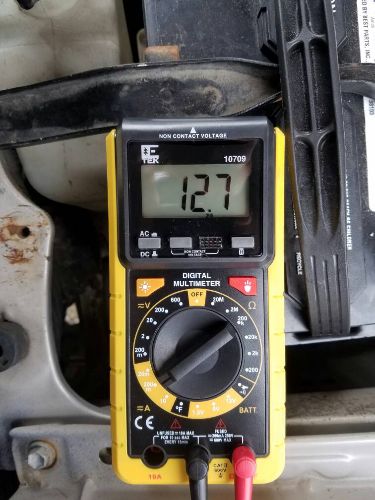

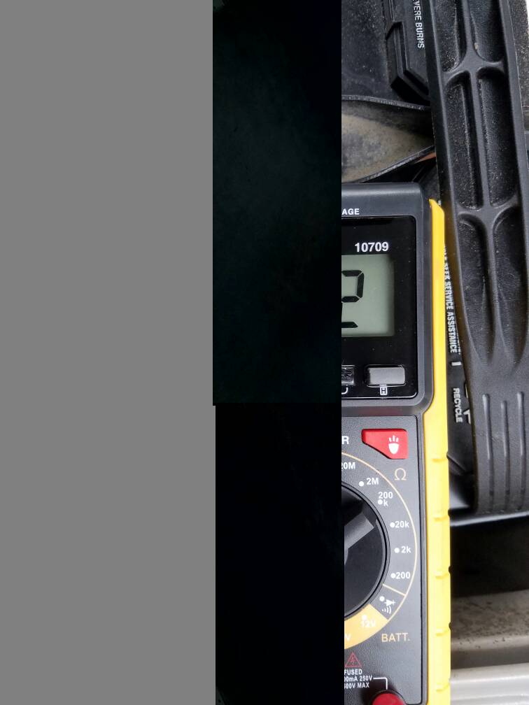

So thats where i need some help fellas. The base amperage draw while the truck is off and nothing powered on is 33.2 (milliamps?)
After pulling fuses, discovered the OBD circuit was the main culprit, and after unplugging my ultra guage, that it was the main culprit. This reduced the amerage draw to 12.7 (milliamps?)

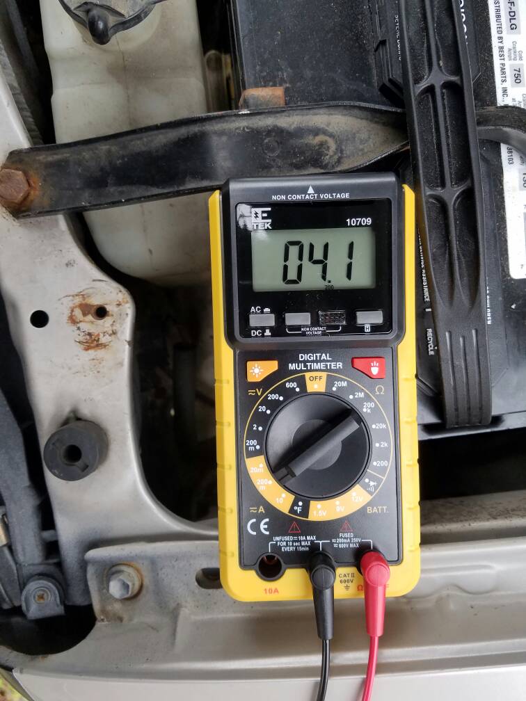

Then pulling the dome circuit fuse reduces it to 4.1 (milliamps?)

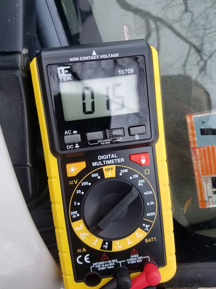

And then pulling the interior power fuse, the pink 30amp, it drops to 1.5 (milliamps?)
Obviously somethings up with my ultra gauge, so its probably going to get replaced soon. The rest i have no idea if there are a problem with the curcuit or if they are within the standard.

Thanks for the reply man.

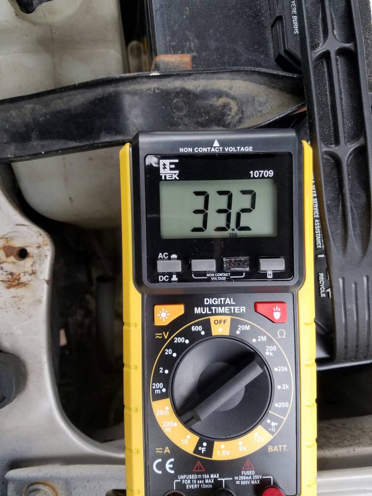

That's the process I went through. Charged it fully and then ran the meter inline between the negative post and terminal. The results are in the original post.
The ultra guage and meter both showed the alternator putting out over 13 volts at idle and 14.5+ at driving rpm.
Am I not reading the meter right? Is it 33.2 amps and not milliamps? If not that would be in the acceptable range of <50 correct?

Zach, I can't read the scale number on your meter but 33.2 ma is really all it could be which is absolutely normal. 33.2 amps would drain your battery in two hours max. So I don't think you have a parasitic draw.
How old is that battery? It may be just getting weak. I would recommend a load test or swapping with a different battery if you have one available. What was the voltage at battery, key off, when it won't start? And then after charge, but reading after running high beams for 30 seconds?
You should also check your charging system. What are your volts at the battery with engine running? Then with high beams and heater blower on high?

OK so 32 milliamps is NOTHING. That is NOT your problem. Dollars to donuts it's a battery cable issue, as someone already mentioned. I know you said you got a solid connection, but that doesn't mean anything unless you verify the voltage, did I mention VERIFY?
OK, so El Durko jumped on before I could finish, DO WHAT HE SAYS! hehe:gun4:
When the failure materializes, check battery voltage(AT the battery) and then on the cables, then at the fuse block and at the starter!:popcorn:

I was on the 200 mA scale for anyone that cant see in the photo.
The battery is literally 2 weeks old. Bought it new when i fixed the leak and replaced the fuse block, as the short had shot my old one.
Unfortunately i overloaded the meter, (have i mentioned im a newb? Lol) and need to pick up a fuse for it. So ill have to get those readings tomorrow after work. But its encouraging to hear that it might actually be a connection/charging issue.

the problem you have is the windshield leaking. then all those corroded connectors must be replaced ... using some push on connectors will work if you use the proper size to handle the current flow.
less than 100MA on shutdown should be good. 30MA and less is better. after those corroded wires/connectors replaced probably less drain.

Anyone that is a little more familiar with multimeter usage. Can you confirm that in the photos originally posted, and in the one I'll throw on here that the value is in milliamps and not amps.
I've popped 3 fuses in my meter now, all rated at 500 mA. Yet the peak reading I've gotten appears to be 40ish mA.
Anybody know what might be going on?
