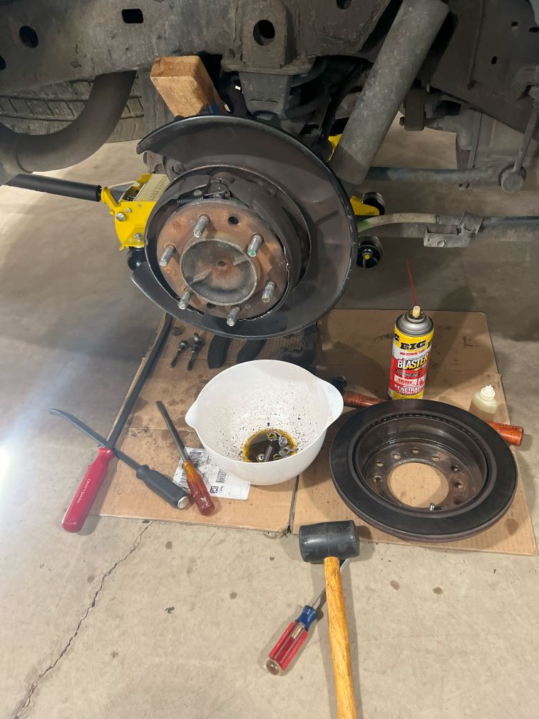

Hey all,
Replaced all of the hardware on my passenger parking brake a few months back. I know how difficult a job it is.
Today I went to replace rear brake pads on my 2006. I had decided I was going to pull the rotors and adjust the parking brake while I was in there.
Loosened the star adjuster and rotor on the passenger side came off fine. Reassembled and adjusted it to slight drag and backed off. Went and tested the parking brake.
After testing, the rotor would not move. Thankfully I still had the opening at the 6:00 position, but I could not move the star adjuster in either direction. The brake was locked up. The rotor would wiggle slightly, but I couldn't even turn the wheel by hand.
I tried putting the wheel back on and moving the car to see if it would pop loose, but the brake continued to drag. Just noise, no skidding, as thankfully our parking brakes are not that effective.
So I saw two options - (1) keep trying to loosen the star adjuster which isn't moving, or (2) try to force the rotor off. I decided to try to force it off. I only had 1" M8x1.25 bolts, so I was able to push the rotor right to the edge of the hub. I'm hoping to get some 2" bolts tomorrow to force them all the way off.
Any suggestions? I realize I am likely to break something when they break loose (I can see the shoes are pushing forward with the rotor), and I have another hardware kit ready to go (though I'm sure my hands are not ready for the job). I'm hopeful it does actually come off and not get stuck further. I don't think it's possible to put it back on at this point, even if wanted to.
Thanks!

On some classic cars I restored, when those adjusters would freeze up, I would usually hit them with PB blaster to free the little star tab up. If that didn't work, I would use MAP gas on a basic hand held torch to heat up the assembly to loosen the metal a bit.
I would try PB blaster first! If you can remove the whole adjuster once the rotor is off, Id put some anti-seize on the assemblies inner workings to prevent it in the future.

Thanks. I spun the adjuster in both directions freely before putting the rotor back on. It didn't bind up until I tested out the parking brake, and then it wouldn't move. I suspect something got physically hung up when I engaged the brake.
Hoping the rotor comes off tomorrow, it's close, just need the longer bolts to push it off.

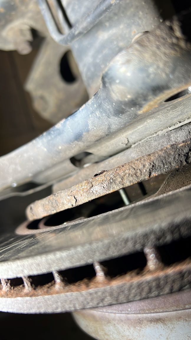

Did you replace the shoe hardware with factory or aftermarket? If aftermarket than the holddown pins are 1-2 mm too long. This screws everything up. Get factory pins, springs and cups. the second pic shows that it looks like the holddown spring already fell off as that's alot of pin showing.

Take some rust penetrant and spray into the adjusting hole onto the adjuster threads. Let it soak for awhile. I have had to do this on several of these models. After you get the rotor off make sure to clean up any residual penetrant that could get onto the shoes.

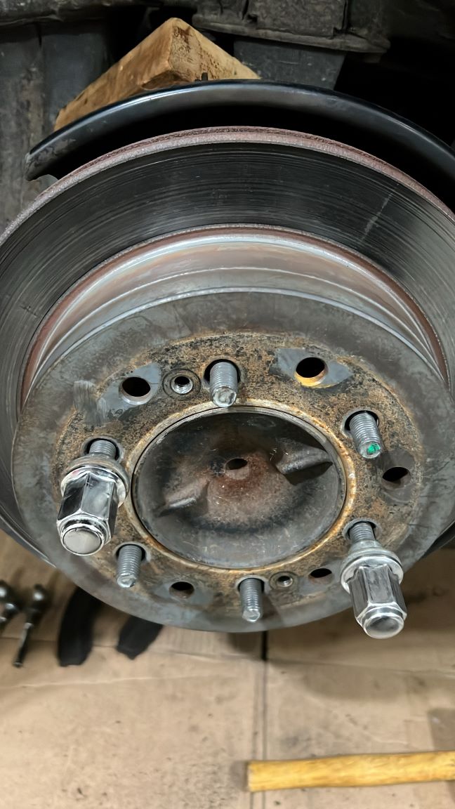

Perhaps the rotor is not seated exactly straight on the hub and is binding the brake shoes. Try tapping the face of the top hat all the way around to make sure it is fully seated against the hub. then try the starwheel adjuster again.
I suspect this is what may have happened. I put the rotor back on, but I did not put a wheel back on or torque down any lugs, so applying the brake might have shifted everything in to a binding situation. Unfortunately, as you can see from my pictures, I think the only direction to go is off right now, as I think it's unlikely it's going back on...
This was aftermarket, but I don't recall the pieces looking that "off". I think the holddown spring is actually in position, and highly compressed in that second picture, still holding between the shoe lever and the cup. It just shows how far off the rotor is actually driven right now.

OK, all, I am screwed now... the rotor is fully stuck... I'm at the point of stripping the screws on the rotor... the shoes look free up top but fully seated still at the bottom. I know one of the pins has snapped at this point. The good news is I can wiggle the crap out of it, the bad news is I'm just really pulling on the springs and the pads aren't releasing...
Any thoughts?
About the only piece of hardware remaining which is holding things together are the springs along the top which hold the shoes to the post on the hub. Everything else is broken and free. I am within mm of having the rotor over the wheel studs (hoping the rotor is softer than the studs with all the grinding that's going on between the two right now!).
This is really a brute force removal at this point...
Just need to get it off so I can get a new rotor, shoes, hardware. Unfortunately I can't move it at all the way it sits...
OK, it's off. I kept inching it off, using the bolt holes and a pry bar between the rotor center and the hub, until I was able to get in through the holes to knock at the shoes with a screwdriver. Sacrificed a Craftsman USA driver for the job.
