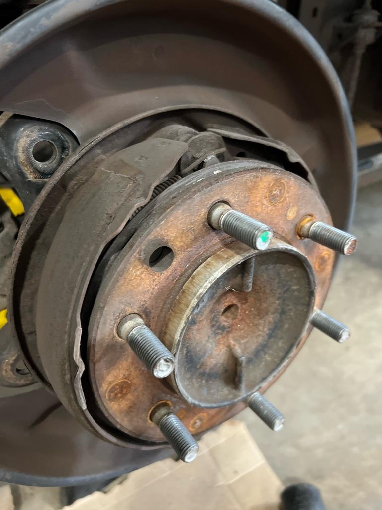

Heard some dragging on my right rear brake today. Thought it was time for new pads. Opened it up to find the parking brake linings shifted and pieces missing on the spring retainer on the rear shoe.
You can see the wear dead center on the edge of the rear shoe where it was contacting the inside of the rotor.
I don't have any real tips to offer, as I spent hours trying to get the spring retainers on. I was only able to get a hardware kit on a Sunday, so I didn't replace the shoes, but I figure it's only the parking brake... Not that I want to be in there again, mind you, but I had to do what I could do on a Sunday.

I think the first was more helpful. I had to build the spring retainers once the shoes were in place. There was no way I was going to assemble the spring retainer, and then slide the shoes in to position. The keyed cap on the retainer for the spring just fell off too easily unless the spring was under tension.
