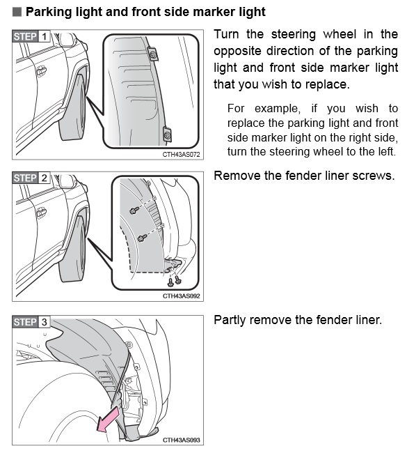

I was thinking of swapping out the stock bulbs for LEDS in the front side markers and was wondering if anyone had done it. I'm assuming there shouldnt be any issues [ie flashers] as these are either on or off.
Also: I'd guess you have to remove the entire headlamp unit to replace these bulbs? I tried to wiggle my hand in there but didnt get close - is there a trick?
I have never tried on this 4runner in particular, but I don't think there should be any issues putting in LED bulbs as far as flashers go. The way our manual says you should access it is through the fender liner (see attached screen shot).

It can be done without removing headlamp assy. As mentioned, remove some bolts for wheel well liner, pull back and really, really stretch. The front markers are mounted in a long "stalk-like" socket. That will drop down enough to be able to exchange lamps before re-installing. You might need a trip to the chiropractor after this maneuver. Might be easier if truck is on a lift, and you can stand underneath. Good luck.

BTW I did it thru the fender liner - it might have been only a little bit less of a hassle than pulling the entire lamp unit.
