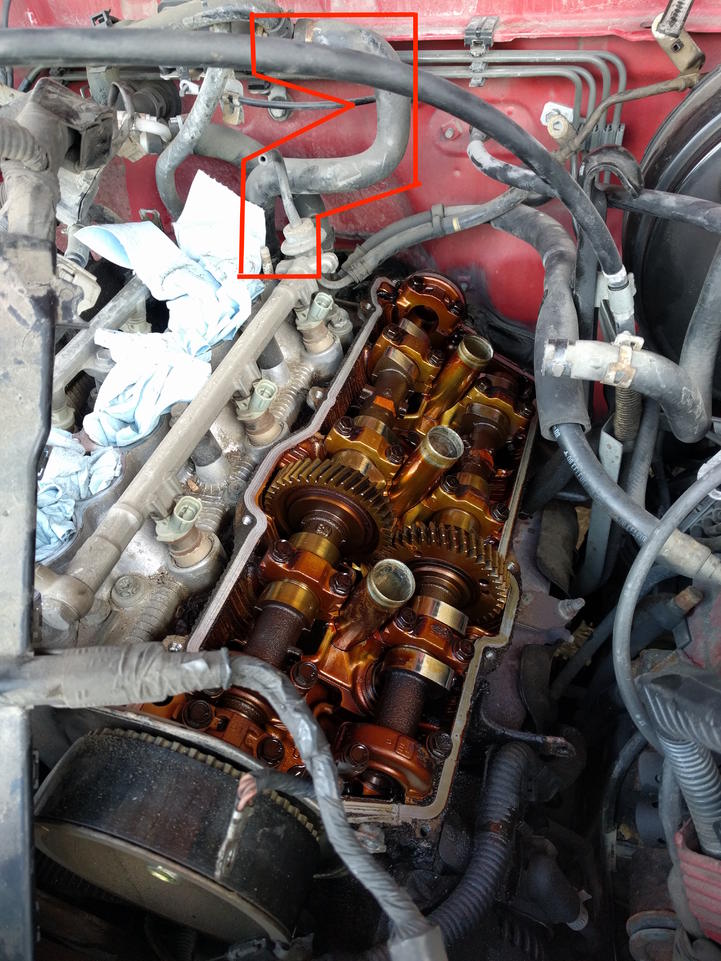

I was changing the valve cover gaskets today and found my coolant leak. I found a generic part number for the hose, but it does not take me to the exact one from the pictures, I cannot find the right one. I have a picture below that I circled the hose. Also, I am happy to say that there was virtually no gunk in my engine at 240,000 miles!:banana:

I may have that #. Let me check. Can't make any promises.
The engine looks clean. I do have to ask how old that timing belt is though?
The timing belt is getting replaced with the next paycheck, it has 160k miles on it (I just got the 4runner 2k miles ago)
