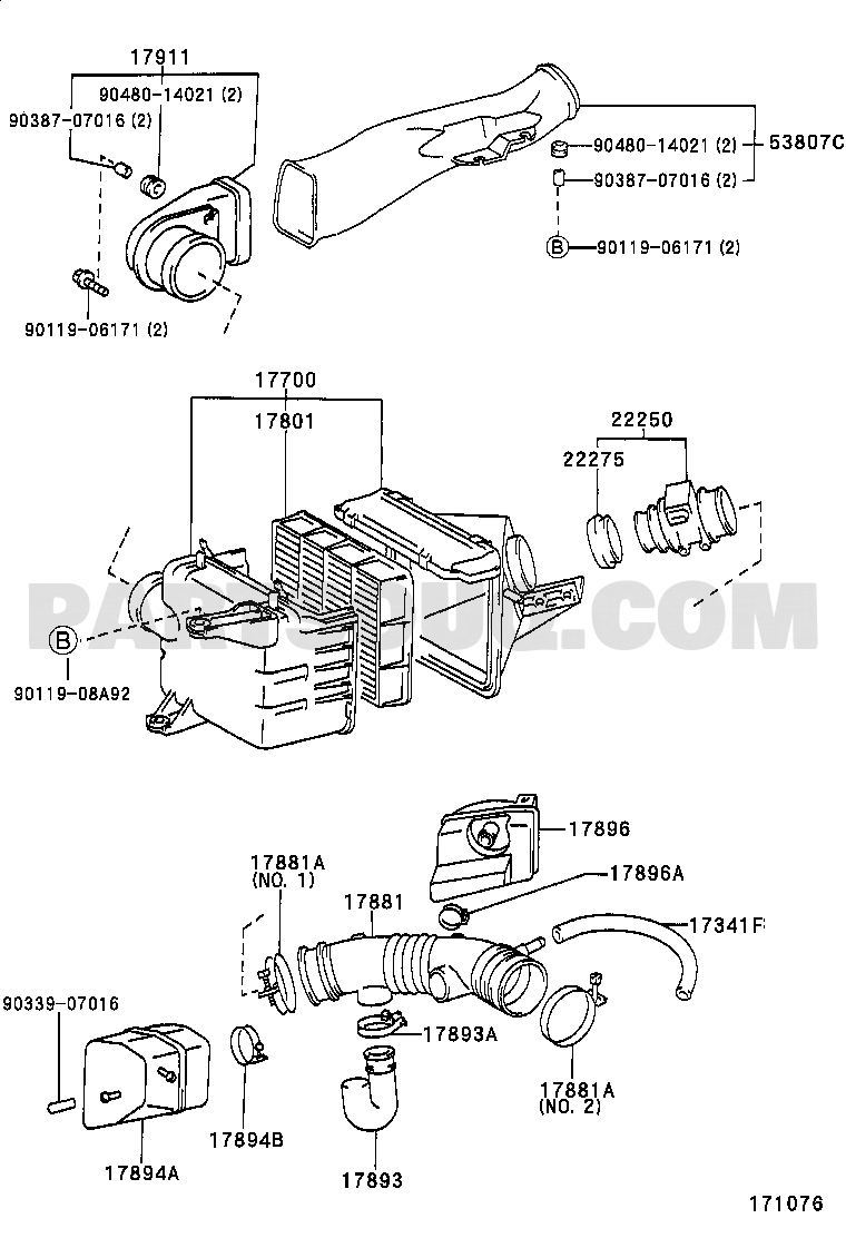

Maybe, but I've never seen that before. They seem to keep the obsolete parts in the drawings. I don't even see these bolts called out, they should be next to that 22250 part:

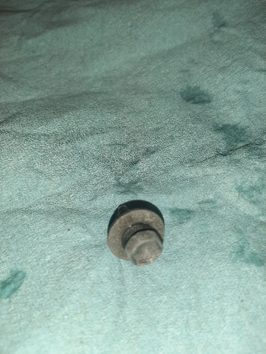

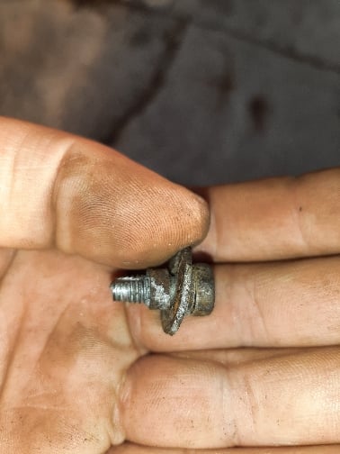

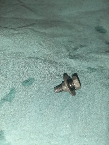

Ok. Let me see if I can get it super clean and rust free. I put it in my evapo rust bucket before I send it to you..:)
Sent from my SM-A505U using Tapatalk
Thank you kindly, I was just about to ask about the rust status. If it's really too far gone, I'll just probably schlep to the junkyard, but if it's mostly surface rust, I'll be happy to use it. Let me know, feel free to PM me. Thank you!
It's just a M6x1.0 bolt with a flat washer and a spacer crimped on. You could go to a hardware store and get a new bolt, Either see if you can find one with a washer attached or just get a flanged head M6x1.0 bolt. I believe the length for that specific bolt is something like 25~30mm? Just measure the length or take it with you. If you don't get a spacer just be aware to not overtighten it because that spacer prevents you from crushing the plastic mount, something like 7-ish ft.lbs of torque should be more than plenty to hold it on.
