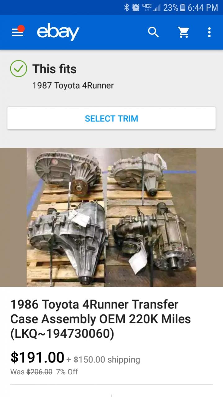

Does it look like the transfer case, etc.. is available?
Quick search = LKQ on ebay for $191 + $150 shipping.
