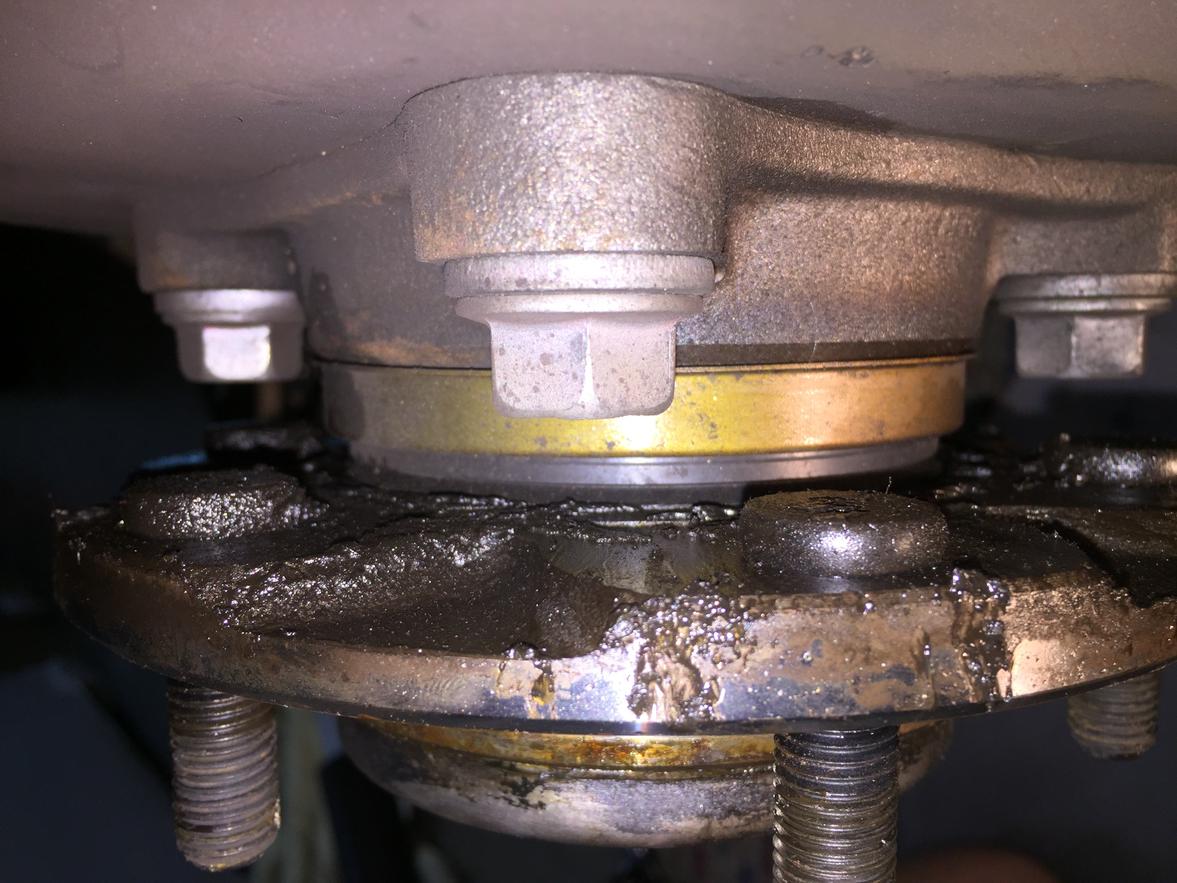

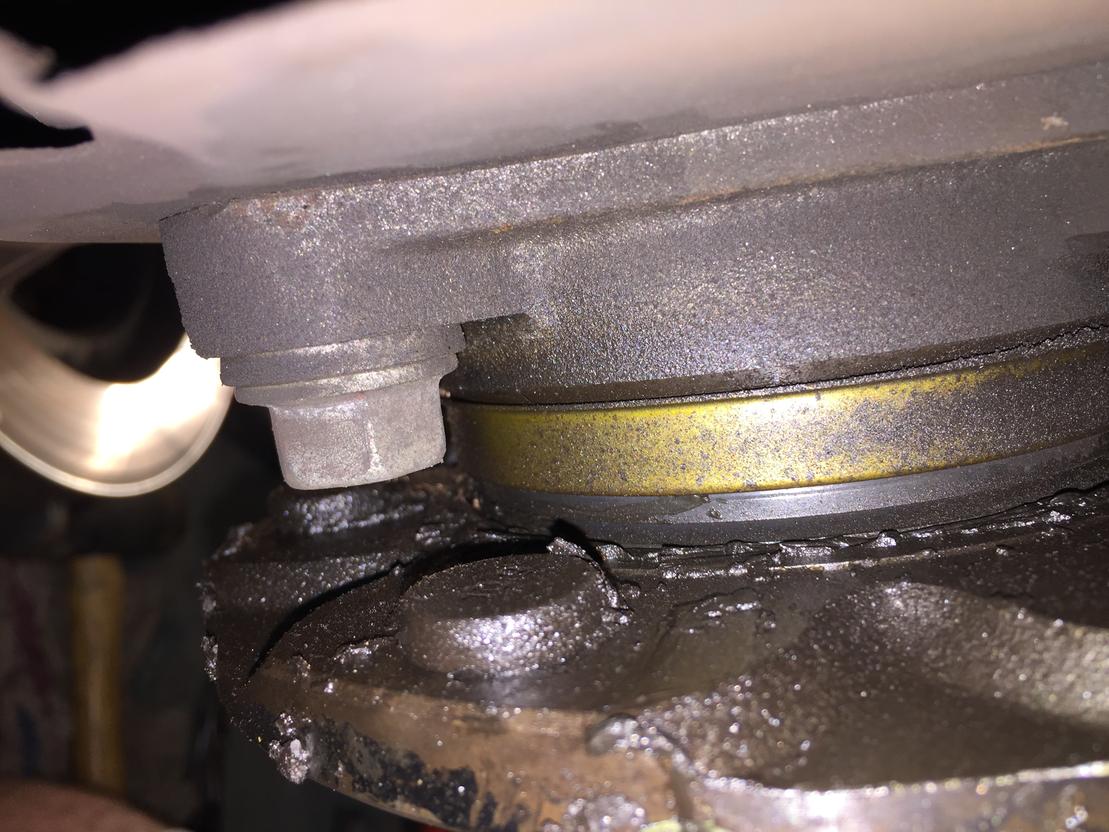

Hey wanted to follow back up and say I got my part late, but it arrived and I installed today. While at it I checked passengers side that was replaced by part ordered from Marion back earlier this year. Is this grease normal? It has been on less than 8 months?

Aren't they supposed to sealed bearings? In either case, sealed bearing or bearing with cup seal, I do believe they are leaking more than bit early if that grease is in fact, and it appears to be, coming from the bearing assembly. I had been wondering if I'd go OEM and find a press when I ever need to do mine. This thread helps answer that question. Can they be pressed with a good 8" vise?
[MENTION=23368]rgcary[/MENTION] It might be a bit of extra grease seeping out. I do recall Marion saying he adds a bit extra since most of the bearings he's seen from factory that failed seemed a bit under greased.
The bearings are sealed somewhat, but it's actually two halves that are pressed together in the housing and then seals and o-rings on each side. I'd just check with Marion to make sure you're all set. I vaguely remember having a slight bit of seepage after installing mine, but after cleaning it off it hasn't been an issue.

Thank you. Marion reached out to me today via text and said he usually overpacks them but if no play or noise you should be okay. I will test tomorrow once this hurricane passes us in NC. I cleaned off and will see what happens. Thanks for letting me know.
