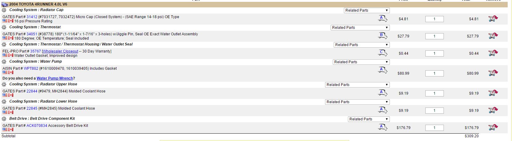

Got a new to us 2005 T4R SR5 with 103K for my son. I'm getting ready to do the coolant and drive belt change. See my parts list below from Rock Auto...I think I got everything. Comments? It is the first time I've bought from them. (and yes I know it says 2004...will correct when doing the real order)
