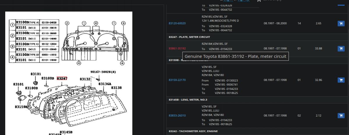

I don't have this issue, but recently replaced my printed circuit board. I went with a used cluster, stripped it down for the board. Check Amayama with your vin, under meter 8301 towards the bottom of page. Might still be available new.

Does this one look right?
Also $300 for the clock is wild :laugh:

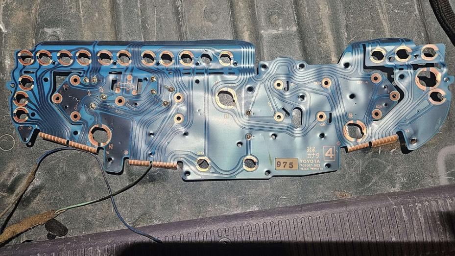

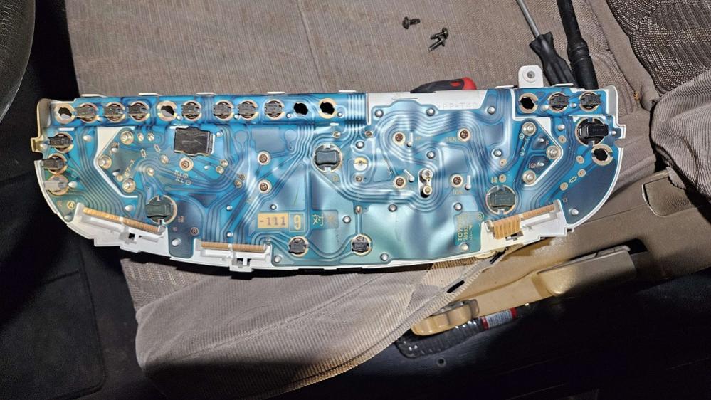

So yesterday I was at a junkyard to grab some interior stuff I'm missing, and thought hey, I'll grab one of these PCB's for funsies. The guy didn't know what it is so he didn't charge me for it.
I'm not sure about what it came off of either as the cluster was just on the ground inbetween a few 4runners, but they sure look ALMOST the same. Any reason I shouldn't just throw it on and hope for the best?
On truck:
From Junkyard:

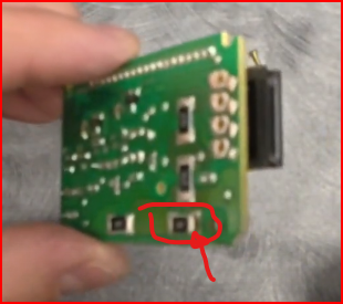

Since clocks were brought up, I also fixed my clock, one of the little black things on the back of it had a broken joint. I didn't even use any tin, just heated it up with the iron and it started working again.

It looks similar, but there are some differences. Some of the jumpers are in a different location. I'd just triple check to make sure it's the same. If it's not I'd probably pass on it and find one from your exact year and trim level.
I've been having a really hard time finding that exact flex pcb so far. Each one I find is an exact match for the one I already showed from the junkyard.
Just saw a guy on marketplace selling one out of his 96 manual 3.4 and its the same 975 759917-982 that I got out of the automatic guage cluster from the yard. Mine is a 98 manual 3.4
When I first made this post I did go straight to amayama meters section as suggested, its only 30 bucks + shipping so roughly 50. After I placed the order they got back to me and said that part is no longer manufactured. Ever since then I haven't even been able to add it to my cart.
If I try that other model PCB and it doesnt work whats the worst that can happen? blow a fuse? could I kill my ECM or something catastrophic? hah. I'm crap with electronics so thanks for input guys.
'98, especially on the auto side is an odd-man out... It is the only year with the gear indicators on the cluster as LEDs instead of down at the bottom. Much less of a worry with a manual, since your truck won't use those connections.
As 2TH4IST already said, trace all those connections and make sure they match. They might be routed differently but connected the same...
At the very least, make sure the connections to the tach, speedo, fuel and temp gauges match. The rest of the connections are bulbs and won't be damaged by a wrong connection.
-Charlie
