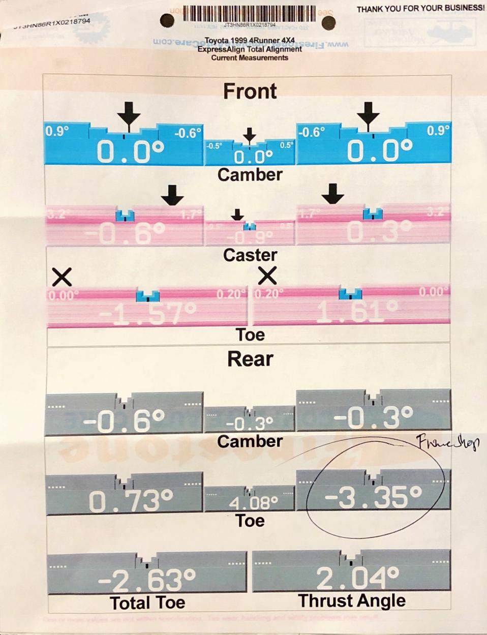

I took my runner to Firestone to get an alignment since I have their lifetime alignment service (seriously considering switching to discount tire). I just got my vehicle back about 10 minutes ago.
They told me that they could not perform the alignment on the front because the rear passenger wheel's toe angle is -3.35 degrees out of alignment. They didn't offer me any solutions as to what would be the cause of this. They only said, "take it to a frame shop".

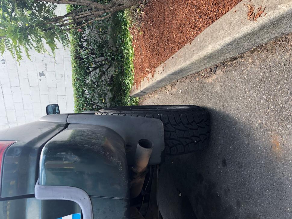

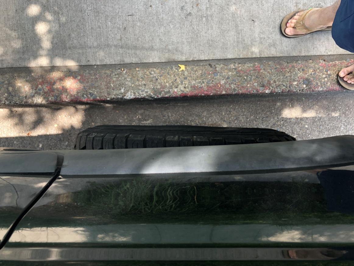

Do you think the pan hard bar could be the cause of this? Upon visual inspection of the wheel, I can clearly see the wheel sitting in the wheel well at an angle. The front of the tire protrudes further out of the wheel well than the rear. I attempted to take a photo of this but I’m not sure how well you can tell.
Are there any other potential causes for this? I am headed outside to take the wheel off and check things out, but I wanted to get this posted up first.
I’ve attached a few pictures and the alignment sheet from Firestone here.

Wow! That's a lot of toe! Judging by the total difference in toe (4.08 degrees) you have a bent axle housing. If it were upper/lower control arms out of alignment the axle total toe difference would still be close (usually within a degree). If it were rear wheel bearings it would be more likely to show as camber and would make a roaring noise while driving. A bent axle shaft would be causing a crazy tire wobble that you would be able to see. My $$$ is on a bent axle housing.

I assumed the body roll was caused by the pan hard bar needing the correction kit installed so I wrote it off as that. Now that I have visually seen the crooked wheel, I know the body roll is being caused by this.
Where was the vehicle parked? I bet somebody backed into the tire and bent the axle.
It was parked on the street and it was parked in the same spot for a long time. This is kind of what I’m thinking happened. How hard is it to bend an axle housing? I would think something substantial would have to be hit.
It isn't hard to bend a housing under certain conditions. I owned and operated a Body/Frame Shop for 14 years, and I saw plenty. One of the most common things is getting pushed in to a curb, damage on driver's side but the rear wheel/tire pushed against the curb will bend the axle. That said it isn't super hard to straighten it if you know how, kind of a lost art due to liability issues. I did them for a long time, not anymore. Unless it was mine and I had a good porta power and some chain and possibly some large i beam steel.
