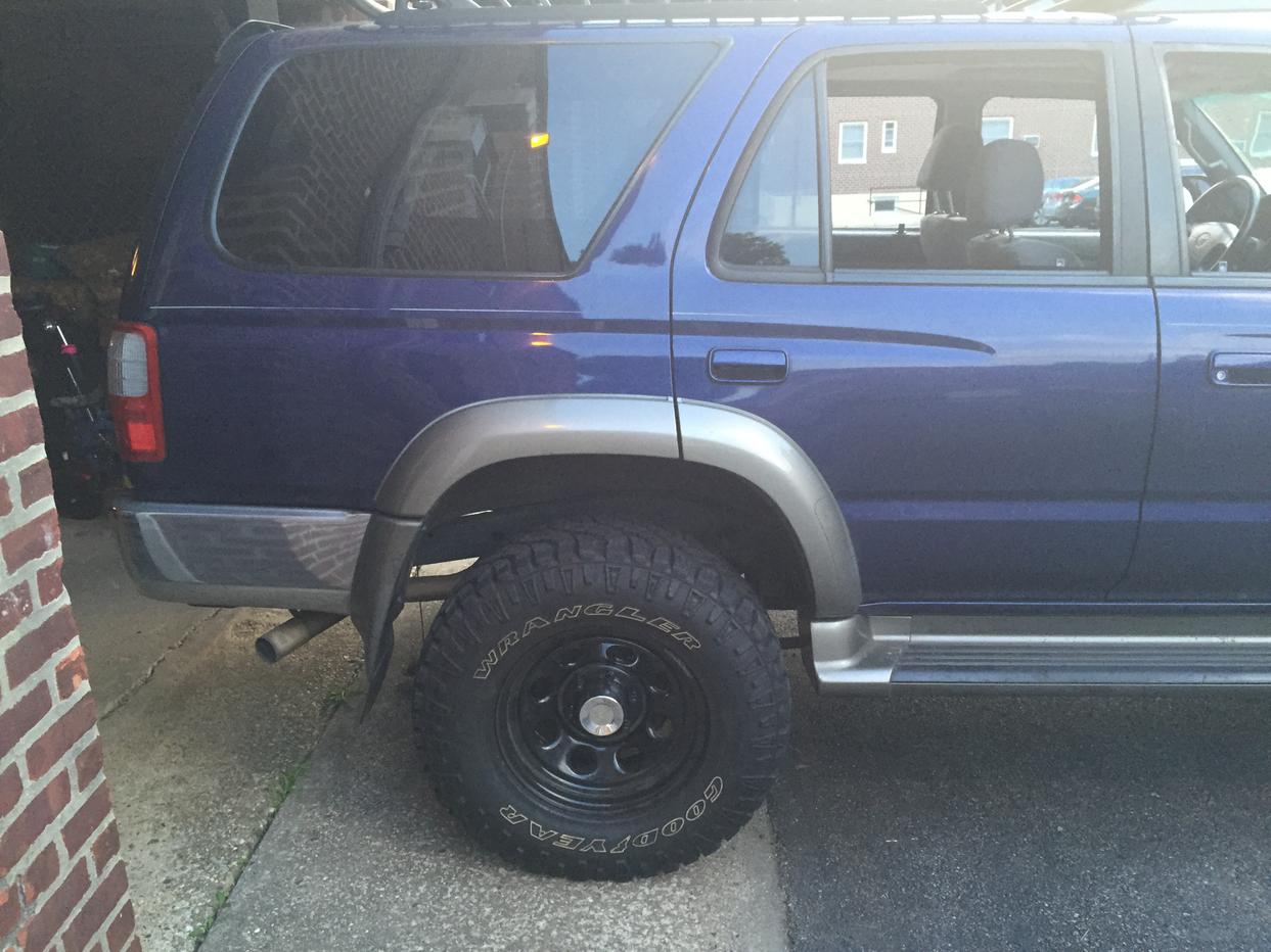

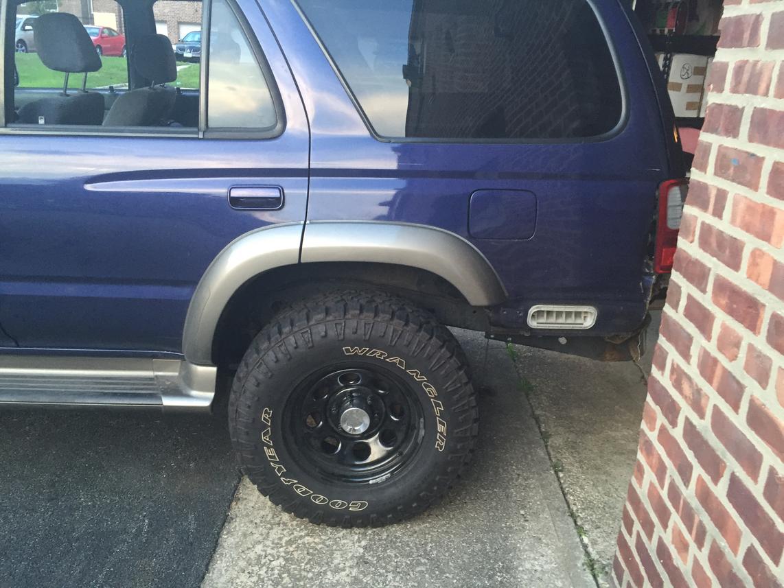

So trying to finish up my lift and the passenger side rear looks a bit higher than driver side rear. Put 906 a for driver and b for passenger. Did I do anything wrong?
I can't remember the letter designations from when I did it. I do remember that the instructions given me where backward. (an Ozzie mix up of driver and passenger side) I used a bit of grey matter and put the tallest spring on the drivers side to compensate for the fuel tank and a drivers lardy butt. Sits perfectly level.
I hope yours went in that way too.
Good luck, at least they are easy to swap.
