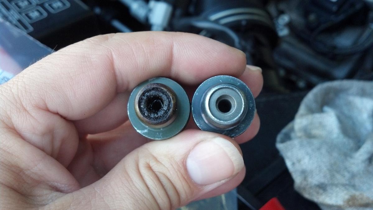

not much info but to show some what a bad one looks like. the check valve was no longer checking, blowing air in both directions. grommet was toast. 12 years of heat made it crispy and came out in pieces, as usual. cleaned area and installed new OE parts. oil change as well with seafoam treatment. :trophy:
