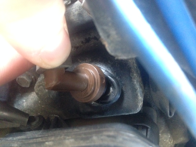

It never did, but I just checked on the valve now and its ripped?? - I took a picture to show yinz. Let me know what your thoughts are with this. Should I buy new grommet now and go through this pain again?
Or will everything be fine here... Let me know - You should be able to see tear on the upper outer ring portion.

By the looks of that, I'd put a new grommet on - its gonna leak alot the way it is. Just wet it a bit to slide it in on new one. Luck. :cowboy:
That doesn't look right, don't take any shortcuts and just get another. I JUST did this replacement (old one did the same thing n ripped in half) but I put the grommet in by itself first, then took a swab of oil off the dipstick with my finger and lubed the inner sealing service n pushed the pcv right in. If you don't get a new one and it leaks a vacuum leak will do all kinds of weird stuff to idle and what not
A whole nother' $3!!! Instead of some idling issues?! FORGET IT, ill go another 100k till I invest that!!
Just kidding, I'll go to Advanced today after work and pop it in. Def gonna use the oil from dipstick to get it in easier.
Thanks for the Tip!

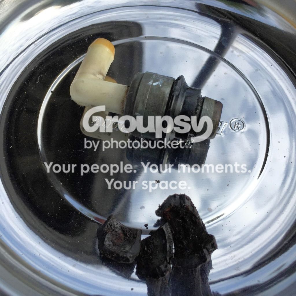

Listen very closely, because you're in the same situation I was in when I changed my PCV. The grommet is really dry-rotted, and will come off in small chunks which can fall down into the hole, potentially clogging an oil passage. Mine split clean in two then I tried to pull it out, and the bottom half fell down into the hole, which ended up taking close to an hour to retrieve it.
Just be aware and be careful so it doesn't happen to you as well.
^^^^X2 on this. When I did mine it broke into two. Luckily, I could see the piece that fell into the valve cover and got it out with some very long nose pliers. Just be careful.
Don't stress over breaking up the old grommet. Unless you pulverize the old grommet into near sand-like particles— it will be caught in the trap under the cover so it doesn't get sucked into the engine. If pieces do fall in (good chance they will if it's the original) then just grab some needle nose pliers and fish them out gently. No biggie.
Mine was original to the truck and petrified...it didn't budge without a fight. Had to go grommet fishing...

Lol... yep both of you were right... taking my original PCV valve out the top ring ripped off and left it with the bottom portion of gromment stuck in. That whole piece ended up falling in and i used a long skinny flathead to retrieve it up to the hole - from there i cut the grommet with a razor blade so it would flex better then I retrieved it from the hole. What a waste of an hour trying to get that out!
