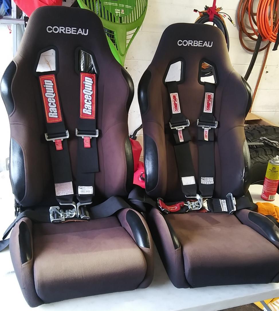

Found some racing seats w harnesses. Dirty and Sun faded, but Cheap. Cushions were hardly sat in and still like brand new, they just been sitting for awhile. Just scrubbed them down w some fabric cleaner and a stiff brush. Dye them back to flat black and they should look OK.

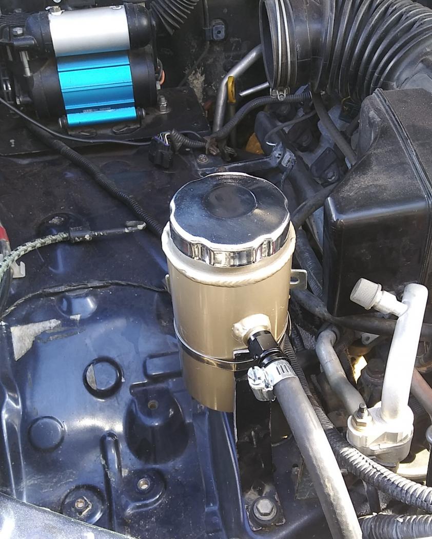

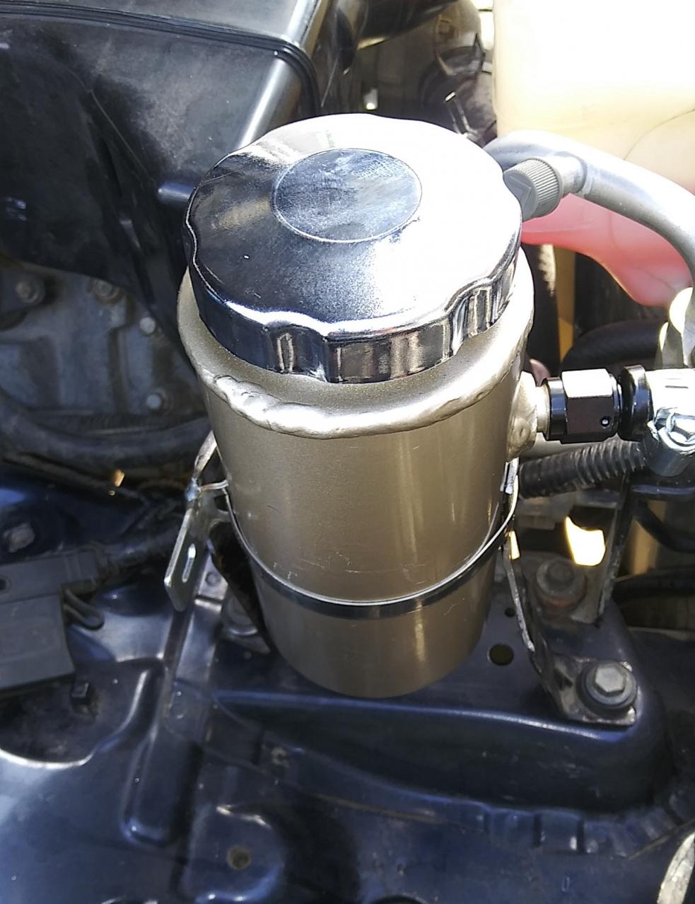

Mocked up my new PS resevoir today. Repurposed the old res brackets and welded the hose clamp bracket to one side and it should hold in there pretty well.
Will have twice as much fluid for the 200 rack....well if I ever finish up and fix my tie rod mistake.

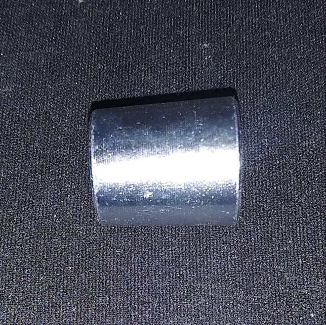

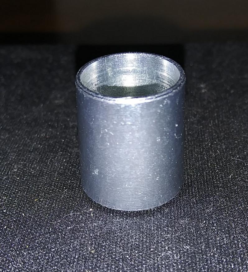

Does anyone know where to source a tapered bushing sleeve like this? I found ball joint bushings and a few others designed for Jeeps or the big 3, tried McMaster and Grainger, but no luck.
Its OD is small end: .70"
Large end: .76".
ID: 62" for a 5/8 bolt
Overall length is: .85"
I need something in this size range, then maybe I can ream it out to match the 4Runner OTE taper.
