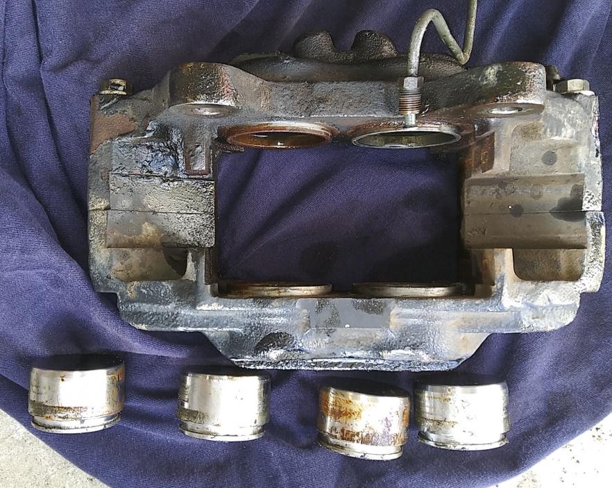

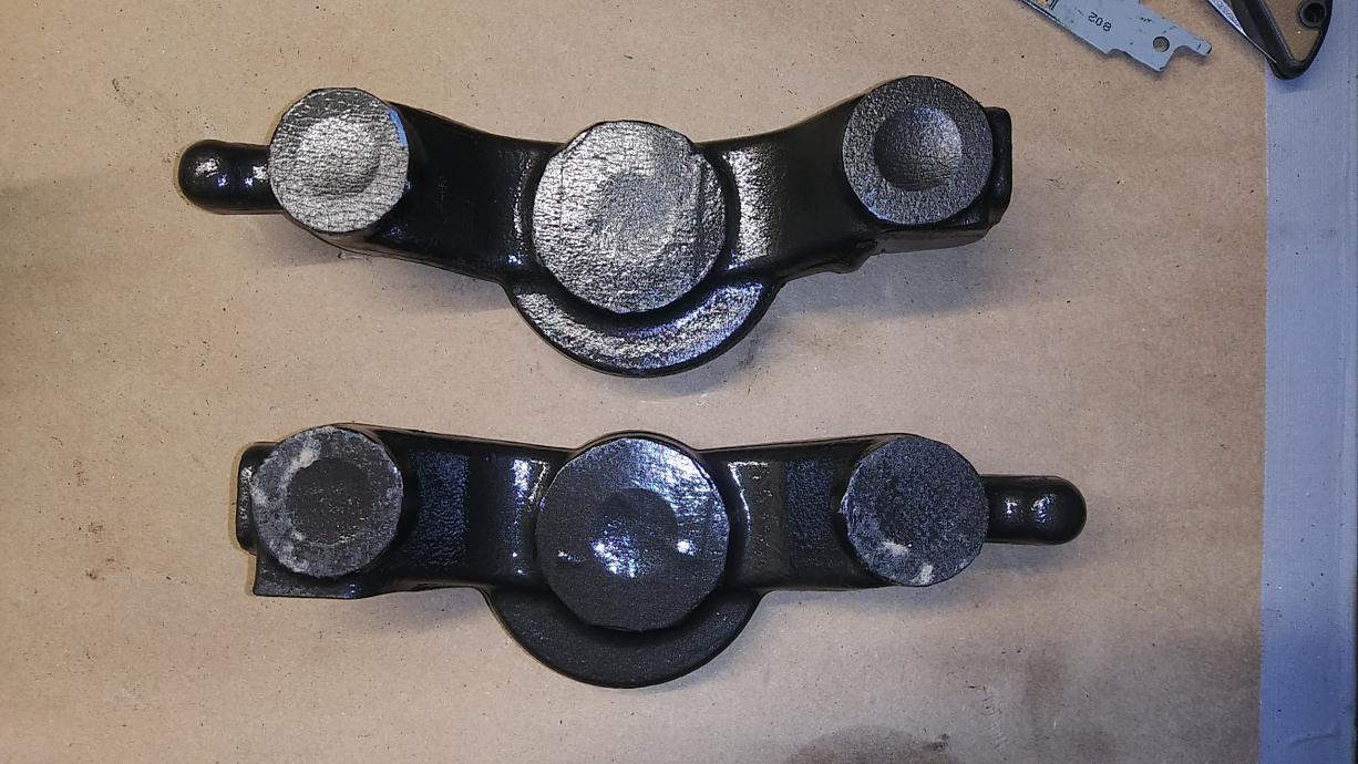

So I shifted over to my front calipers. Did the bigger 5th gen upgrade when I installed the TC suspension (4 years ago). Let me just say not entirely impressed w the new Centrics I installed back then.

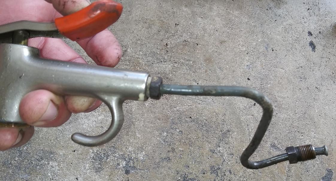

I rigged up a steel brake line to my compressor to push the pistons out. One caliper had 3 seized pistons, but the rubber was in decent shape and still in tact.
Rubber on other side was cracked and brittle, but the pistons were at least still working and popped out w minimal work. Go figure. SMDH. One piston on the other caliper is still seized, so I'm letting some PB Blaster work over night.
Now the clay and lime content in the Ocala National Forest might be part of the reason for this early corrosion, but I doubt these things would last 2 season in the rust belt.
Considering inflation and supply chain issues, I have to rebuild and can't buy a set of quality new ones, because Im already way over extended on this build right now lol.

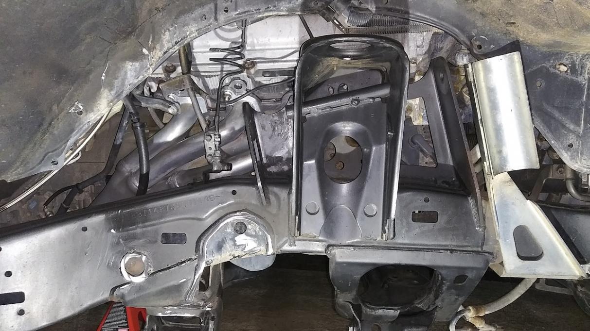

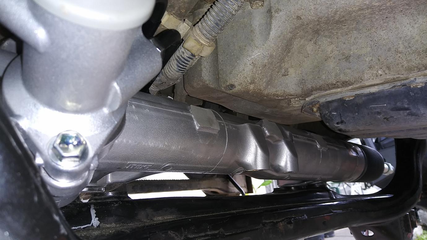

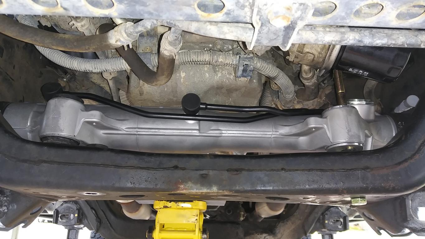

Raised the engine and did a test fit, seems like it'll work. Looks centered on the frame within a 1/16" to 1/8 " Will notch the frame and drill and weld a sleeve for the passenger side mounting hole tomorrow. Then fab some 1/4" spacers for the motor mounts.

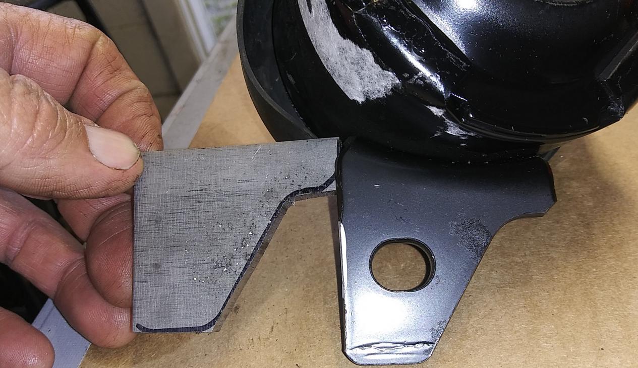

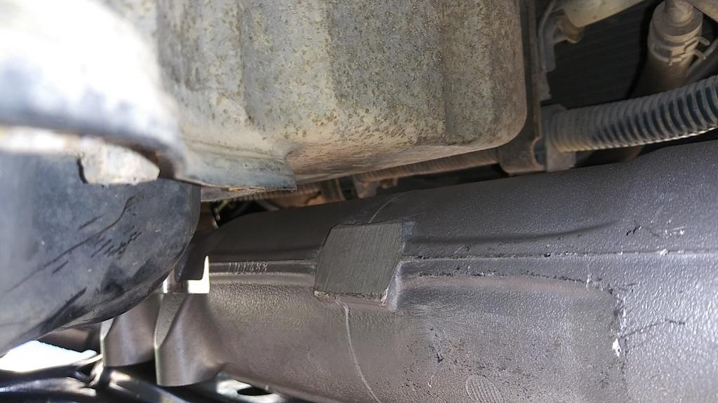

LC 200 Rack Motor Mount Spacer fab

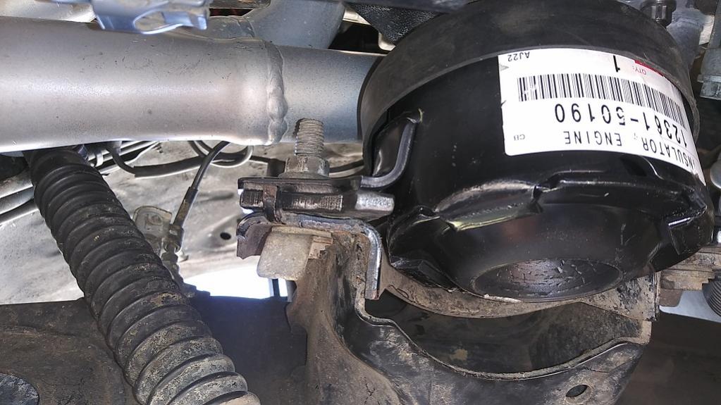

I opted to put the 1/4" spacers between the mm wings and the frame. I really didnt want to put any stress on the mounting points in the engine block either.

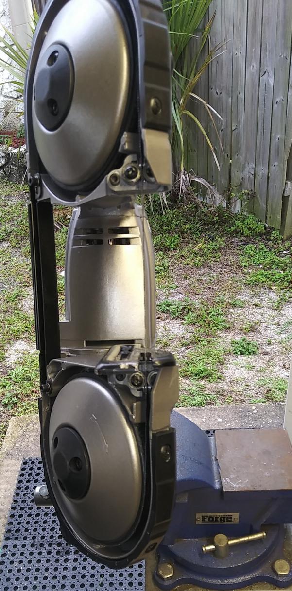

Locked my portable Band Saw in the vise, and voila, vertical band saw.
Got the basic shape cut out, now I'll smooth the corners and edges w a flappy, then drill em out and paint.
I may put some thin L shaped tabs under the hardware to keep the spacers from sliding around. We'll see how secure they sit in there first.

recently bought one of those porta-bands and I love it. way nicer and less barbaric than a grinder.

The saw is a cheap harbor freight brand, but it's working. It is variable speed, which I found slower is better when cutting/drilling thicker steel. You have to change the blade in it first thing. Milwaukee blade works pretty good.
New Motor Mounts were delivered yesterday, but it was raining, so I worked on the spacers and cleaning up the spindle adapters that Dirt King requires for their LT LCAs.

New Motor Mounts and spacers are installed, but I didn't take any pics.

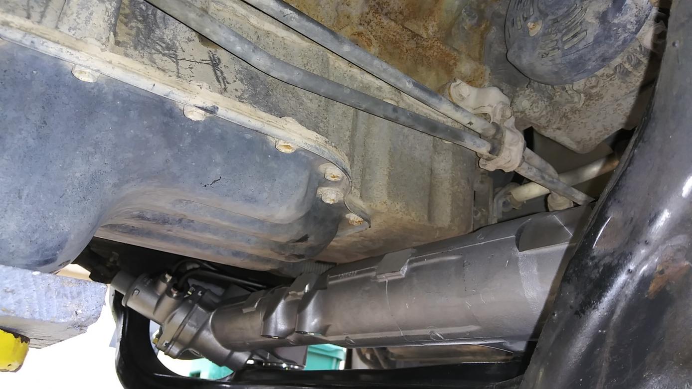

Took a cut off wheel to the TC hoop and the bump stop horn, to make room for the DK kit. 36 grit Flap disc is knocking down the rough stuff pretty well.

OK, here is some pics of the new MM w one of my homemade spacers and the clearance gained between the pan and the rack. It's not quite a 1/2", but it's close and it will be plenty of room.
Initial measurements are pretty good. It's centered side to side pretty well judging by the boots lining up with the outside of the frame, and each mounting boss is within a 1/16" measuring the yaw position off the core support.

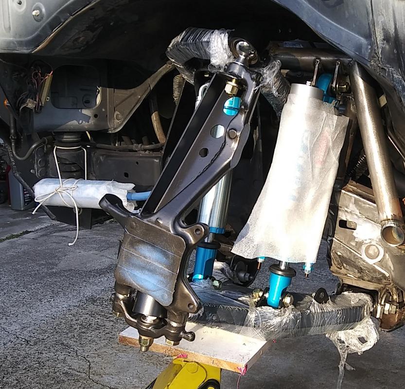

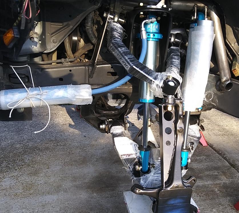

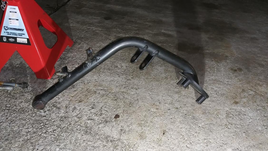

Dirt King Long Travel +3.5"
Mocked up the driver side to cycle it through and get my hydros and limit strap spacing sorted out.
Full compression will put the UCA almost into the inner fender well, so I'll most likely bump 1 to 1.5" short of that.
Looks like about 12.5" of travel might be possible.
Still a lot of welding and painting to do.

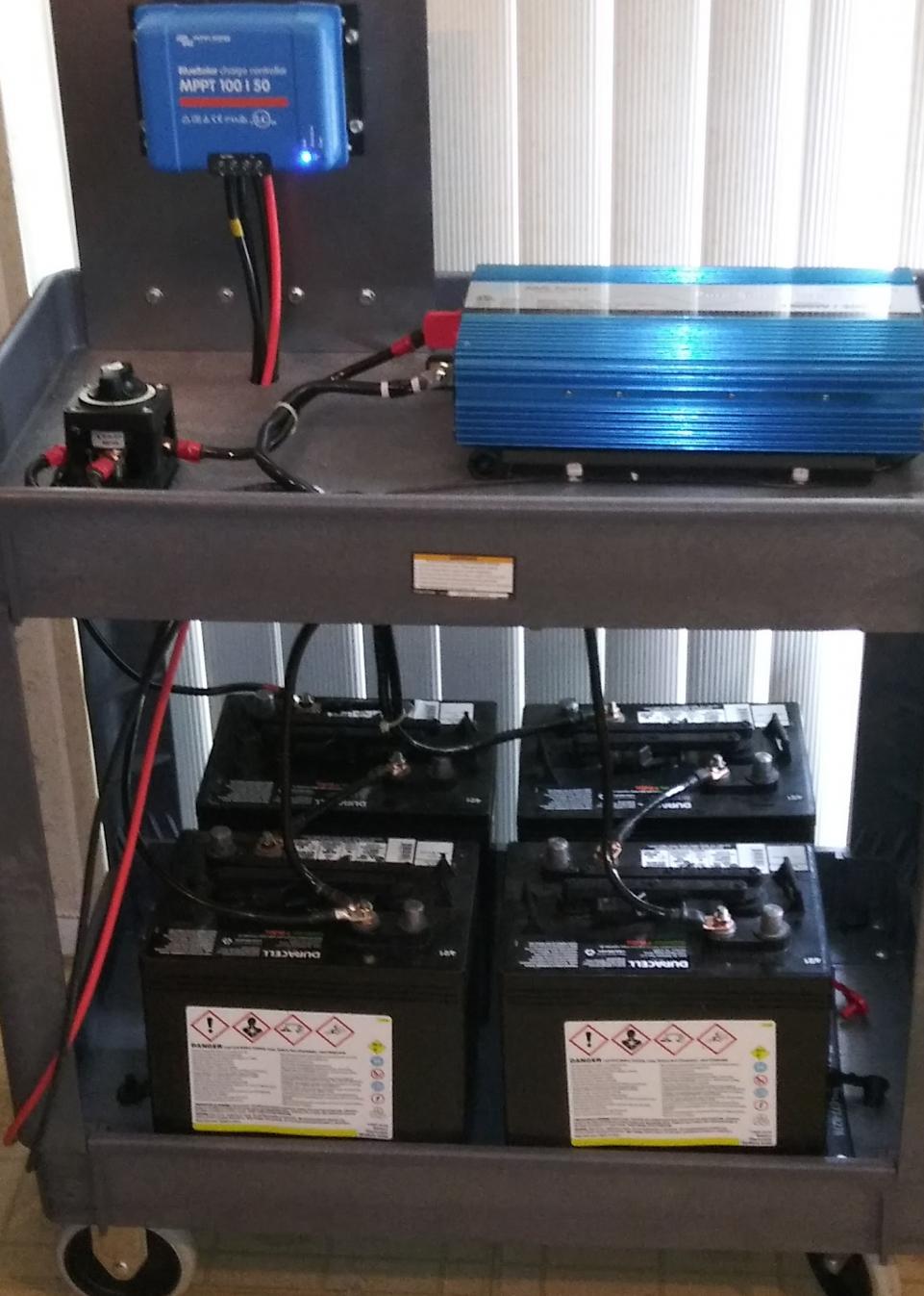

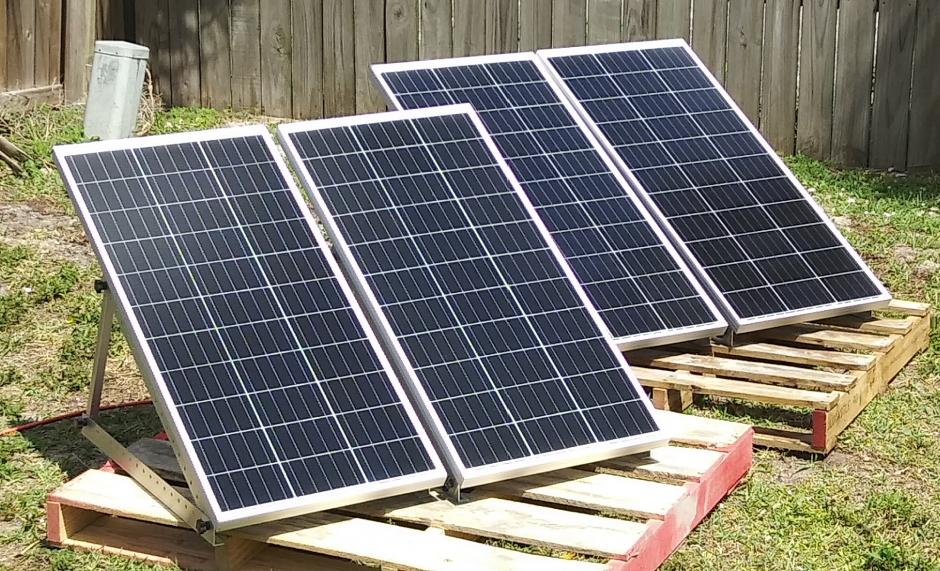

My Son and I got our Solar system operational today, so we will hopefully have a fridge during Hurricane power grid outages.

That solar panel setup is awesome man! Especially where you are I'm sure you can take pretty awesome advantage of it if ever needed!.
