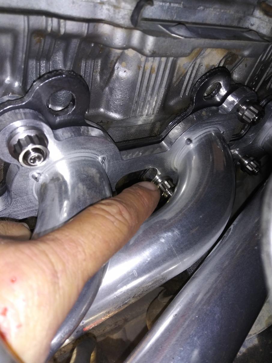

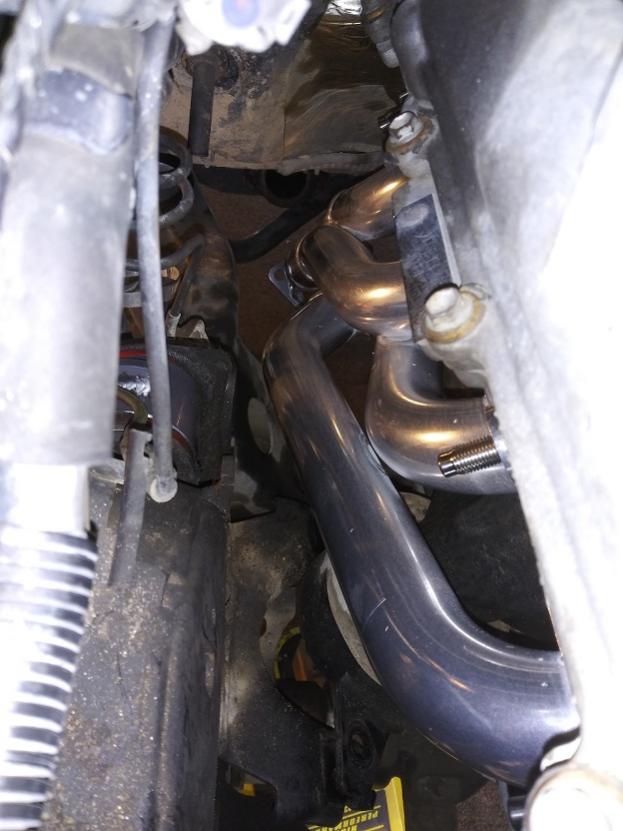

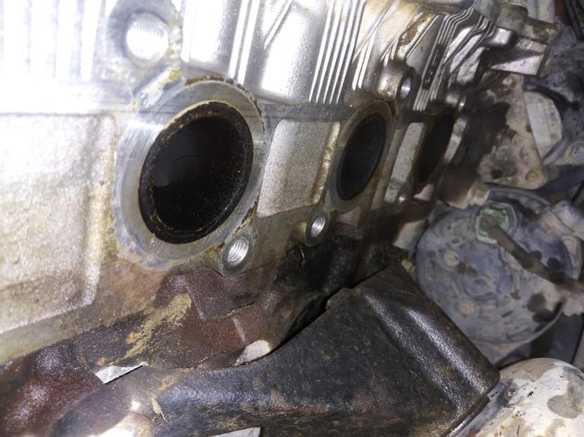

So with the engine jacked on the passenger side I kept working on that side. First cleaning the heads with some emery cloth and then installing the Titanium studs.

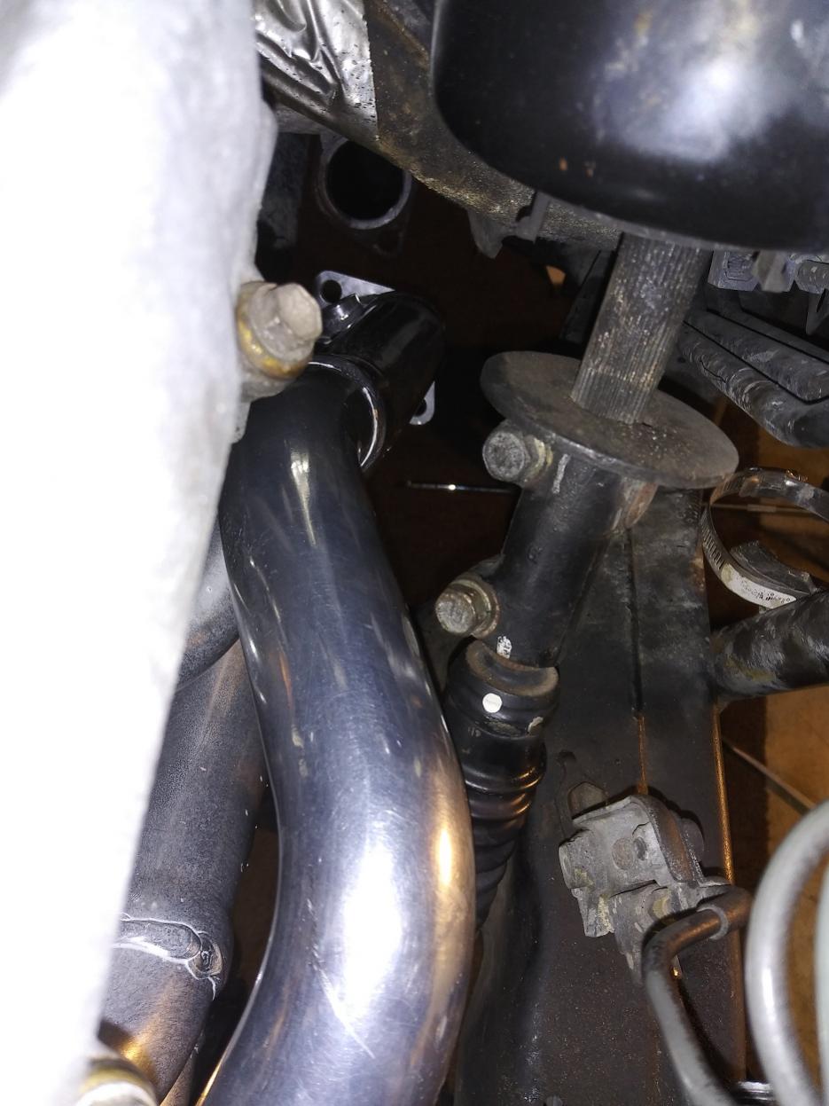

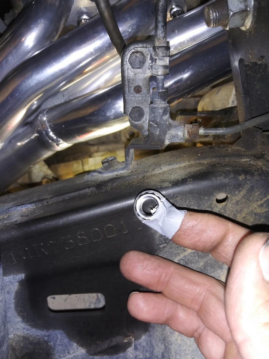

Next up was installing the dipstick tubes while the header is still loose. This one kicked my ass because for some dumb reason I tried to use the old path for the oil tube. I read the instructions, but it didn't sink in. You have to bend the tube quite a bit and at one point it looked like an old twisted up rope. It was late so I got some rest and with a clear head, my dumb ass realized the obvious path. So I bent the tube as straight as possible and started over lol. DT provides an extended mounting bolt and spacer that works pretty well.

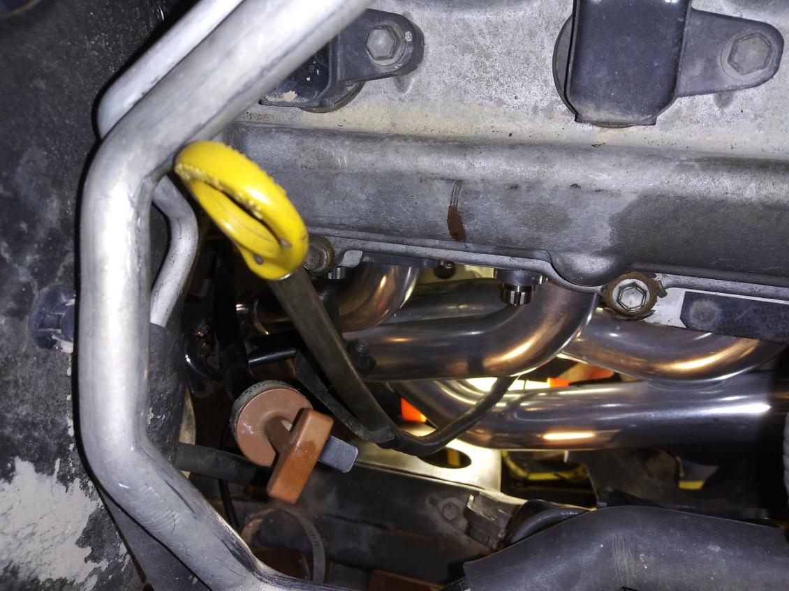

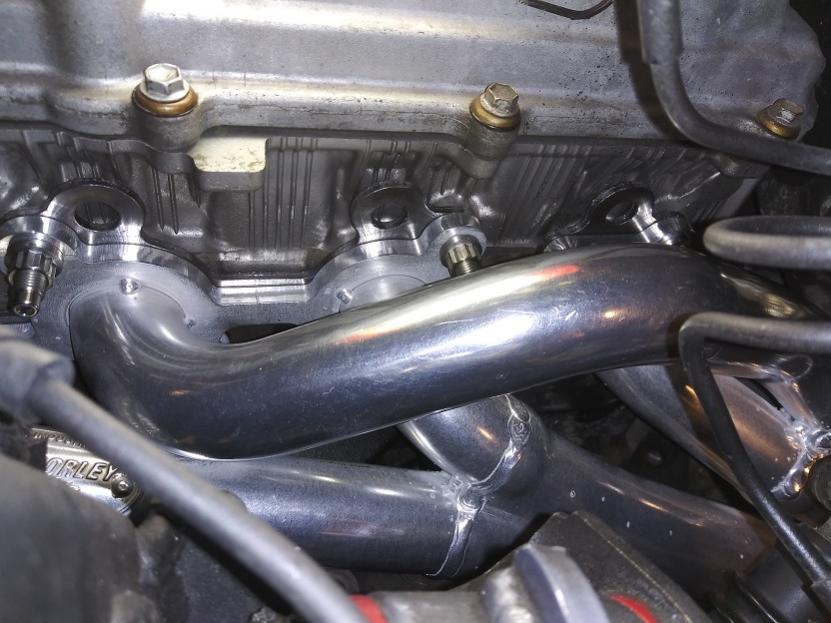

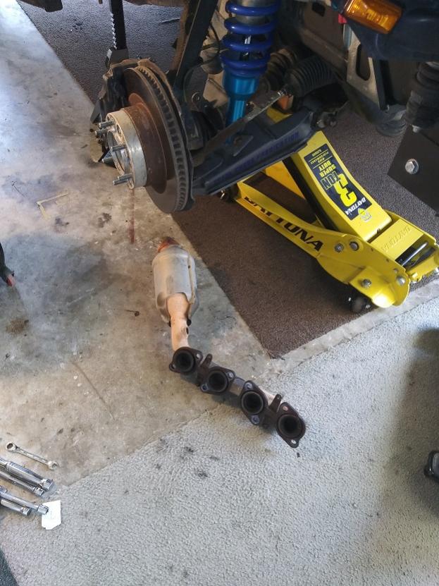

The driver side proved a little more challenging for access to the front bolt of the motor mount and a couple of the oem manifold bolts, as well as jacking up that side of the motor because of the differential, steering and accessories in the way. Everything worked out OK and the Sea Foam did it's job as well. NO BROKEN STUDS!!!!!!!!! All 16 came out pretty well. Here is the driver side as well as a clearance shot of the steering. Apparently there are some folks that have had some issues, mostly with the shorty tubes I guess. I don't see an issue here at all.

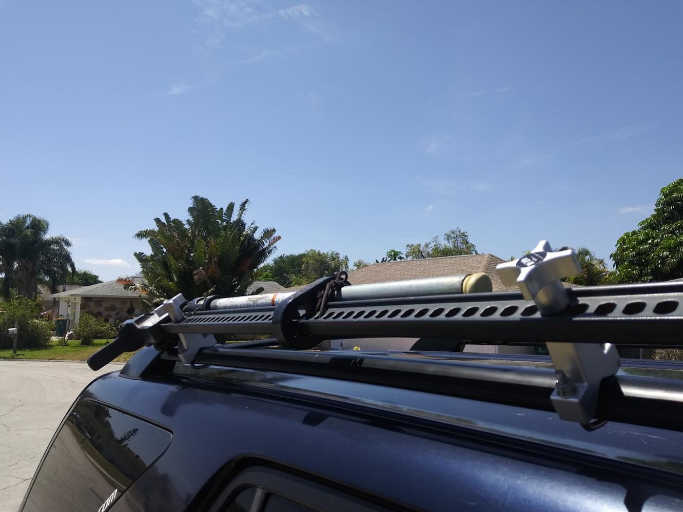

[MENTION=149207]AuSeeker[/MENTION] was making fun of the audio on my video sounding like a can of rocks bouncing around in there. So I eliminated a little bit of the noise today. Really wasn't a good idea to have a Hi Lift inside the cab anyway.
Yeah I was having a little bit of fun by mentioning a can of rocks but I was truly wanting to know what was making all the noise.
And I agree that if possible to not have the jack inside the truck is a good move, it would make a great missile if it wasn't securely tied down if you had to do a panic stop or got into an accident, so you get a 1st place trophy for putting it outside up on top. :first:
