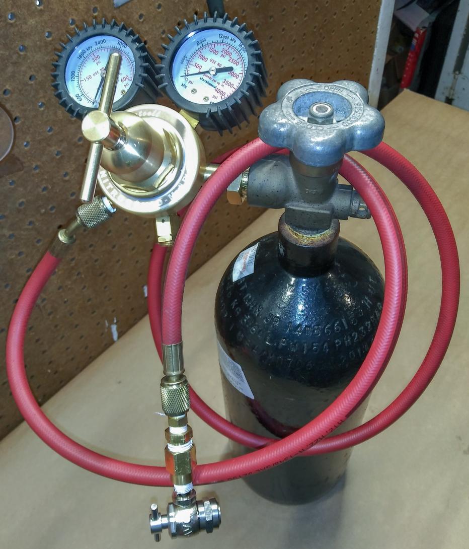

Put my Nitrogen rig together. All six kings were down in pressure and the secondaries were @ 0 psi. I never checked them before, I guess they were shipped that way. Should be some improvement.

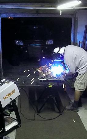

Practice. I think I need a taller table though. There's reason a good welder/fabricator is well paid. Lots of respect for them.

If you want to learn a little more I would recommend weldingtipsandtricks youtube channel. Mostly tig welding but with tig welding you can easily see everything and you can transfer the knowledge to mig. I think its helpful to see close up arc video, kinda hard to see what you're doing with mig.
Yes Sir! Already subscribed a few months ago. He actually has a 7 or 8 part series called Mig welding basics from 6 yrs ago that I've been watching. Likeable guy and his camera work is pretty damn good. I figured out this old Hobart has a pretty fast wire speed by watching his stuff. Helped me out a lot. And he etches his welds to show why certain welds aren't acceptable.
Tell me about your nitrogen set up. It's finally time for me to put something together. It looks like most kits (regulator, hose, chuck) are around $200 or so. Is that a good way to go or gather the parts myself?
What I did was gather the parts because I already had the high pressure hose from an old A/C manifold set up. But the initial nitrogen tank purchase is at least a 1/3 to 1/2 of the cost, so that was part of the motivation to do it myself. The good thing is there's really not much volume to speak of in the reservoirs, so the gas will last quite awhile. I really don't know where to source the hose unfortunately. I had to buy some odds and ends fittings at ACE to put it all together. I do like putting stuff together myself so it appealed to me to save a couple of bucks too. The chuck and manifold are listed below and a You Tube vid that Ben Brazda from Filthy put out, he goes over the nitrogen refill at the end. Always check pressures and fill your shocks at full droop, so you have to jack her up. Hope this helps!

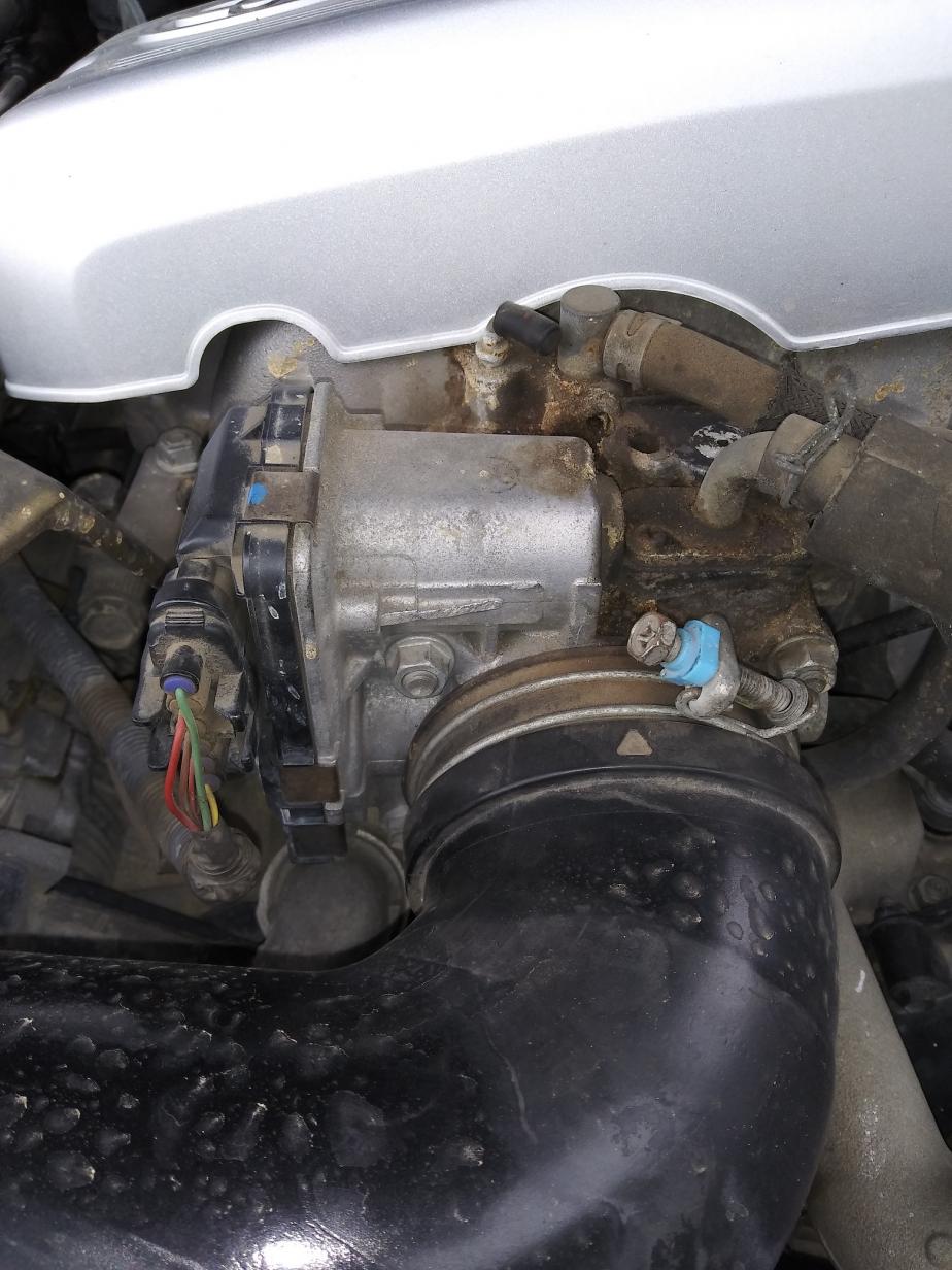

I never knew about the bypass that's a good idea here in Florida. I was posting a pic to link in a msg to [MENTION=459231]xtremewlr[/MENTION] about the 05'+ plastic intake and throttle body mod he mentioned in Sherpa's thread a couple months ago. I was thinking about doing this finally. Other than being dirty as hell, this is working OK.
So I'll post my response that I just sent you so other people can see the difference in the TBs as well.
They are very similar, yes. But the 03/04 TB won't fit the plastic intake. I forget exactly why and of course didn't take a picture but there was some sort of interference or it was the bolt holes that didn't line up correctly.
First, this is how the 05+ TB would normally be installed. Unless you want to extend the TB wiring, it's simpler to just flip it upside down so your existing wiring harness will simply plug in.
Here are pics of each, side by side, mounted on the respective intakes. The TB on the plastic intake has bee flipped already and is how it's installed on my 4Runner right now.
There is also about a 12.5lb weight difference between the aluminum intake and the plastic, so the weight loss is a bonus with doing the swap.
You also need to get the fuel rails for the newer intake, or at least the front crossover pipe since the aluminum intake version goes under the TB and the plastic intake version goes over the intake. I tried fitting the alu intake version first and it wouldn't work. I think the fuel rails by themselves are the same but one side had different bolt hole locations. Best just to get the newer fuel rails and not have to fiddle with trying to make it work.
I highly advise replacing both fuel regulators on the fuel rails with new ones while you are doing the swap. Also a good time to check out the starter while you have access. Fuel injectors can be reused or you can spend the extra and replace them with 12 hole injectors like I did. I didn't see any performance or mpg gain with the new injectors tho.
I have a lot more pictures and details in my build thread on tacomaworld but feel free to hit my up with any other questions about doing the swap.
