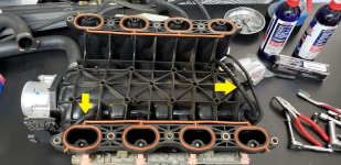

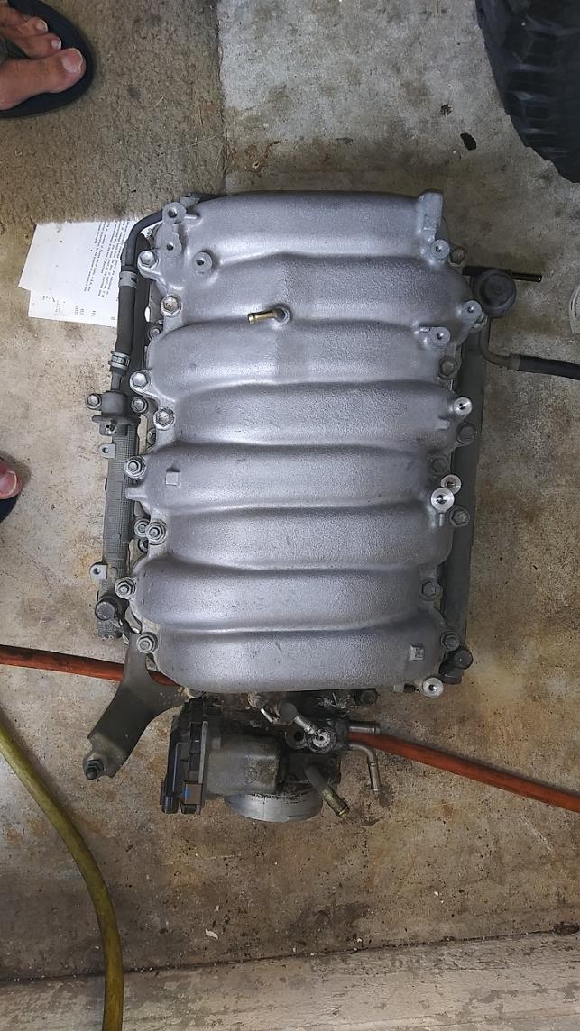

So I'll post my response that I just sent you so other people can see the difference in the TBs as well.
They are very similar, yes. But the 03/04 TB won't fit the plastic intake. I forget exactly why and of course didn't take a picture but there was some sort of interference or it was the bolt holes that didn't line up correctly.

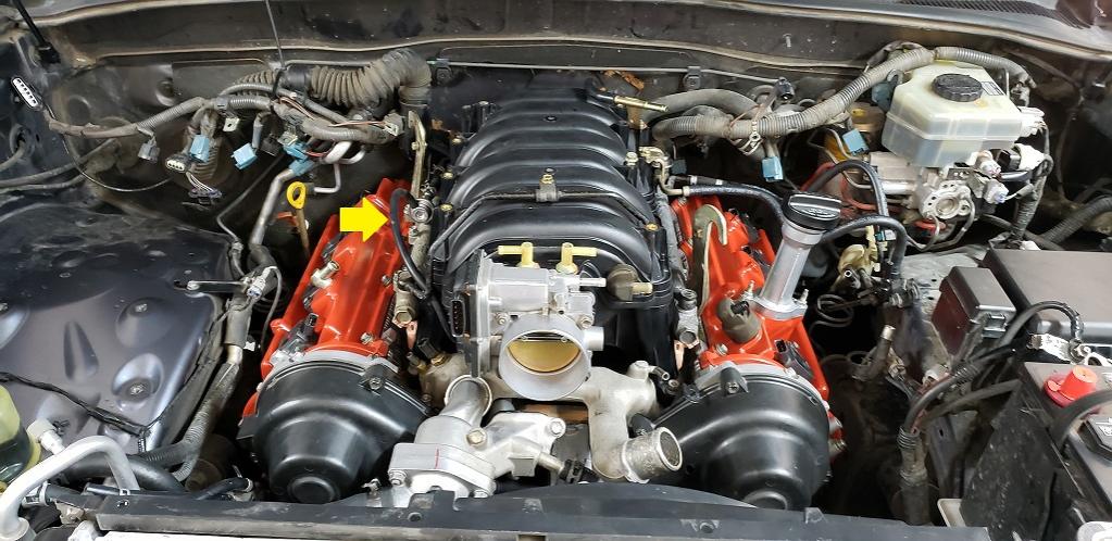

First, this is how the 05+ TB would normally be installed. Unless you want to extend the TB wiring, it's simpler to just flip it upside down so your existing wiring harness will simply plug in.
Here are pics of each, side by side, mounted on the respective intakes. The TB on the plastic intake has bee flipped already and is how it's installed on my 4Runner right now.
There is also about a 12.5lb weight difference between the aluminum intake and the plastic, so the weight loss is a bonus with doing the swap.
You also need to get the fuel rails for the newer intake, or at least the front crossover pipe since the aluminum intake version goes under the TB and the plastic intake version goes over the intake. I tried fitting the alu intake version first and it wouldn't work. I think the fuel rails by themselves are the same but one side had different bolt hole locations. Best just to get the newer fuel rails and not have to fiddle with trying to make it work.
I highly advise replacing both fuel regulators on the fuel rails with new ones while you are doing the swap. Also a good time to check out the starter while you have access. Fuel injectors can be reused or you can spend the extra and replace them with 12 hole injectors like I did. I didn't see any performance or mpg gain with the new injectors tho.
I have a lot more pictures and details in my build thread on tacomaworld but feel free to hit my up with any other questions about doing the swap.

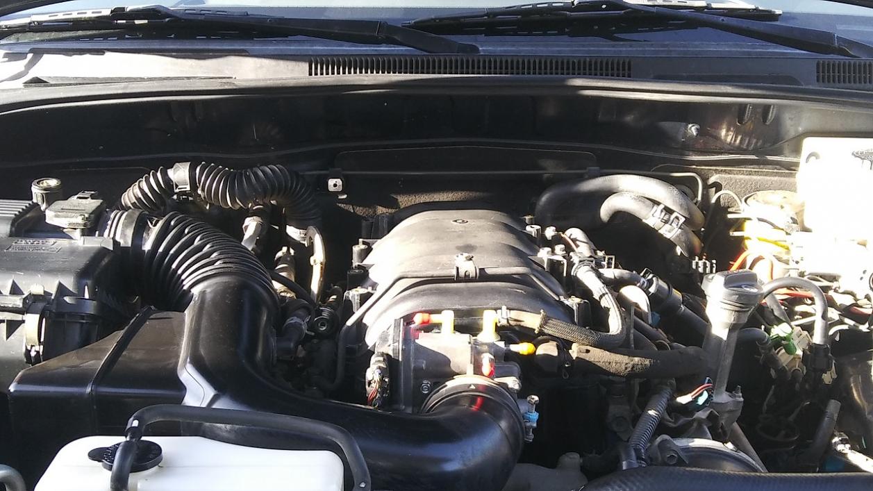

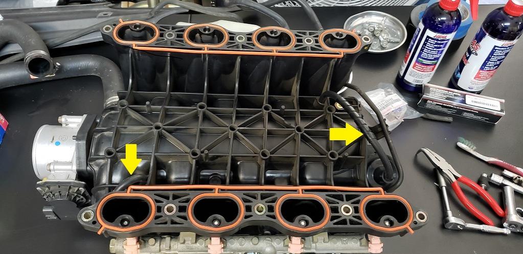

I finally might have some time to do this intake swap. Going through all the parts and comparing to your posts. I noticed two vacuum ports on the underside and see where you have them routed. The one in the rear loops out to the runner diaphragm and the other looks like it goes to the pressure regulator. Included some pics.
Just want to make sure where these hoses need to terminate. I see the regulator hose goes to the intake on my aluminum, and it looks like yours does also in one of your other pics.
Gonna go back and look at your thread on TW to make sure again what I'm looking at.
Also tried to find some diagrams in the service manual without any luck.

Sorry for the slow response. Just got home from a weekend of wheeling and camping in norther AZ and up into southern Utah for a minute.
The rear vacuum line is exactly as I show in that pic there. The front one I ended up running the the vacuum port on the front passenger side below the intake. There's a dual vacuum port switch thing there (forget what it actually is right now) that has one line to the intake tube and another to the intake manifold. The regulator I used the stock vacuum port on the intake tube.
Edit: That S shaped hose on the top of the intake was only used until I got vacuum caps that fit.
No worries, I figured you were out on the prowl this weekend. It's been way too long for me, but I'm glad to have a full schedule again.
OK I wasn't sure those were vacuum ports under the intake or not. The dual port switch on the front pass side is for the power steering power up feature I believe.

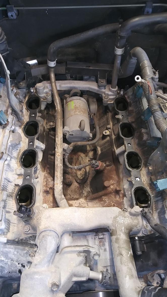

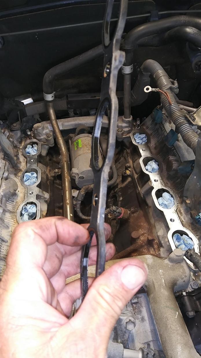

Got the intake pulled. About a pound of sand under there.
Took awhile to get the starter out, serious PIA. Toyota engineers were gettin cussed this afternoon.
Never have seen an intake gasket like this one. Composite sandwiched between two metal pieces.
Noticed that the 05' Throttle body opening is almost 5mm larger in diameter than the 03'. Hope that equates to some Torque on the low end.

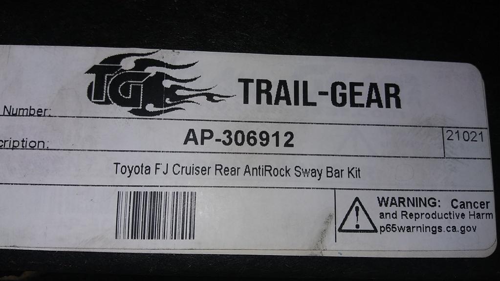

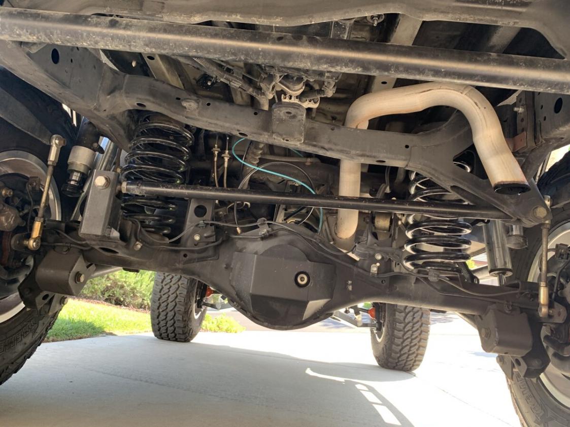

Can you post some pics of how the Antirock sway bar in the rear is mounted? It's something I've been considering doing to mine. Also, what length arms and width is it?
No, that makes sense. I forgot you had a real exhaust. I'm still running stock shit for now.
The picture above is of the axle I bought off Race Dezert from a super good guy in San Diego. It has Nitro 4:56s and an ARB locker in it with modified link tabs and lower shock mounts all set up for what I want to do with the LT. He made me a deal and got me a great price with his shipping dept at work. So I couldn't pass it up.
That pic is actually when it was still on his 4th gen, but he kept his anti-rock for the new custom build he was getting from Currie. He said the FJ anti-rock bolts right up.
Other than that I got nothing, except the part# label off the one I bought from Trail Gear. I hope to start this axle swap soon, but you know how time gets away from us. I'll try to keep you posted on how the Anti- Rock goes together, but hell the way you move, you might get to it before me.
