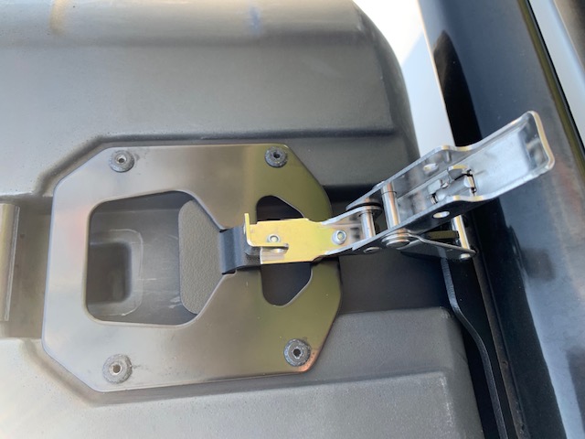

Con's: Cumbersome to handle without two people, latches that attach the case to the roof mount have very small holes for locks. The locks that fit these holes will only delay theft, not prevent a serious attempt. Price. It did not fit in my garage while mounted to my rack. Admittedly, I have an older house and new houses have taller garage doors. Finally, it does not fit flat on the floor of the 4Runner cargo area (I know not typically how you'd haul it).

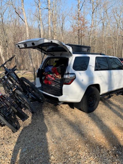

I've taken this on a 1400 mile road trip through rain and on the beach. No issues with rain or dust penetration. This case appears to be built to the level that one would expect from Pelican, and for the price.
Size:

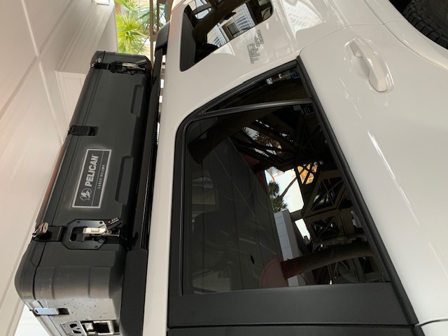

The box is about four cubic feet. You can lift it yourself, but the reach is awkward, especially when fully loaded. It's nearly twice as big as the next largest roof mount Pelican cargo case - the BX90R. On the other hand it's not as big as a Yakima or Thule roof top case, although much easier to get on/off. The size is great for the bulky light weight camping equipment - sleeping bags, pillows, etc. Generally I also have my recovery gear in here as well.
Mounting/dismounting

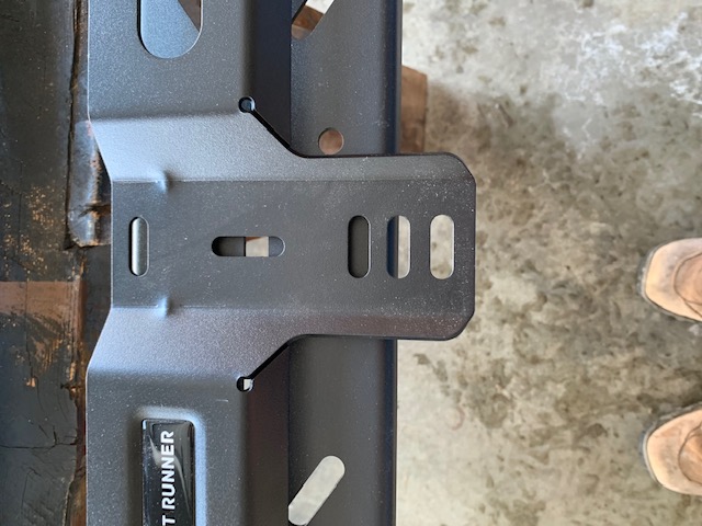

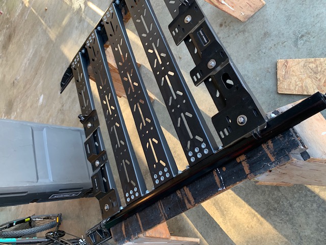

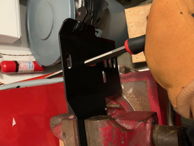

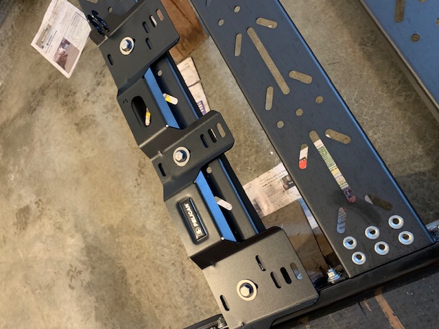

I purchased the Front Runner mount to attached to my Rago cross bar system. I had to do some slight filing of two holes to make them work, but overall not a big issue. Once I had the Front Runner mount attached getting the case latched in is a breeze. This is truly a great system. The ads say you get get it from latched to off the vehicle in 14 seconds and they are just about right. I didn't do any time trials, but it's close. On the down side, as mentioned above getting the case up above your head, while fully loaded and not hitting your car takes some work but is possible. With two people, it's not a problem. The other note is that while the case itself can fit reasonably strong/thick padlocks, the latches that connect the case to the mount have tiny little holes that basically only fit a tiny TSA cable lock. This is an area for improvement, but I still generally felt safe leaving it up there unattended.
In total, I like the case and the mount. I bought it primarily for camping and it does the job well. I would also strongly consider the BX90R, but then again 2.5 cubic feet isn't the same as 4.

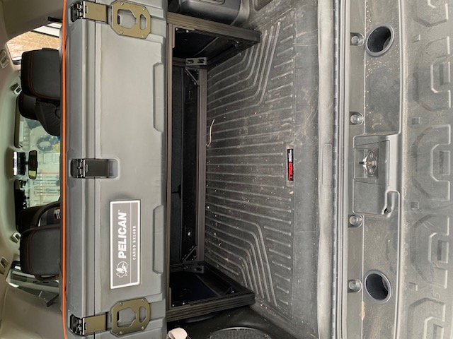

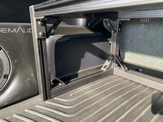

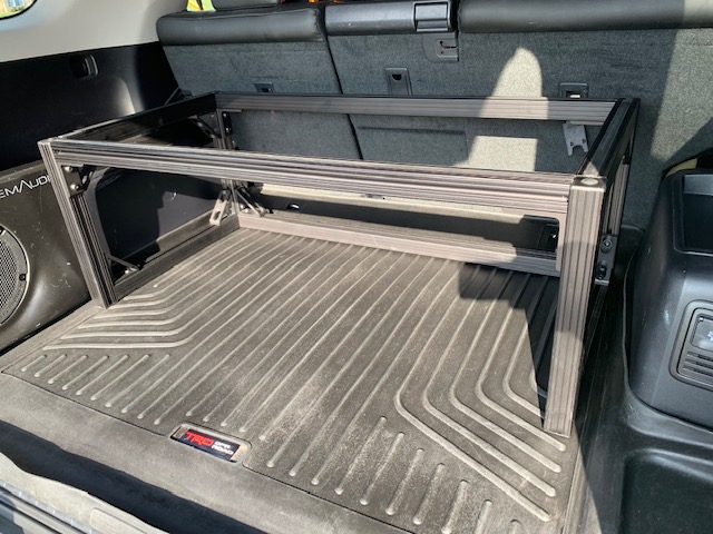

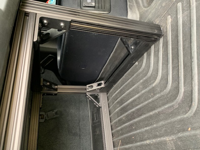

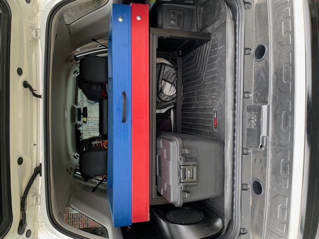

Interior Storage Of the Pelican BX140R
As I mentioned in my original post, this cargo case does not fit flat on the floor of the cargo area of the 4Runner. I wanted to have an option where I could keep it in the vehicle most of the time and put it up on the roof mount when needed. In retrospect, it's a bit cumbersome to do that often. I keep it in the vehicle most of the time with my recovery gear inside and only throw it up on top if I need the cargo space for camping, etc.
The shelving / support system I designed to hold it was made with 80/20 extruded aluminum. As mentioned in other threads this stuff is awesome, but expensive. Particularly all the hardware. I believe T-Nuts has it cheaper and would investigate that if I had it to do over again. Speaking of things I'd do differently, I'd design it to have the long cross bars sit over shorter vertical supports instead of having them use hardware to attach into the side. Otherwise, I'm happy with this design.
A couple of notes: I designed it to be able to fit my Plano cases or suitcase underneath. The support system is not as deep as the case and this does cause it to slide off if I hit the gas hard without anything else in the back. However, this was a design choice because I wanted to fit my RTIC 20QT cooler behind the rack and still be able to close the tailgate - which it BARELY does.
