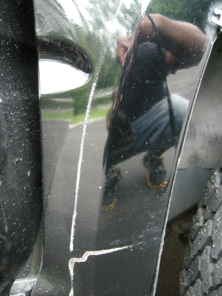

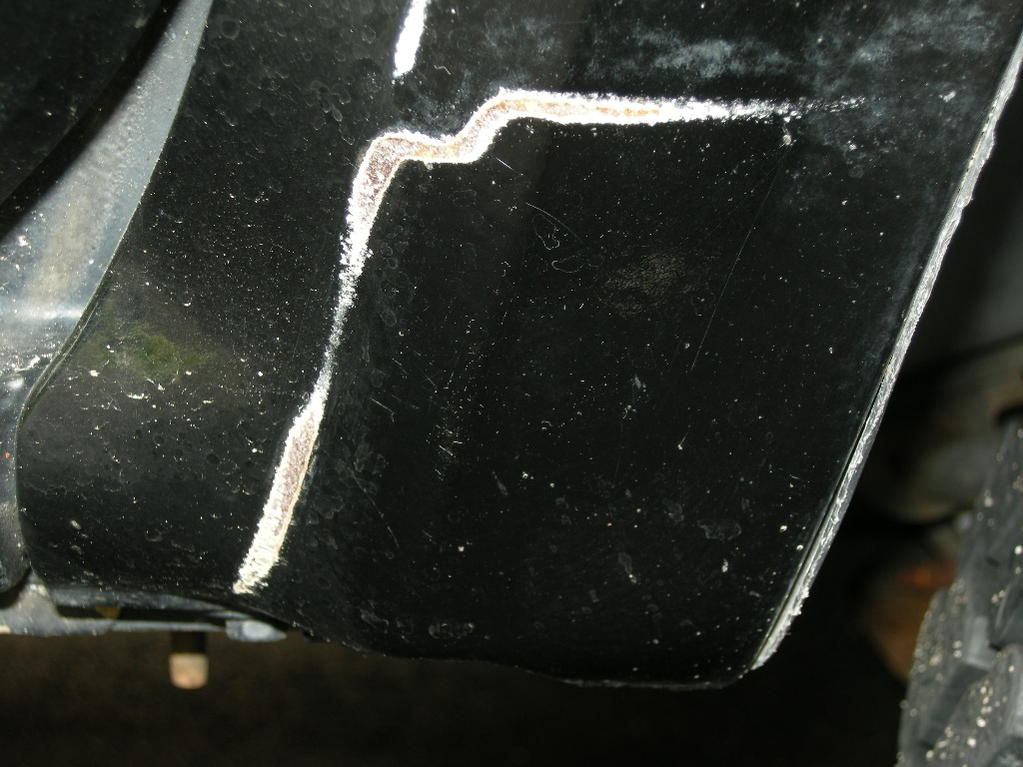

you mean like these marks?
Yeah,I think we all have them... I have them on all 4 corners. When i took my RB'S off I almost fainted.it's a good thing i ordered my bushwacker extenda flares they will be installed on thurs with my lift ..
Now, on the other hoof if the BW'ers DONT cover these marks you will hear a semi grown man scream... or cry.. or both

I too had the rub marks. Bought the mud-flaps mentioned earlier and they fit great. A word of warning though, if you have a lot of miles the bottom fender bolt will probably be rusted out and break off. I ended up having to drill mine out and use a long self tapping screw instead of the bolt they give you in the kit. Other than that it was a pretty easy job.
