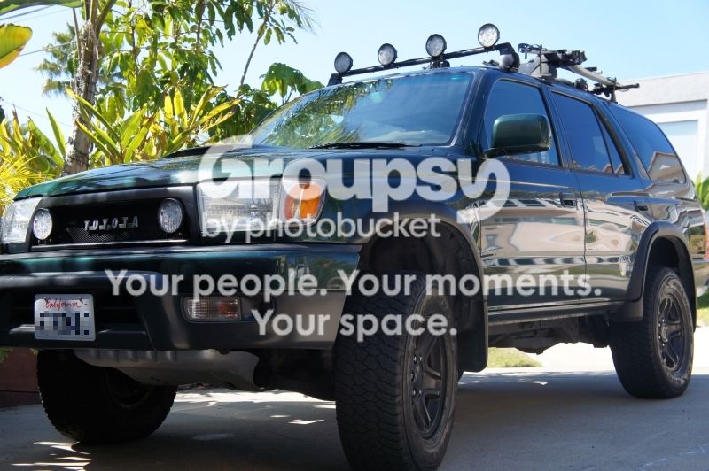

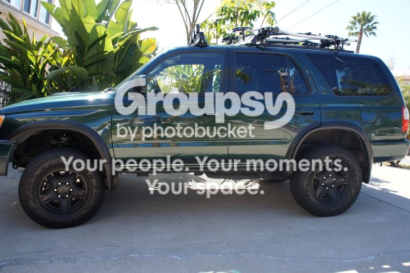

And here she sits today..
4runner002_zpsda100598.jpg~original
Here it looks like it has some reverse rake, but that is just because of my steep driveway. It actually sits very level.

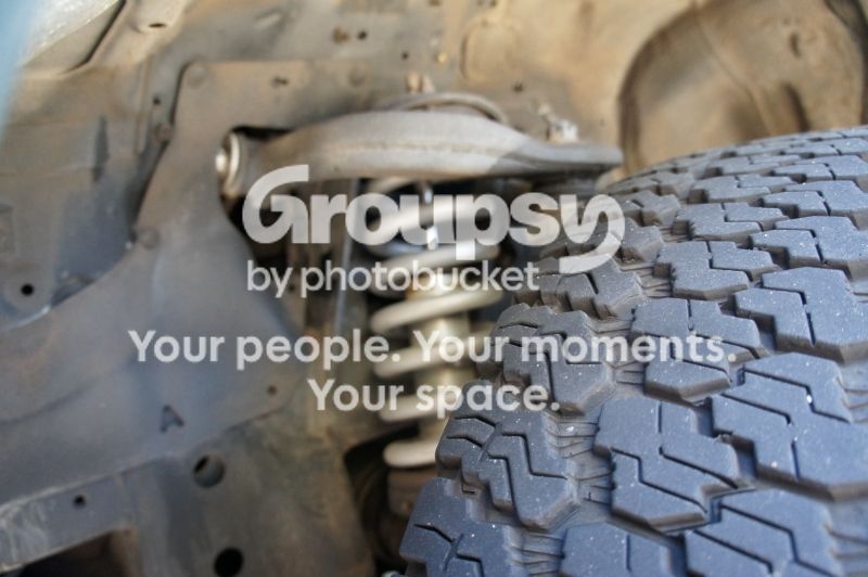

The Toytec coilovers have been great, I love the adjustability. And if I get a plate bumper one day, it will just be a small adjustment.

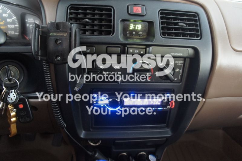

The Sony head unit is pretty cheap, but offers the features that are critical to me: a nearly flawless Bluetooth implementation, digital delay, digital crossover, high-voltage line output, and a remote mic input.

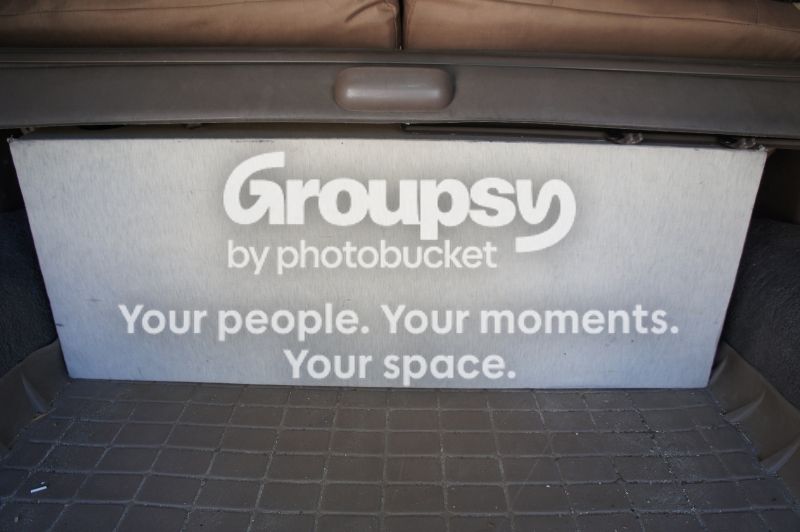

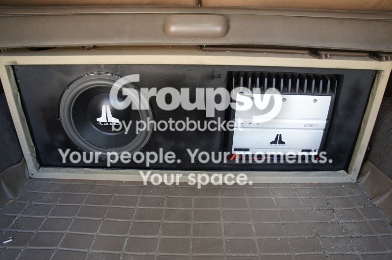

I built this ported sub enclosure to be tough, but also easily removable because it takes up a lot of cargo space. It is covered with ballistic nylon to take some bumps and bruises. I put handles on the sides (it is heavy) and used a 30A 110V plug and receptacle so that I could easily disconnect the power, ground, and remote on/off.
4runner011_zps7bd924f9.jpg~original
With the cover on, it blends in pretty well under the cargo cover, even when closed.

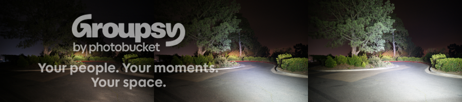

Wow Chris, this thing's come far since I picked up those 99 talls! I like the sub enclosure and the led's the grill! Got any night shots of the led's in action? Great job so far!
Thanks Evan! Your rig has come a long way too - it looks great - love the LC60 emblem!
I'll see about getting some night shots with the LEDs.
Snapped some quick pics of the lights in action. From left to right, high beams, high beams + front LEDs, high beams + front LEDs + roof LEDs. All images at 1s exp, f/4, ISO 400.
