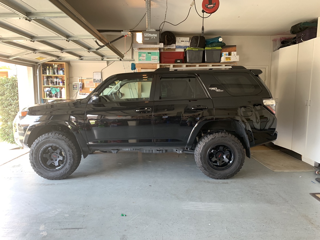

Here is my Pro with Cornfed 1.5/1” spacers added with 275-70-17’s. The Pro comes about 1” higher in the front over all 4Runner models. The rear is the same. So, this is ~2.5” F/1” R. I’m at 22.5” from hub center to top of fender arch up front and 23” in the rear. Hope that helps.

Perfect, thank you!

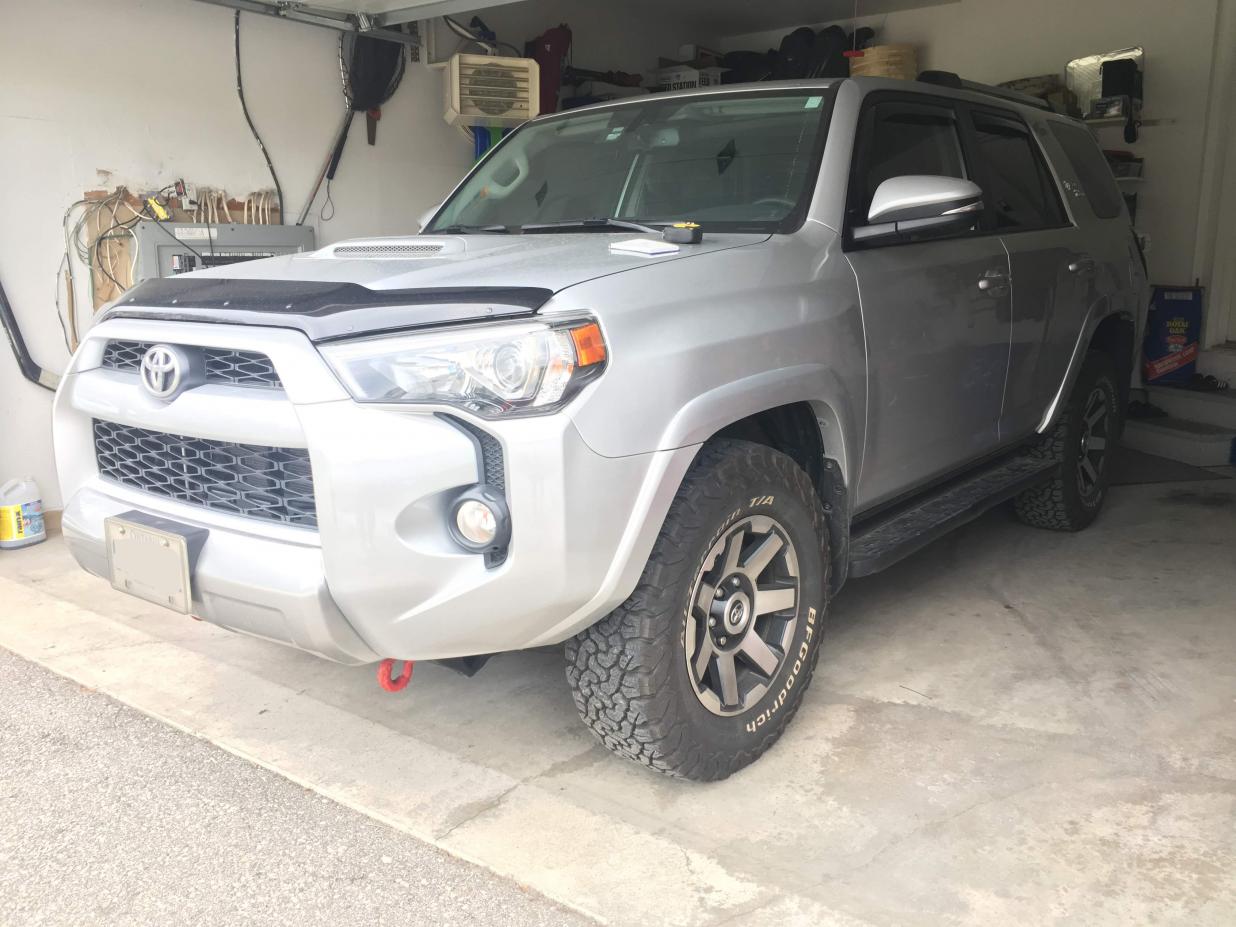

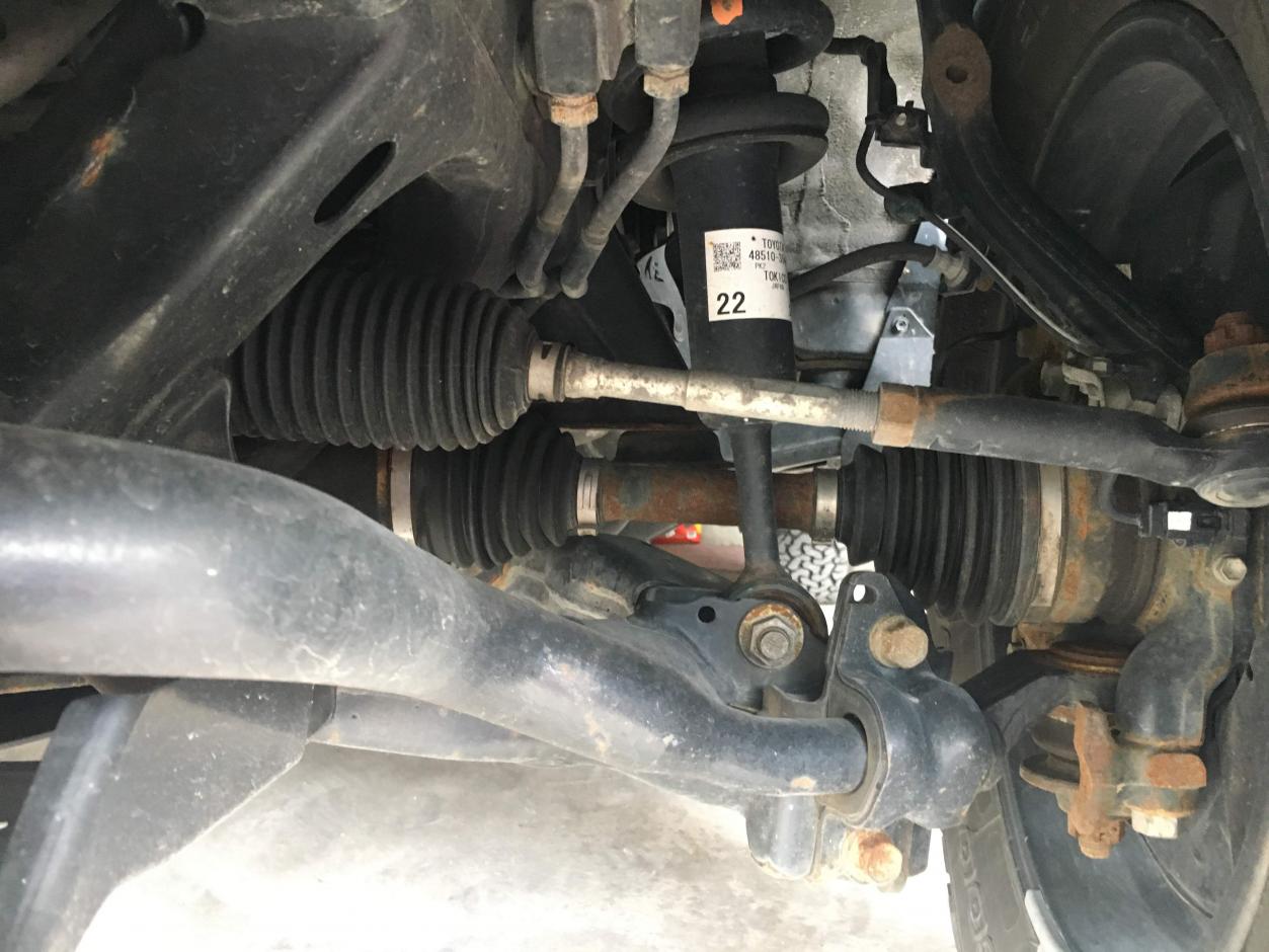

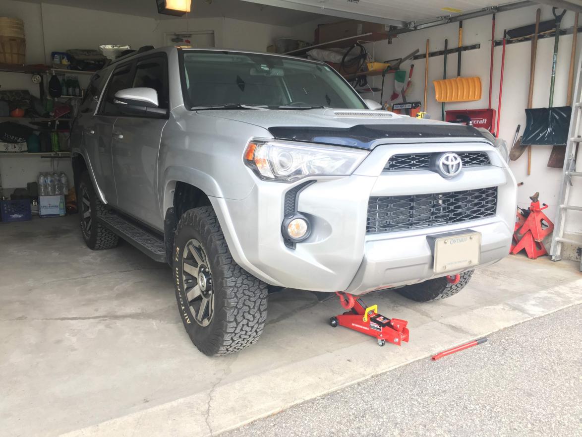

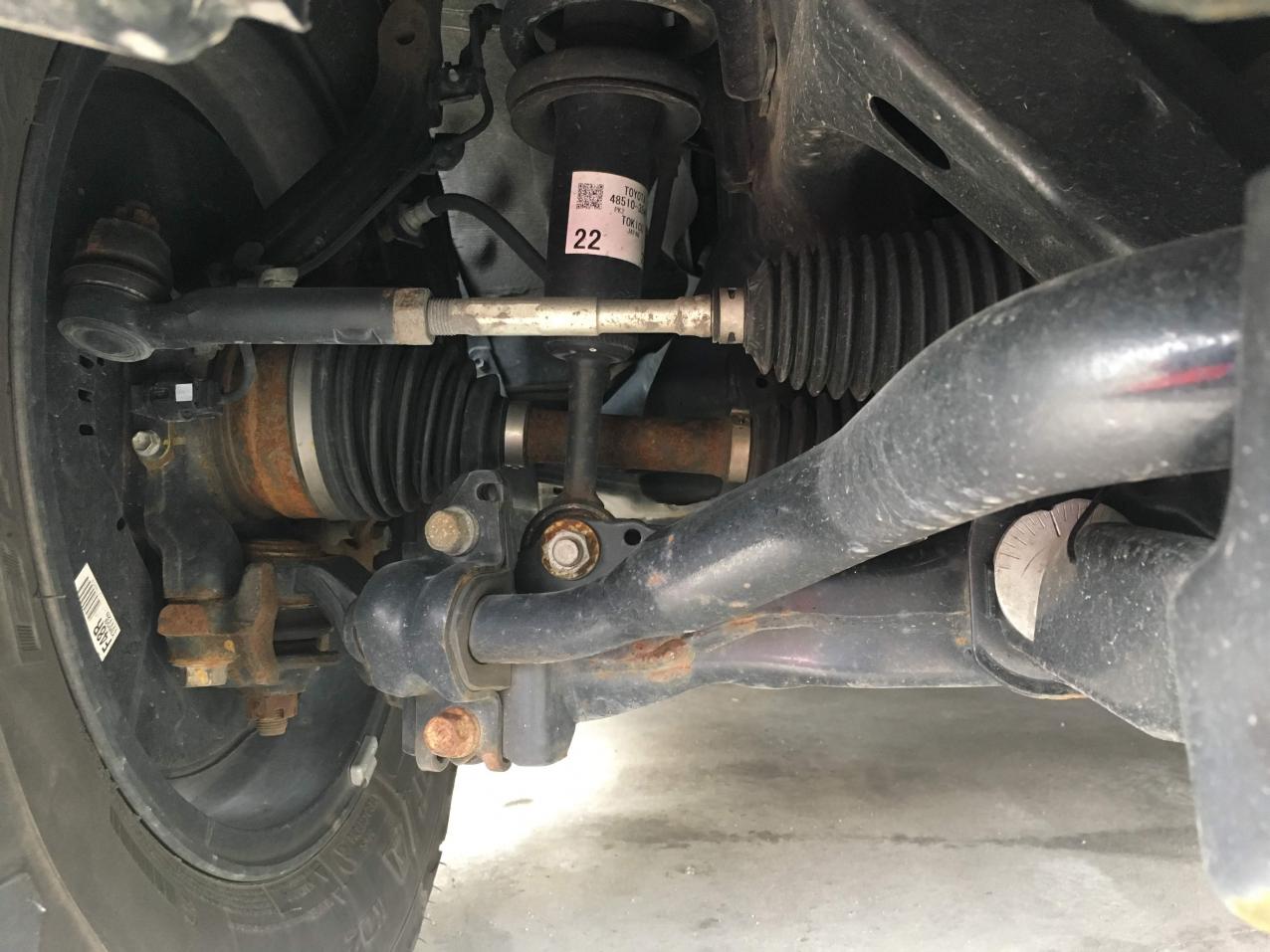

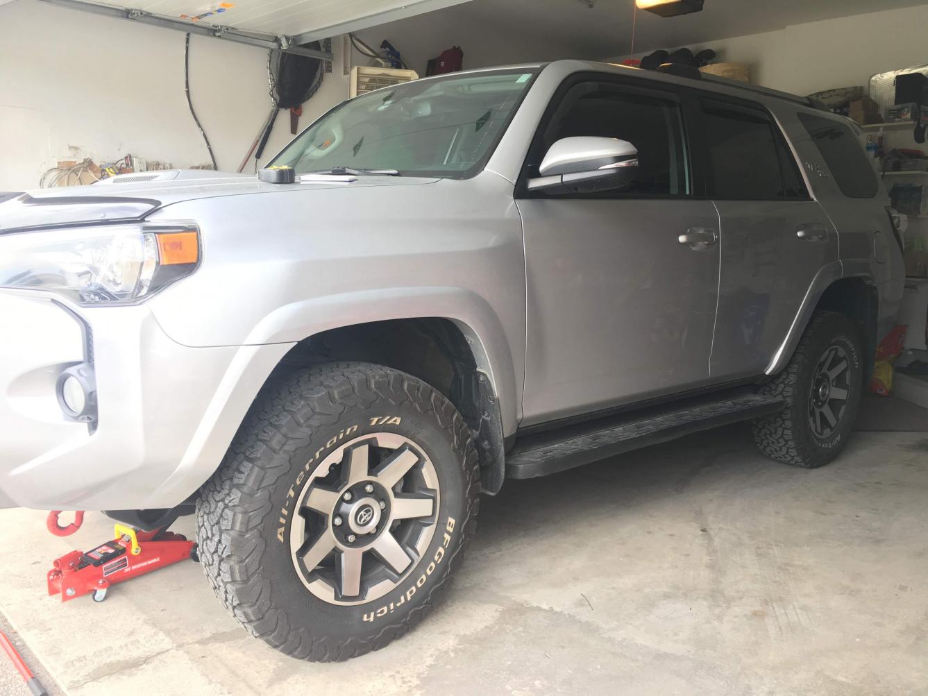

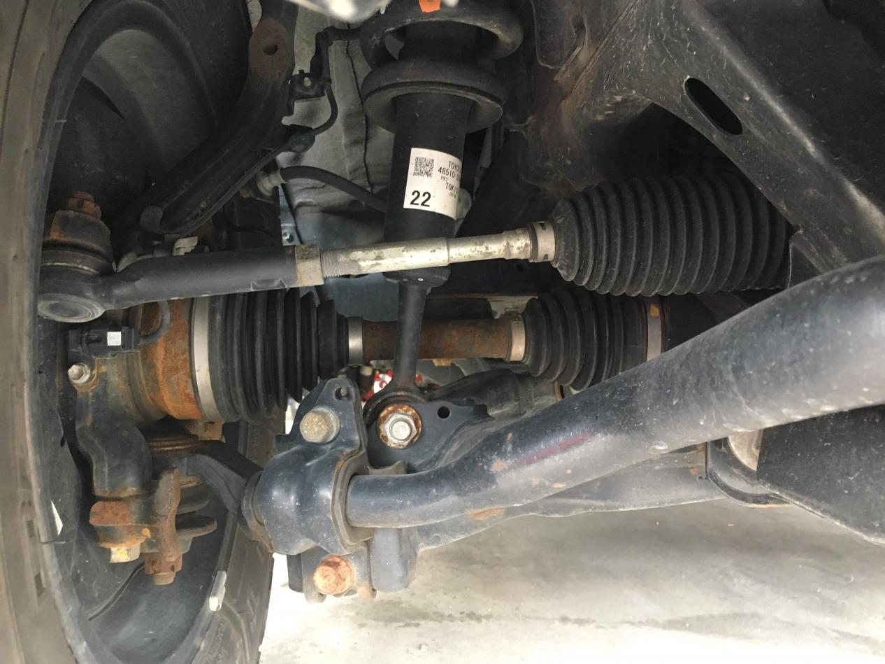

Bear with me on this one as I have never tried posting with pictures...
I tried simulating a 2.4" (5th clip 6112) front and 1" rear lift today to see how it would look.
I placed a jack under the lifting point on the engine skid plate and another under the tow hitch. Measured to wheel well before and added respective heights with jacks.
These are my before lift photos with stock cv angles.

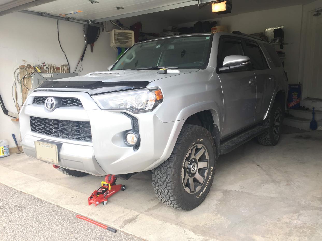

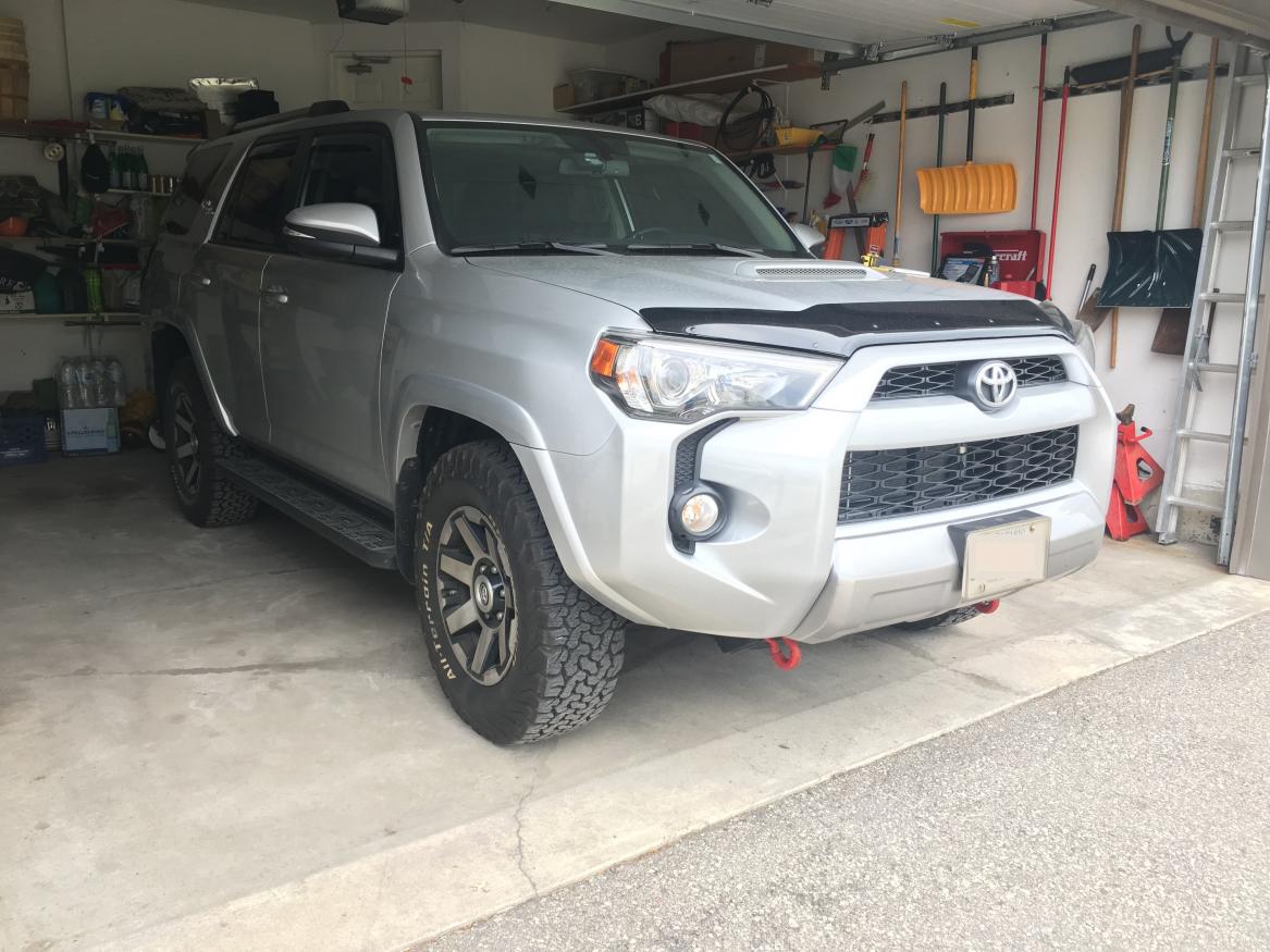

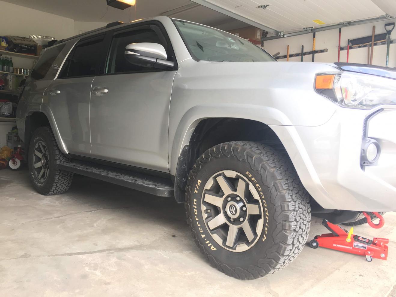

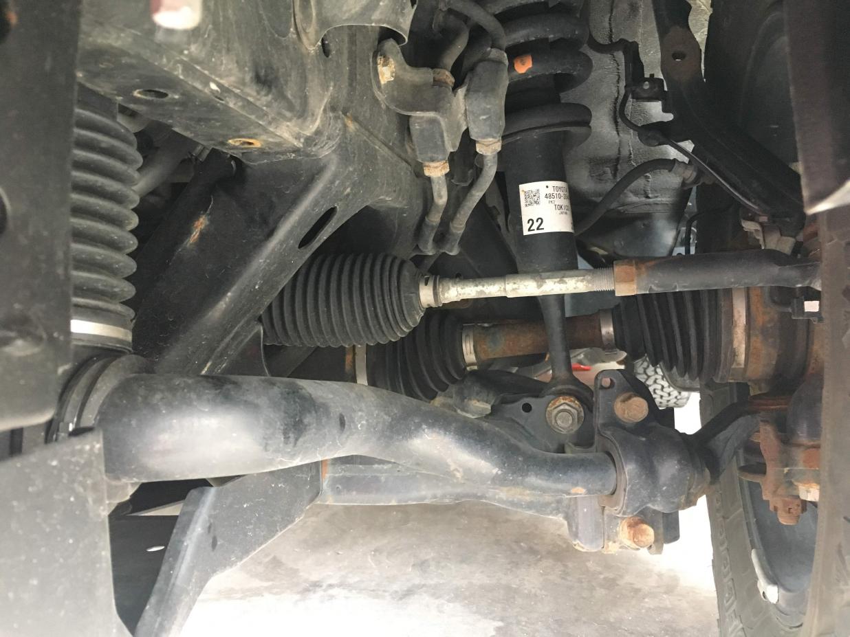

These are my after lift photos. Measurements are as follows (+/- 3mm or 1/8"):
2.4" = 61mm
1" = 25.4mm
Before
FL: 867mm
FR: 867mm
RL: 937mm
RR: 937mm
Frame variance front to rear = 20mm
Clearance to lowest point of front skids = 210mm
Clearance to lowest point in rear (gas tank, not including diff.) = 260mm
After
FL: 928mm
FR: 928mm
RL: 962mm
RR: 962mm
Frame variance front to rear = 10mm
Clearance to lowest point of front skids = 260mm
Clearance to lowest point in rear (gas tank skid, not including diff.) = 290mm
Forgive my use of metric units. I work in construction in Canada and am very comfortable with them.
