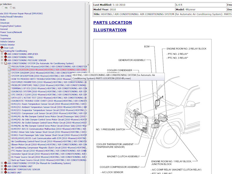

I'm looking at the manual, specifically the parts location for both the automatic and manual A/C systems, and I don't see a second fan but I do see a set of servos on the Auto that is not part of the Manual system. There is also a second temperature sensor on the Auto that the Manual doesn't have.

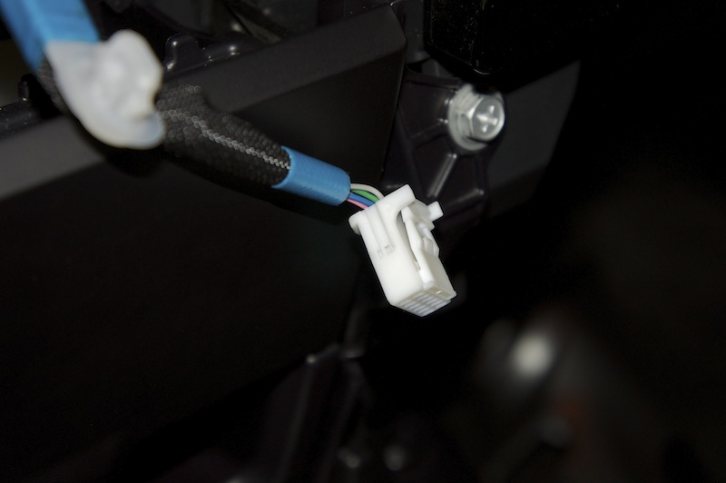

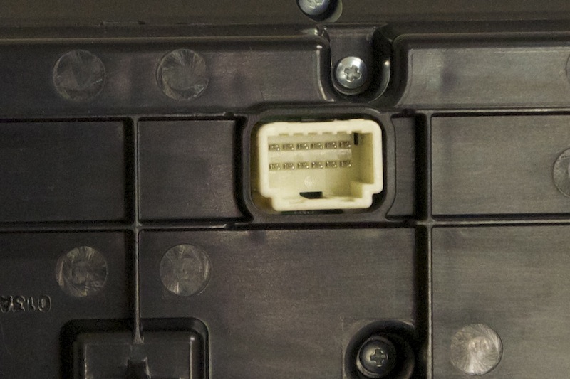

Here you go, I had the dash taken apart anyway looking for the numerous rattles, clicks, and ticks. Hope this helps. Btw it's a 12 pin connector.

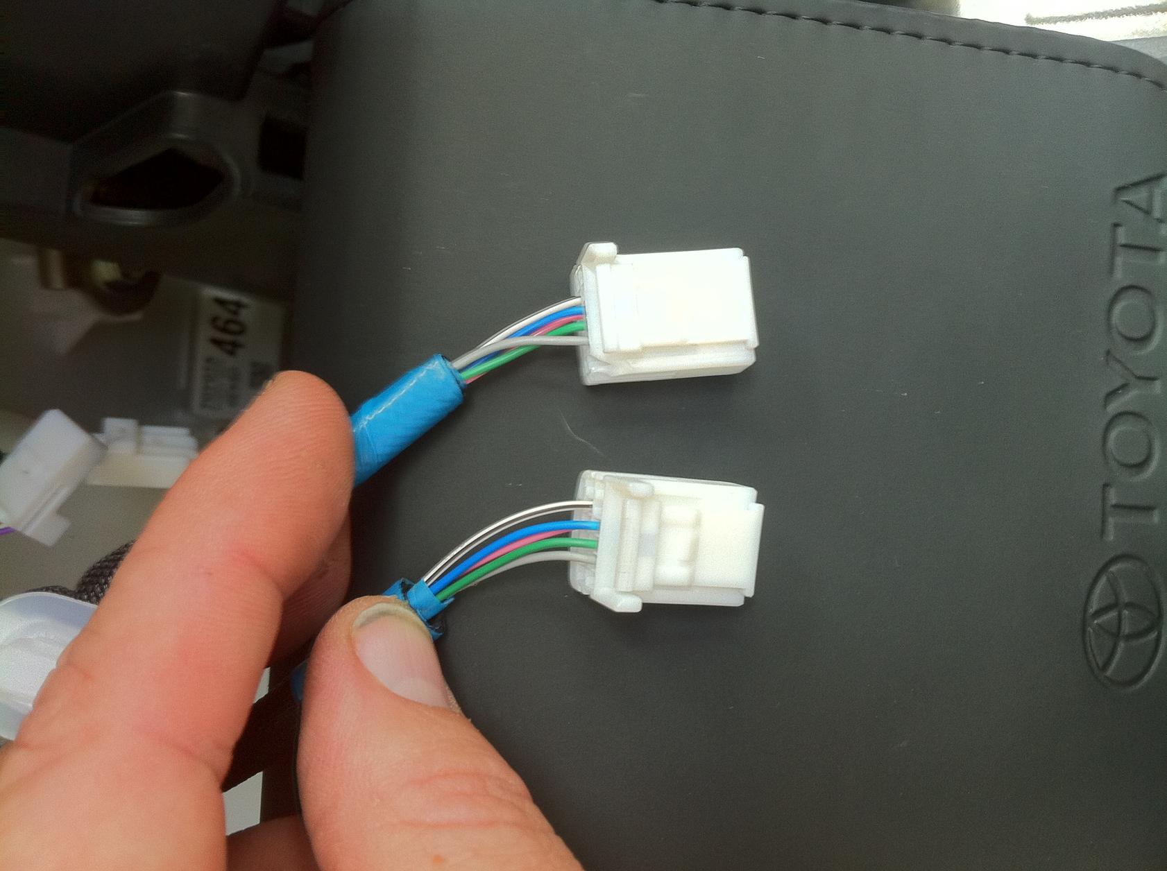

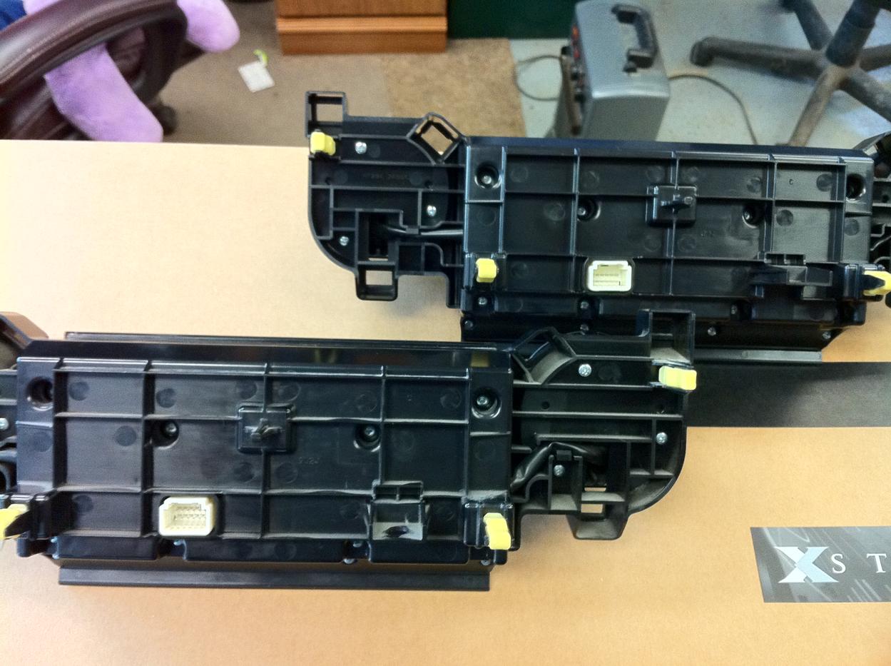

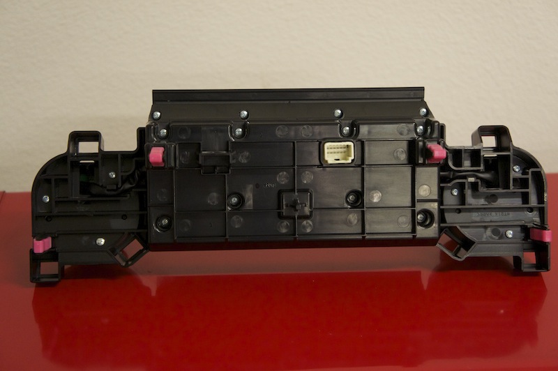

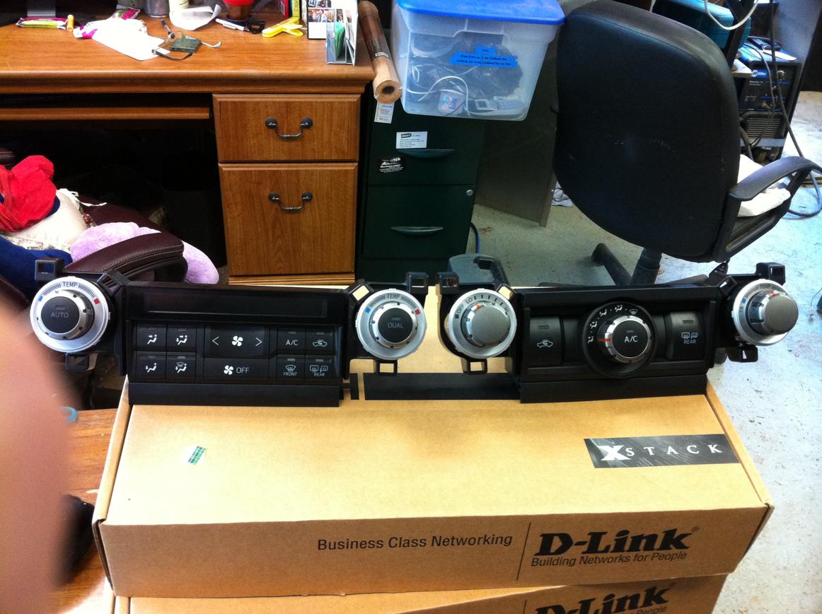

You can see from the pics below that the 2 control units are pretty much identical. The internal wiring on the T4R is also identical.
When I got the control head from the wrecking yard, I also got the pigtail with it, just by luck. Whoever removed the head unit had just clipped it from the vehicle and left it attached. But it enabled me to verify the colors and positions of the cable.
The colors on both wiring harness pigtails are pink, B & W, gray, green and blue.

Just noticed!
Wow, I guess I need some practice with photo sizing, I'll get it better next time.
But in the pic of the 2 pigtails, the top one is attached to the TE. The bottom is clipped from the yard. The top one has a broken wing! Look close you'll see the difference in the 2. I went back and looked at my TE and sure enough the good one is broken off on that little corner. Not sure what happened, it doesn't seem to effect anything, I put everything back together and it seems to be working fine.

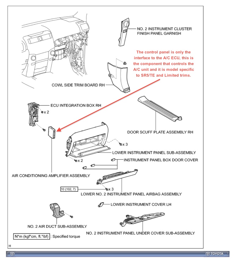

Just swapping the control assembly definitely does not work.
This could be cost prohibitive for some, just a quick search on the control assembly comes up with $700-$800 price range just for the control Assembly.

I'm using the FSM provided by nashman. Here's a screen cap....
