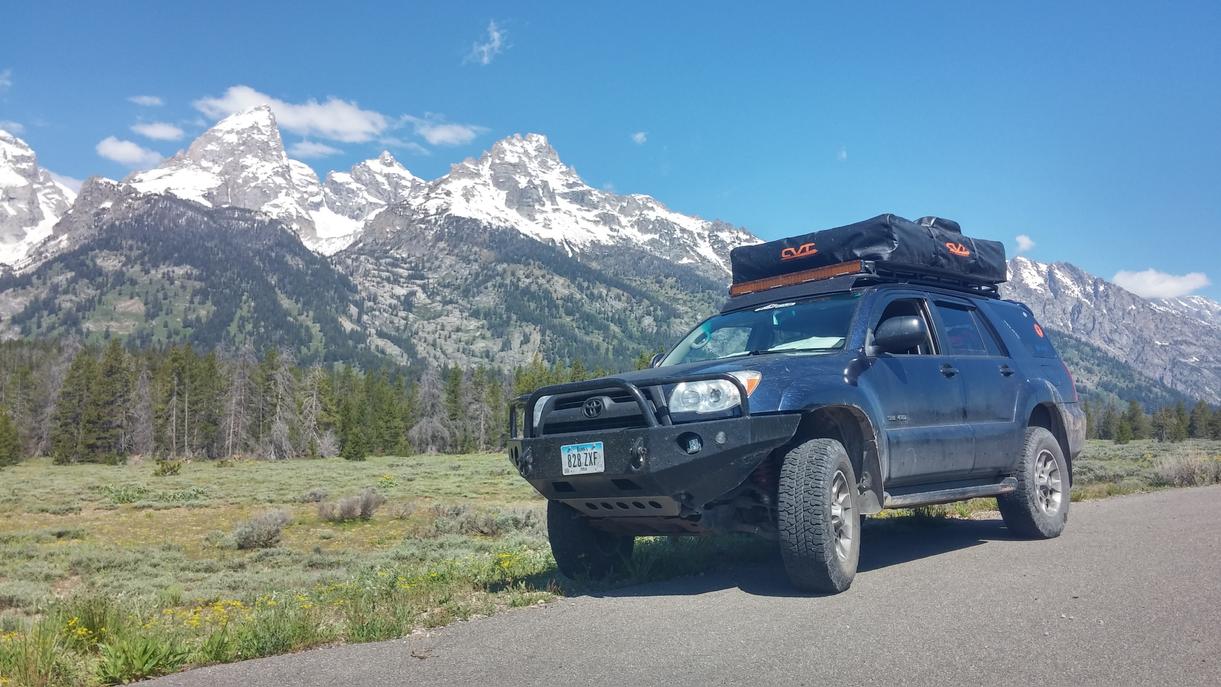

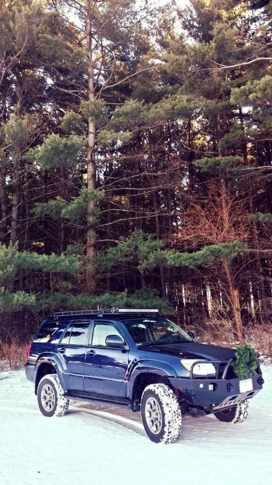

Here is a 265/70 pic

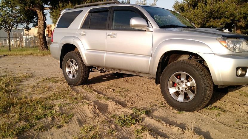

255/75/17 without lift
IMG_20150824_104517.jpg~original
255/75/17 after lift
170.jpg~original
255/75/17 after lift with 1.25" spidertrax spacers.
Cleghorn%20047.jpg~original
Honestly the 1.25" doesn't push it out very far and I think the stance actually looks better with them. Also fixed my rear remote reservoir rubbing issue. I did have to push the fender liners in the front forward, and I still need to trim something else because I still have some rub. Without the 1.25" spacer, I had a ton of rub on the fender liners and the occasional body mount rub.

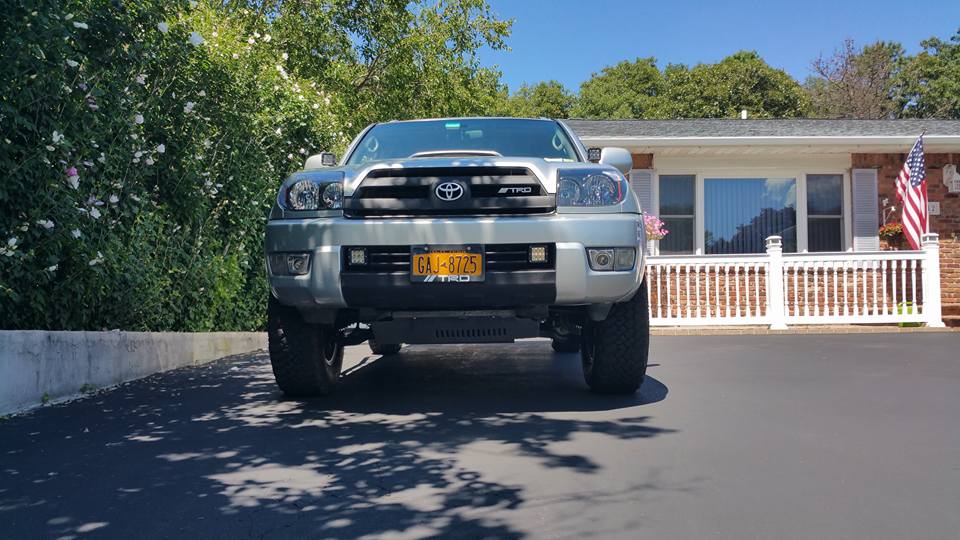

Here you go. OME Low Lift and 255/75/17 no spacers.

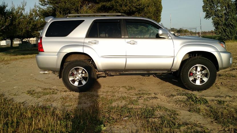

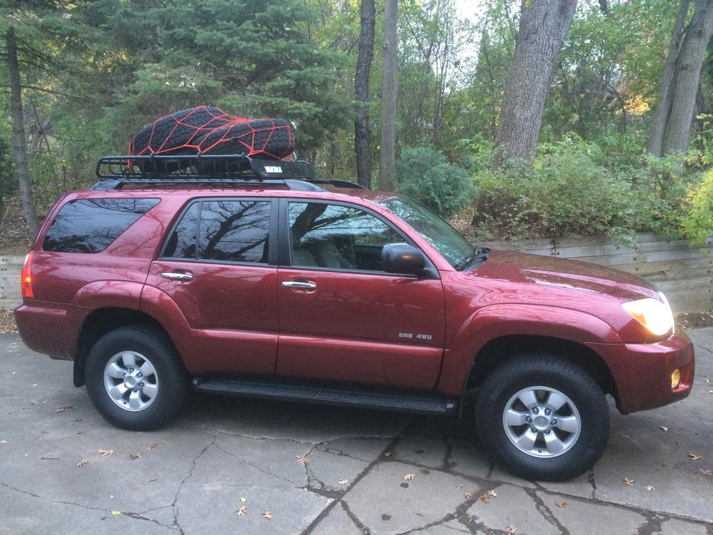

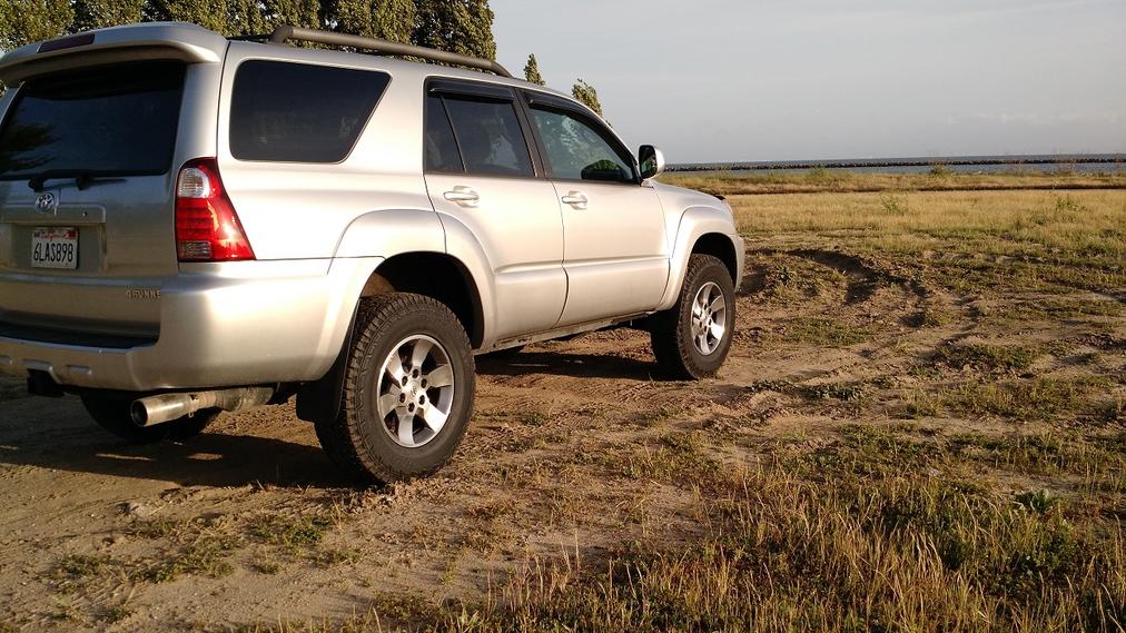

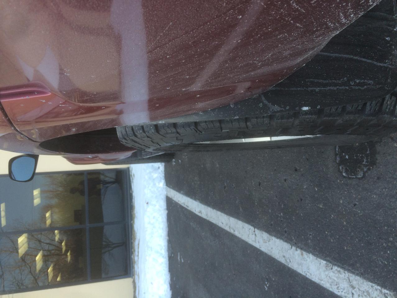

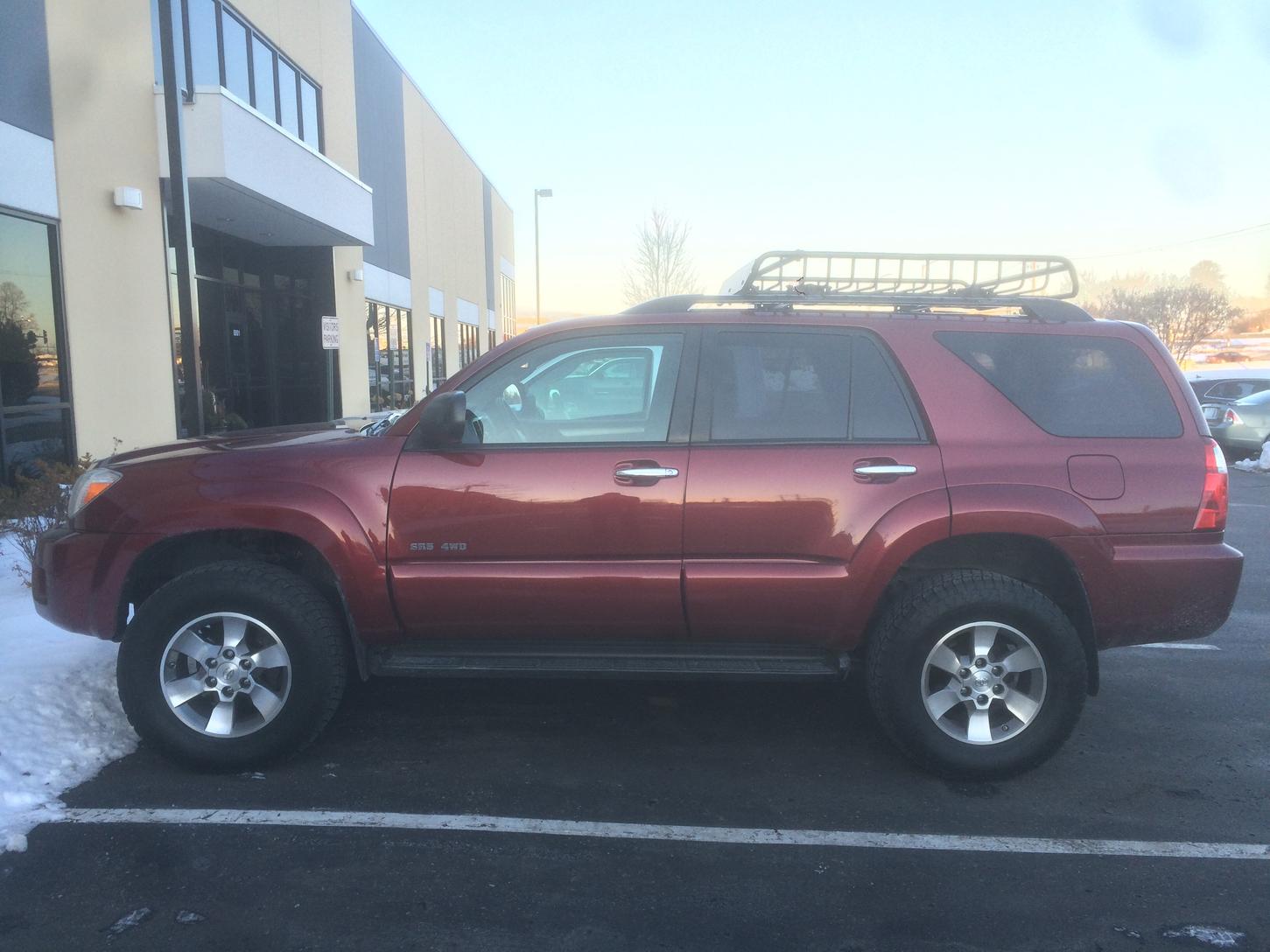

Picture 1: Flower wheels. Lifted 2.5" with Bilsteins -- no spacers. These are 265/70R16s
Picture 2: 5th Gen Wheels. Same lift -- spidertrax. These are 265/70R17s
Picture 3: Profile of tires from the side. They match up pretty darn well. Very highly recommended.

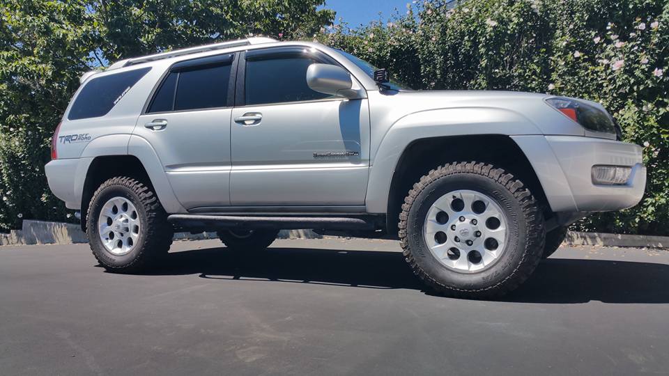

255/75/17 No spacers

Those wheels are off of a 2012 sr5, and I have 1.25" spidertrax all around yes. I'm super happy with the setup -- get on it. :)
