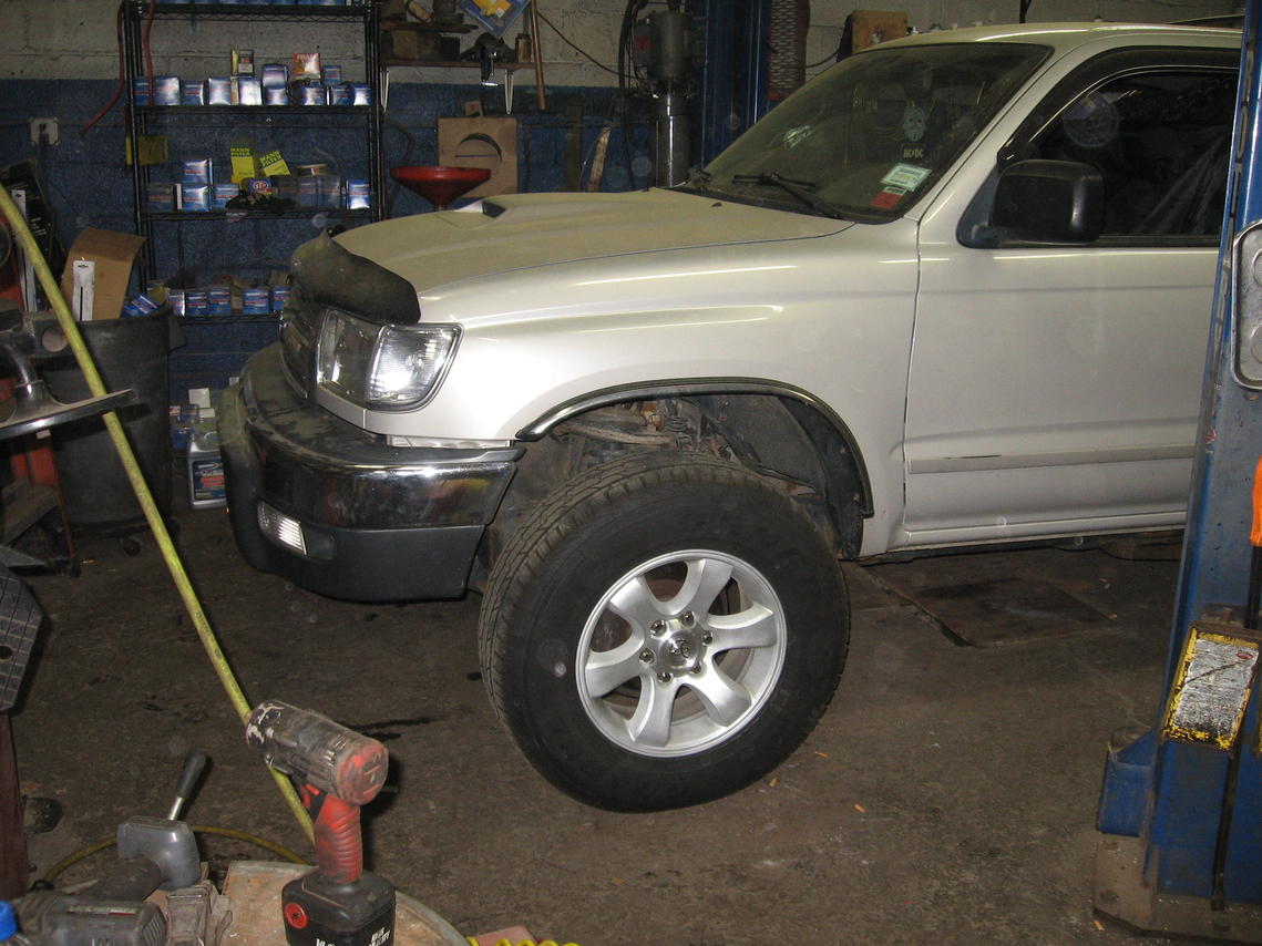

Hey, requesting pictures of a stock 4runner with a 1 inch body lift.
I have 32s right now, and won't be getting my suspension lift for a little while, just wondering if anyone has done it, what it looks like.

You'll have a 1" gap between the front bumper & the body. Some people live with it, I hate it. The rear bumper goes up with the body but if you have a trailer hitch it stays low with the frame. This is the only pic I have of my body lift before I put the suspension lift on. I have a Shrockworks front bumper on order to take care of the 1" gap in the front. There is a write up thread here to move the stock bumper up 1".
