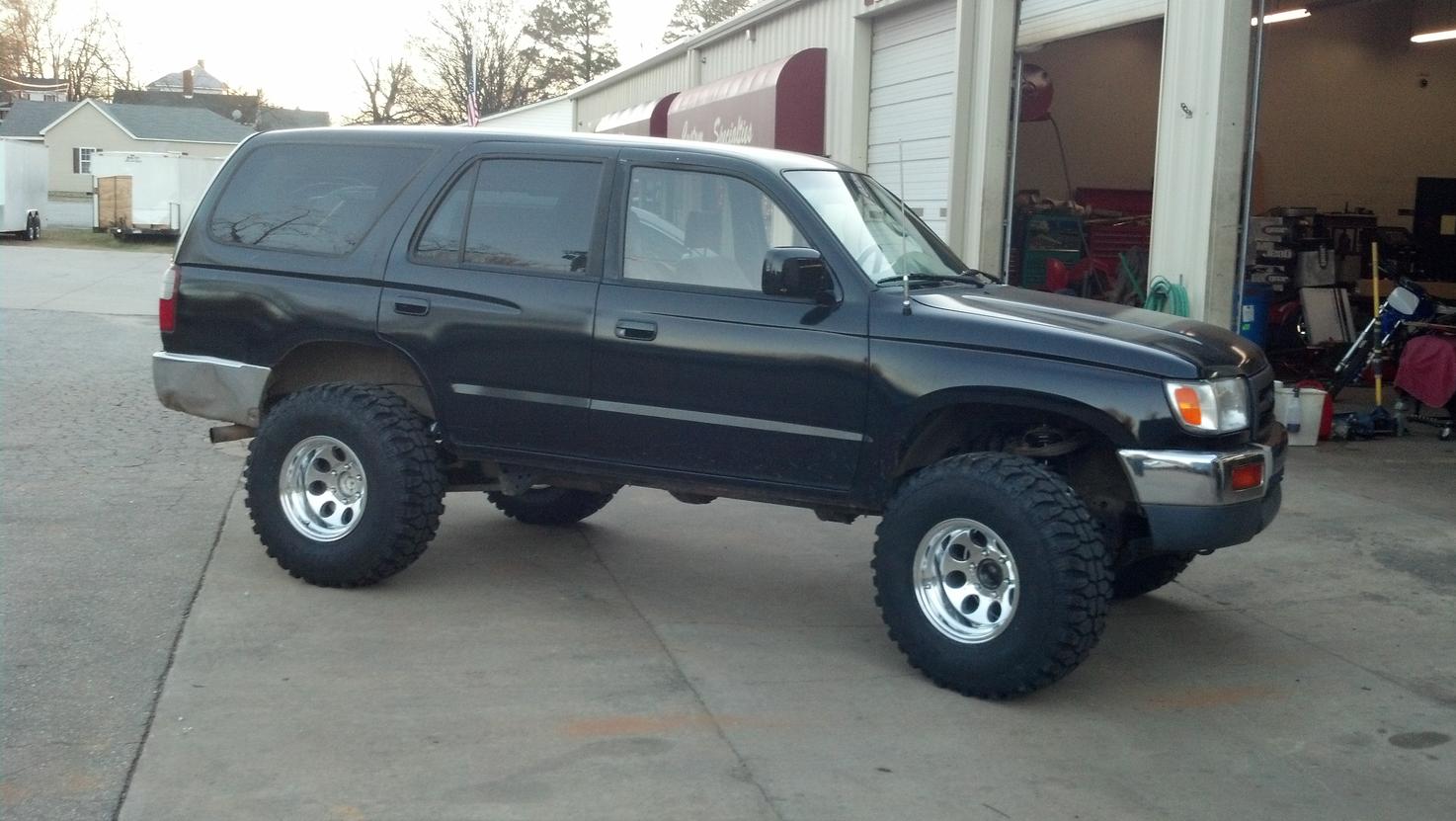

15" wheels clear fine. Tundra springs/5100s in the front and superflexes/bilsteins in the rear with 1.5" body lift = 33/12.50-15s. This is the day I had the tires and wheels put on, the suspension lift was on but not the body lift. I had the same size on my Taco and for me, it's a great all around size. Sorry the pic is so big, I don't upload very often.

15" rims wont clear the limited models because they had a larger caliper. At least thats what ive experienced with my limited model.
They "can" fit your 4runner. Sometimes you have to use a piece of metal that is fabricated to be placed in between your tire and the rotor. They are called spacers and will move your tire further outside of the vehicle to allow the proper clearance for the caliper. Make any sense?
Yea, I have the SR5 model that came with 15" wheels, so that is prob why they swapped over with no probs. Plus my wheels have a pretty decent offset.
