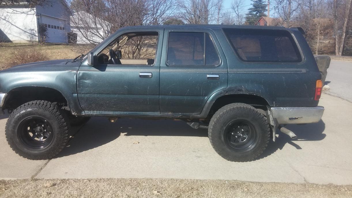

Bought 95 4runner 3.0L. No idea of its history but running pretty decent other MPG. Tell me what youd check/do first. Tune-up? All fluids? I really dont know logical place to start. And part 2, any good quality great price parts places anyone can recommend? Thanks a bunch for any help and suggestions.

Then dammit go somewhere. Move West and you won't have to deal with stuff like that Peek-A-Boo bumper

My first response ever, before you there were none. Thanks a great deal, exactly what I was looking for. And a couple bonuses too. Ive had a 85 4wd 22r, 98 Camry and a 94 extended cab 4wd 22re so Im somewhat familiar with those truck motors (screw that Camry, couldnt work on it much), but when I jumped up to the 3.0 nothing resembles nothing lol. Had the dreaded front end roar on 4runner, replaaced passenger side axle today. Problem fixed. Went ahead and changed diferential fluid in front end. Its finally 67 degrees here in western Kentucky, Im giving it a bath. I appreciate the checklist and tips. Oh, yes, I put in a decent system as not one of the factory speakers worked (odd). Didnt spend great deal on it, JVC deck, Phoenix Gold 4" front and back top and 6x9s in boxes in rear. Put a 100 dollar Dual 400 watt amp to it and im jammin a little. Lol lol, first two things I did were stereo and put wheels and tires on it. Got my priorities right!
