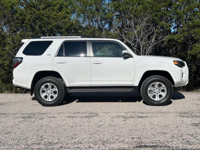

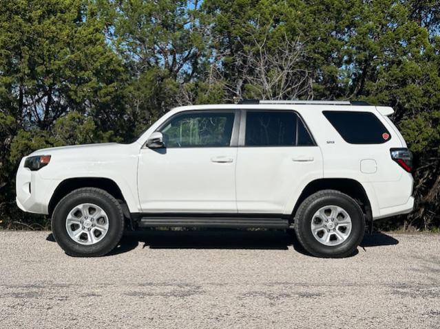

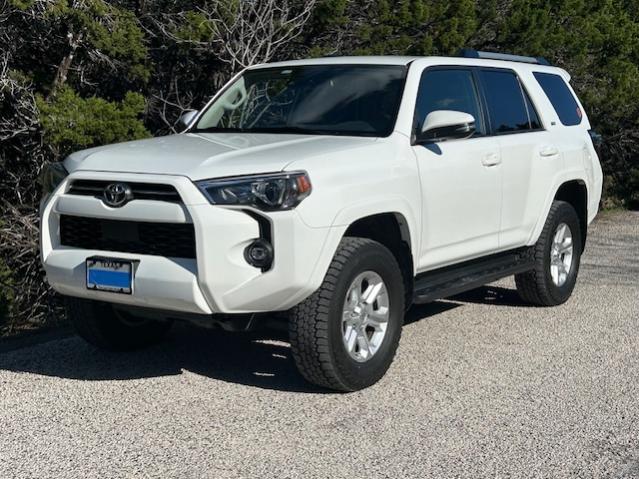

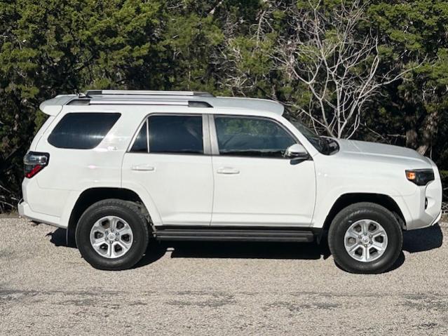

Hello all. Quite some time ago I inquired here about doing a minor front lift on my 2022 4RUNNER SR5 Premium 4WD, mainly for appearance purposes. Thanks again to all who replied at that time with your advice.
I elected to go the route of having my local off road shop install a pair of Bilstein 5100 Series adjustable front shocks. I asked them to raise the front enough to eliminate most of the front rake, but to leave a hint of front rake.
I am extremely happy with the results, both with the ride, and with the change in appearance. My shop took care of getting a front end alignment done after they installed the Bilsteins. Vehicle drives great.
I shot a few pics here to share, especially for anyone who is considering getting this same work done. I don't think you will be disappointed if you go through with this mod.
Here is my pride and joy, pics shot recently, with the vehicle odometer reading 34,107 miles.
