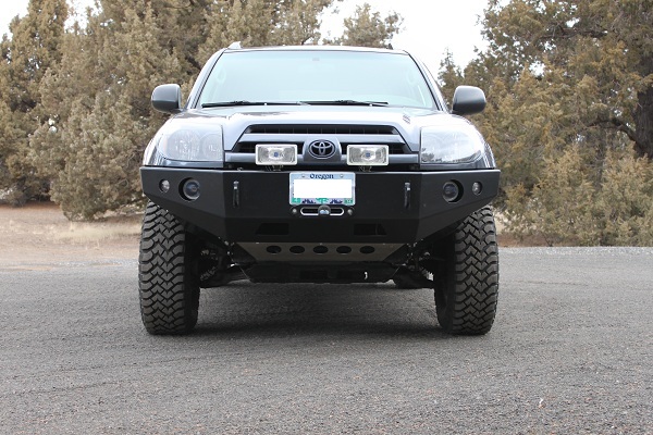

They will never line up perfectly. The top of the bumpers is largely flat, and if you look at the 4runner from the front under the lights sweeps upward as it nears the edge of the vehicle.
The way around it is to trim the top of the bumper so that the most inward part of the molding under the light tucks down behind the bumper.
Also, you are often seeing pictures of the trucks when they are not on a flat surface...the fram twist is huge on these trucks and you will notice a gap open on one side and shorten on the other.
You can make it work if you want to put the effort into it.
Here is a pic of the cbi: notice it is on perfectly straight but the gap increases as you approach the outside of the vehicle.
http://www.cbioffroadfab.com/store/images/115Web1.jpg
Yeah, there is definitely somewhat of a curve (or an angle) on the body at that point and it's just easier to not follow that curve while building a bumper.
Not that it makes a difference on how it fits against the body, but that's the previous version of the CBI bumper... the new one looks a lot cleaner at the lower mounting area.
With regard to fitment, and this applies to both my Demello front and CBI rear bumpers, they are not perfect alignment on the sides. But the uneven gaps are only noticeable when you look for 'em.

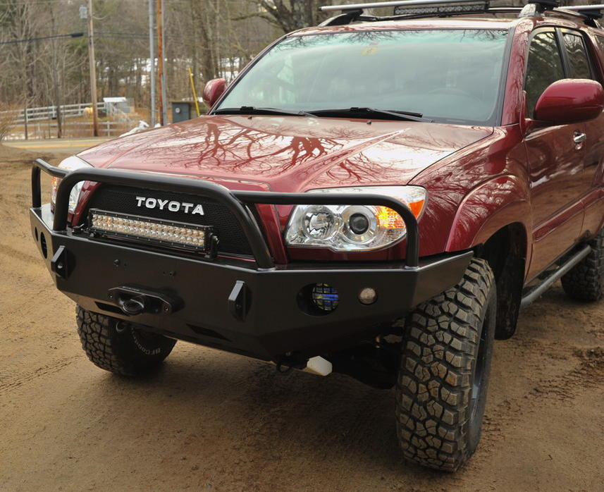

... shrockworks: strong, good quality, requires opening the hood to access the winch controls ...

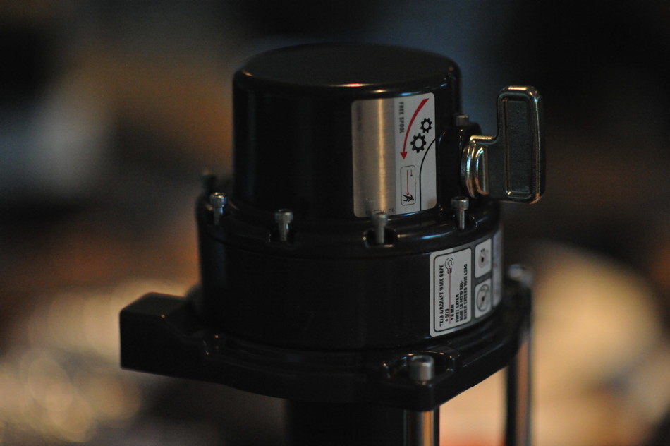

Nah, I can change the clutch setting (recover or spool) by reaching through a hole in the bumper placed right near the control for most winches. (I did have to rotate the clutch cover so the control pointed down; took 5 minutes)

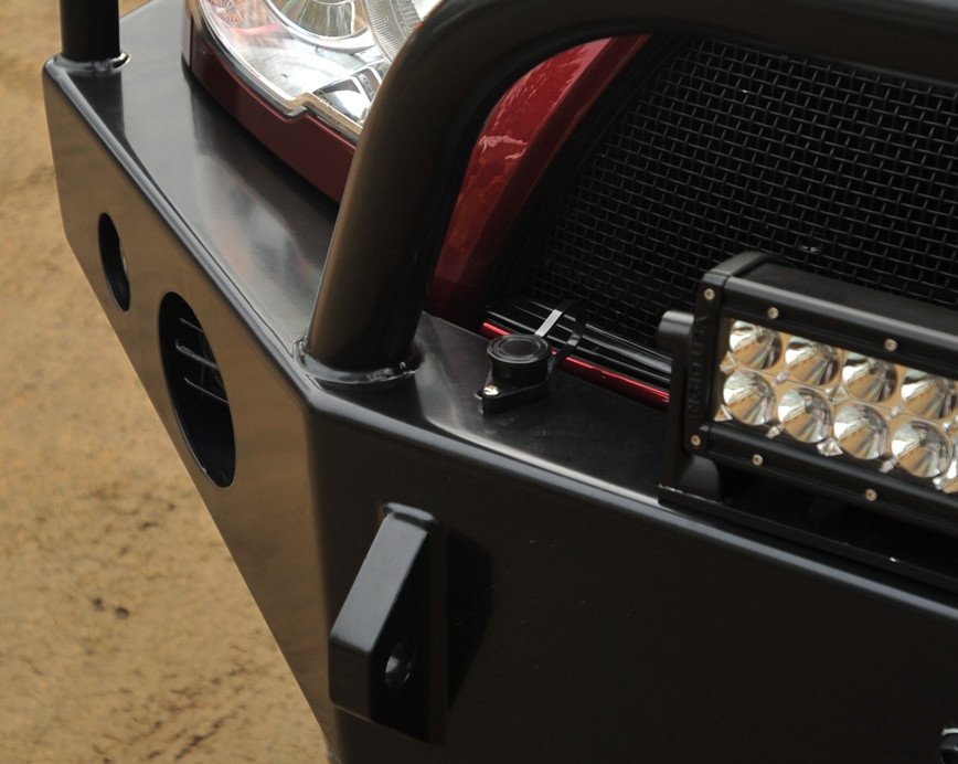

I actually control the winch operation by plugging the winch controller into a socket built into the top of the bumper; no mess, no fuss. I never have to open the hood.
The Shrockworks may extend out a bit farther (not sure that's accurate) but it is cut so high that I have not experienced any limitation as far as approach angle... time will tell.
The recovery points on the Shrockworks are well done. They pass right through the plate and are welded on both the front and back sides. The recovery points on my rear bumper are face welded only.
I think if I had it to do over, I would explore the feasibility of the Shrockworks in aluminum.... that heavy duty construction comes with a weight penalty.
