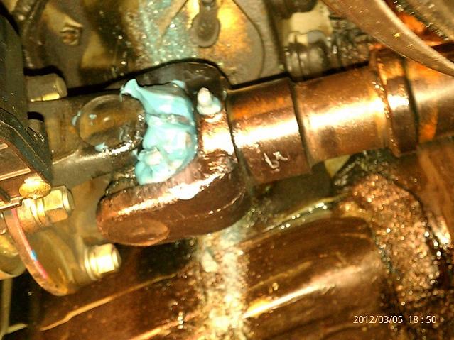

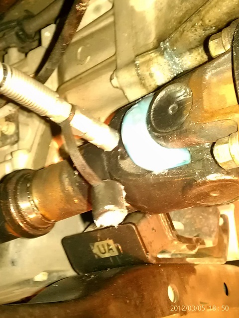

I have greased the zerks about 4 times since I got it in Januaray (new to me 04 4runner 4x4 special edition 81Kmiles) The clunk returned 1500 miles after greasing. Using nothing but Castrol synthetic multipurpose. I pumped it the first few times until I noticed slight movement. Since the clunk returned so soon (expected at a bare minimum 3000 miles) I searched this great site again and found that I'm supposed to pump until it seeps out a bit. The U joints are well greased so I attacked the slip yokes....welll the rear slip yoke started seeping so I stopped as you can see in the top pic, the front never seeped but it moved a lot....then did what you see in bottom pic. Is this okay...or tomorrow will I feel the clunk yet again. They both seeped grease out the opposite end I was attempting, but the front slip never seeped.... Bad Zerks? Please help. Thanks in Advance.

So....does this look normal for greasing the slip yokes? Will some spill out this end as well or is something wrong???
When you start using a Moly grease, you will want to push out as much of the grease that is in there now. You will have big gobs oozing out. This is normal. Yes some should come out, it's pushing out the old grease. If greas isn't coming out, you haven't greased enough.
You may notice that the greasing causes the slip yoke to extend. This is fine. When you compress (from driving and suspension movement) the suspension, the slip yoke will slip in and out (More grease will be pushed out again).
Something is not right. You should be seeing grease coming from where the arrow is pointing below.
The grease in your picture looks like it is from greasing the u joint zerk not the slip yoke zerk.

If you pack a ****load of grease in there, it will start coming out of both locations (arrow shown in pic above and the end towards the u-joint).
Next time, after using so much grease, it may be a good idea to remove the zerk fitting, jump up and down on the rear bumper a few times to bounce the suspensions, then clean up the grease and screw the zerk back in. That way the driveshaft won't be trying to force grease out of places it shouldn't.

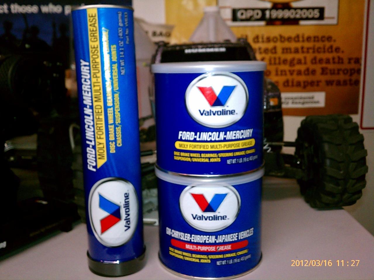

Ok, didn't get around to pulling the driveshafts yet. Grabbed a second grease gun and grease. Read too much and don't know which one to use. I read moly is great and then moly is smoke and mirrors. Read GM spec grease is the only grease that meets the manuf spec. Read a dealership mechanic ran next door to Ford and picked up some grease and the clunk was gone forever. I read that the tubes mixture is thinner/(read no-good) because properties have to be different for pumping? Good grief:redbrick:. So...I I'm going to pull the drive shafts and try to clean everything...what grease should I use see my options below. Please help:

^^I had all these same thoughts last weekend when I greased... Confused!!!
I think I ended up using basically what is on the bottom right (only in the tube), but like you, I'm all stressed because its not ''moly''...

I went through the whole cycle of concern about which grease, too. I view it like motor oil. Getting it done is vastly more important than what you get it done with.
FWIW, I, and many others, have used a lithium based grease with moly on both spiders and slip. No failed spiders that I know of. I'm confident non-moly grease would have worked fine, too.
