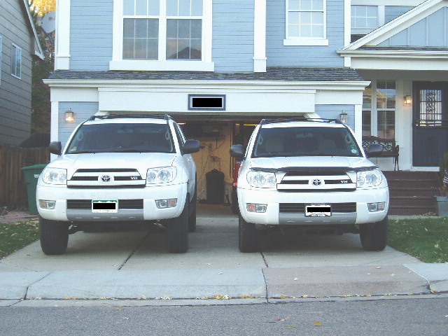

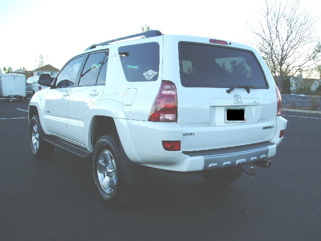

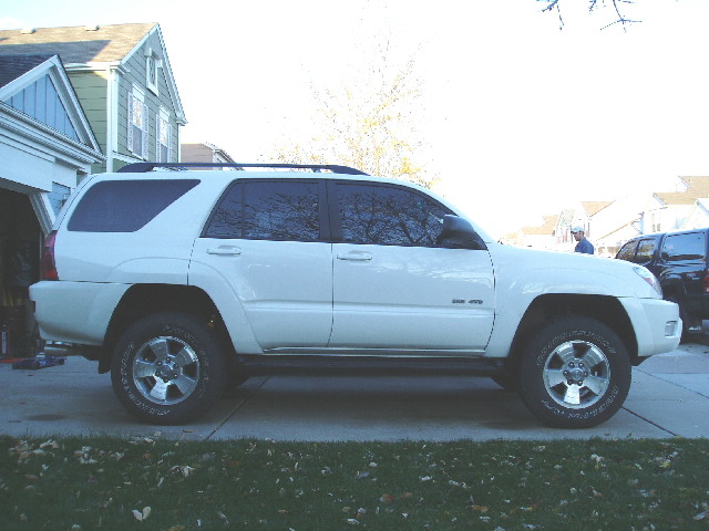

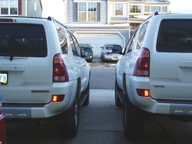

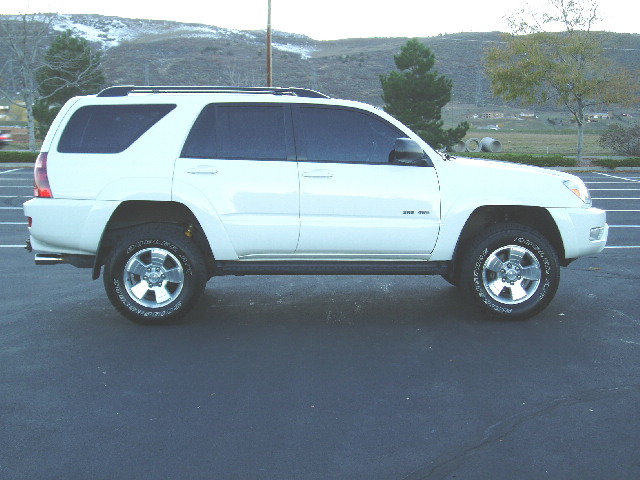

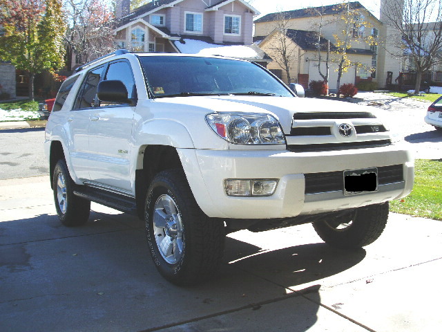

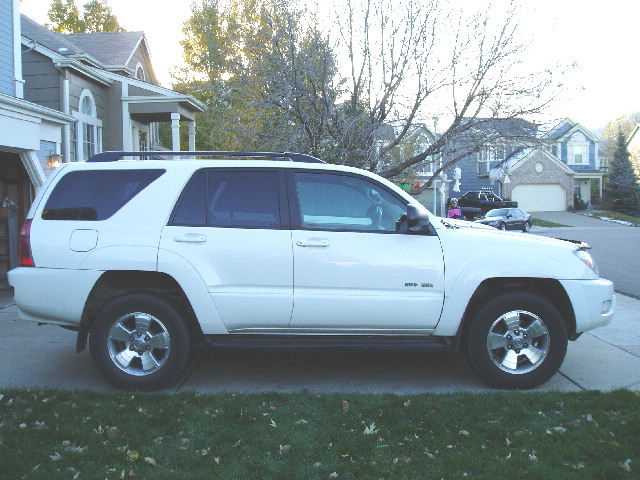

I just installed my ome lift last weekend with a few of my buds. Here is a pict of a stock 03' & an 03' with ome lift. I just wanted to thank everyone out there for all the awesome info. You all have helped me out so much with so many questions. Thanks

I have almost 90,000 miles on the 4Runner and it had original shocks. My shocks were really shot. I tow a 3000-4000 lb. trailer alot and the back shocks were really bad. Now with the new shocks and lift the vehicle rides a lot better then before. It might be just slightly stiffer now over all, but not bad at all. Now towing is a lot better. Before I would sometimes hit the bump stops when towing. Now It rides a lot better with the trailer. I have had the lift on for about 3 weeks and my over view is it was a huge upgrade. I feel the ride and handling is better with the lift then when it was stock. As for the alignment I took it to a place here in town that specializes in alignments for lifted vehicles. They did a great job. They said they were able to get it to almost exact specs. The alignment feels just like stock. the wheel is straight and on the highway drives just like normal.

Did you have to do any trimming with the Revos? What is your clearance like with the stock wheels?
Thanks!
Paul

I did not have to do any trimming at all. Also there is no rubbing with the stock wheels. If you stick with 265/70/17 with stock wheels you will have no issues. I had these tires on before the lift and there were not any issues as well.
How much has the front and rear OME "settled" now that you have more time on them? Would you recommend the trim spacers to correct for the driver/gas tank left side weight bias?
Thanks for your help!
Paul
Paul,
I did not know about the trim packer at the time I did the install of the lift. I just measured to see if there was a difference due to the gas tank and there is no difference at all. I guess that is good. The front measures out to within 1/16 on an inch difference as well as the rear, so everything has stayed even. I did not take a measurement right after the install so I dont know if there has been any settling. The ride has gotten a little softer but not much. I have put about 10,000 miles on with the lift so far and no problems. It has really been a great lift and I really do love it. Hope this helps!!!!!
