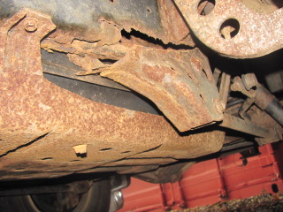

Check your frames, I thought mine was fine - surface rust only. That was until my wife came home and told me "my car feels funny going down the road." While inspecting, look what I found. This is where the drivers side lower control arm meets the frame. As you can see it has rusted to the point where it has seperated. If anyone else has this condition, or is getting close, get to your dealer and complain!

Yeah, that is a pretty common spot for severe rust. Search for other rust threads, and check out the link in my sig. Lots of us have dealt with rust.

This is on a 1997 4Runner that has lived it's life in Connecticut. It has 150,000 on it. Toyota has already purchased my 1997 Tacoma from me because the frame was shot, and I'm on my 2nd recall for rust on my 2000 Tundra. As you can tell I have been a toyota guy for some time. I think it may be time for a loyalty shift. My 66 Impala doesn't have any rust!

I had a similar issue with my 99 earlier this year. The local Toyota dealer said there was nothing they could do. Same news from Toyota corporate. I had it repaired by a local welder and it's held up so far.
I recommend filing a report with Toyota and the NHTSA. https://www-odi.nhtsa.dot.gov/ivoq/ There are many similar reports of frame corrosion in the NHTSA database. If there are enough complaints maybe Toyota will do something about it like with the Tacoma/Tundra voluntary buyback program.

My frame has some rust and my back axle as well, but thankfully no major 'rot' and it looks like I'll be able to take care of it with some TLC, a wire brush and some POR15 or similar before winter sets in. It's constant vigilance against rust up here and it spreads like a disease. My back quarter panel under the driver side bumper end however is another thing altogether and has rotted right through. Once I manage to get the bumper off (yes, rusted bolts as well) I'll post some pics when I repair it (if I can).
Razor - you should pull that rear skid plate off and check out the frame underneath and while you're at it, get all the rust off the plate and repaint it, makes a huge difference. I'm planning to do it next weekend. I just installed a new catback pipe and muffler last week and man, there's a whole load of rust gone from my undercarriage just by doing that!
I hosed my frame out two weeks ago, and had the Rust Check blast done last week. I know that area of the frame is a problem area because if I feel inside the frame with a finger I can feel silt build up, whereas other areas are clean and feel smooth. For good measure I sprayed more rust oil in there. I'd rather have that pooling than salt.

The other parts of the frame are fine. I would have thought some wire brushing and preventative primer would have taken care of it. I heard somewhere that these things are rusting from the inside out. Not an easy thing to fix.
