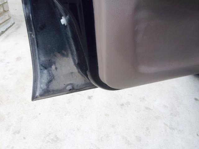

Picture of 4Runner Rust- Check your frames
During winter, for you fellas and ladies living on the east coast or whereever road salt is used. You can minimize this by simply going to your car wash and blasting off that salt underneath.

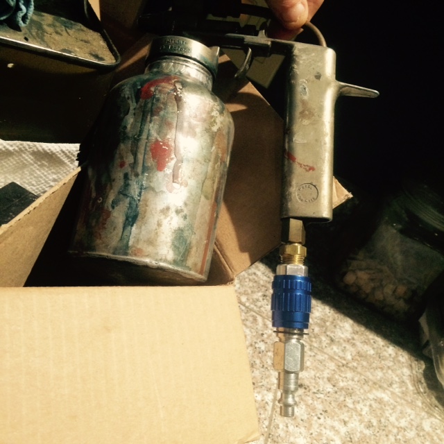

Fluid film. Get a gallon and the pro gun.

Any kinda thick oil will prevent rust. So yes, wd40 is good, fluid film is better. Old engine oil.
I recommend spraying top of shock rocker, all along rocker panels. Inside the rocker panels, and whole under car. Rear fender wells.
Too late now, but......Preventive maintenance goes a long way, hose inside of frame out. Spray oil, wd-40, fluid film, or whatever inside frame, outside, and all over the whole under carriage, inside rockers, doors, fenders, etc. I've been painting my frame and floor pans with Chassis Saver from Monstaliner, over time I'll get everything like rear diff and other stuff. Salt Life.

Check your frames, I thought mine was fine - surface rust only. That was until my wife came home and told me "my car feels funny going down the road." While inspecting, look what I found. This is where the drivers side lower control arm meets the frame. As you can see it has rusted to the point where it has seperated. If anyone else has this condition, or is getting close, get to your dealer and complain!
